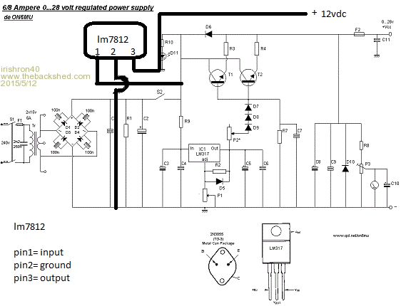

hi I am buil;ding a power supply from this diagram
http://electronics-diy.com/power-supply-lm317-2n3055-0-28v-6-8a.php
can I change the lm317 for a lm338 and what would be the approx amps in conjuction with two tip3055 transistors?
and C10 is a 1uF/16v. would it be ok to use a 1uF/50v?
i have 2 TIP3055 transistors, I believe they are the same as the 2n3055.

Pete Locke
Joined: 26/06/2013
Posts: 186
Posted: 08:56pm 03 May 2015
Pretty much, yes. The 338 is a 5amp reg, the 317 is only 1.5amp. Seems a wast of the extra power available from the 338 but would be fine. The TIP3055 is the same spec wise as the 2N3055, just a different case. No problem using a 50v cap in place of a 16v one. Good luck with the project.
Pete'.

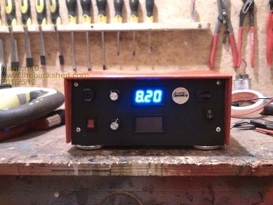

Posted: 03:12pm 11 May 2015
just finished building my casing and fitted all switches , fuse holders and meters.just have still to fit the output connectors
I just wonder, I like a constant separate 12volt supply
could i connect a lm7812 the way I have drawing it ?
thx. ron
Edited by irishron40 2015-05-13
Posted: 04:40pm 11 May 2015
Yes, but dont forget to add some capacitors to its output. Voltage regulators need caps on both the input and output or they wont work correctly.

Posted: 07:27pm 11 May 2015
what type of uf caps would i need for output. or is that not important glenn?
thx
ron
Posted: 08:48pm 11 May 2015
I would use a 10uF 25v electrolytic, plus a 0.1uF greencap.

irishron40
Joined: 22/09/2014
Location: Ireland
Posts: 254
Posted: 10:45pm 11 May 2015
just thinking glenn, am I not right in thinking that I should try and keep capacitor voltage rating as close as possible to the output, so would a 16v not be better then a 25v? forgive me for questioning your expertice, but I was just thinking as the 7812 wont give out more then 12v .
ron
Downwind
Joined: 09/09/2009
Posts: 2333
Posted: 04:10am 12 May 2015
A capacitor voltage rating higher than the output voltage of the 7812 will make no difference to operation of the capacitor, in actual fact its better to have a higher voltage rated cap, the only down side is they are normally larger in size and cost a fraction more.
The voltage of a cap is not important as long as it is rated higher than the working voltage, it is the uF rating of the cap that is the important part.
Pete.

Posted: 02:16pm 12 May 2015
Yeah Pete's spot on, you can use a cap rated at any voltage higher than its likely to see. The cost and size of the cap will increase along with its rated voltage.
For 12v circuits I generally use 16v caps, but in your case, its a power supply and there are unknowns. If you were to accidentally connect a 24v battery to its output, or the output was introducing spikes, then a 25v cap give a better safety margin.
If a cap experiences reverse or higher voltages, it can go pop and make a mess with bits of paper and aluminium going everywhere, its a bugger to clean up.
