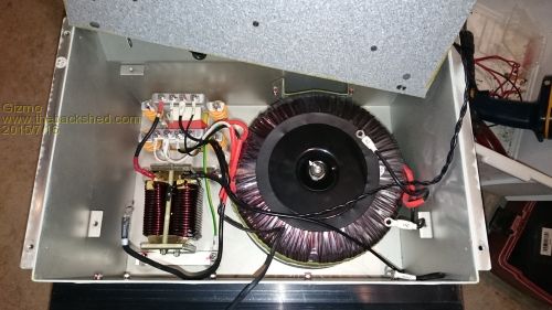

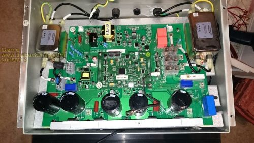

Locally I could not find a Inspire 1.5kw, but I did find a Inspire 2.5kw model in Brisbane for $125. I had to pick up some 2nd hand solar panels from the Gold Coast anyway, so made a day trip, 700km, $70 fuel and I'm the owner of a Inspire 2.5kw, plus 8 190 watt panels ( another story ).

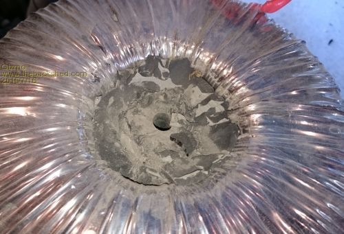

Next day I pulled the Inspire apart. Pretty impressed with the build quality of these. The toroidal is massive, weighs about 25kg and is 220mm in diameter. The circuit board has lots of goodies too.

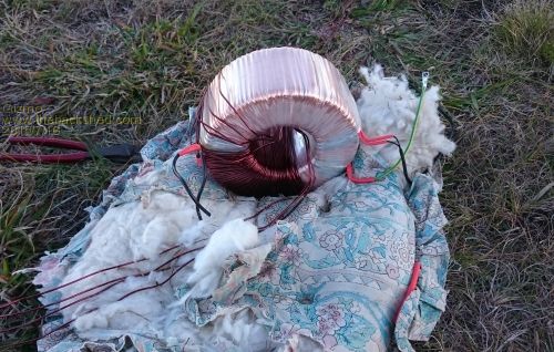

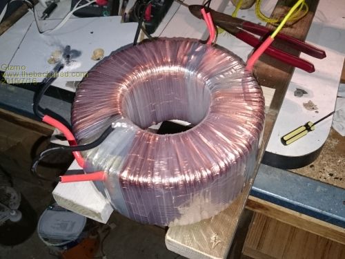

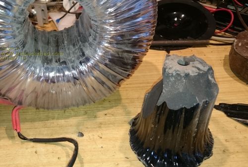

Next I needed to remove the core, and this was different to the 1.5kw model transformer. My core was filled with some sort of epoxy, so I had to gently chip away at it for an hour until I could carefully tap out the core.

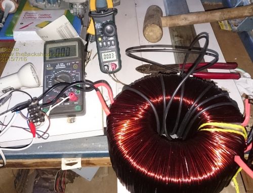

Then I removed the outer tape layer to expose the outside winding, and set it up to do some tests as Oztules suggested.

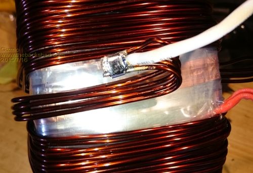

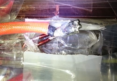

After a few tests and "ah-ha" moments, I discovered, that, unlike the 1.5kw model Oztules used, the 2.5kw model transformer has the 240 winding on the inside. And since its a higher capacity inverter, the 240v winding is 2 in hand 2mm copper. Boy will that save me a lot of work! So all I need to do is remove the outside winding, and wind a new primary.
The primary was 4 in hand 2mm copper, so was going to be a bugger to unwind without damaging the copper. I couldnt use the method Oztules used, so I ended up propping the transformer up in the middle of the yard and unraveled the 4 wires by grabbing the next loop, and taking it for a walk until the end of the wires passed through the core. Towards the end the wires were getting over 30 meters, so I did a lot of walking that day. Once done, I rolled the wire onto a spare spool for a later project.
Below is a picture of the 240 winding showing its 2 in hand. This was buried under many layers of tape, but I needed to see how it was wound so did a little explorative surgery.

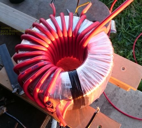

And the core ready for a new primary. The hole in the middel is now 90mm diameter.
Next post I'll show the new primary in place. The primary wire is 25mm square, 9mm diameter with insulation.

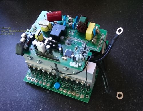

This one is using the toroidal as above, and replacement boards for the cheap Power Jack inverters. So basically, I've ordered a MOSFET and controller board to suit a 8kW pure sinewave Power Jack inverter, and will fit those in the Inspire case, along with the rewound transformer.

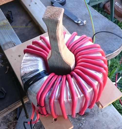

Posted: 12:53pm 11 Aug 2015
Some updates.
The Power Jack boards arrived after a few weeks. Looks like they build the boards as orders come in, but once despatched it arrived in a couple of days.

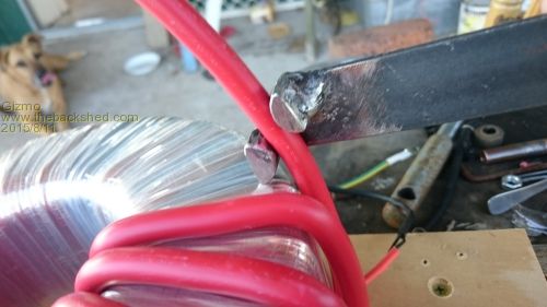

No idea how to connect it up, so I've been reading through the W7 inverter thread over at Energy Matters forum for clues, but I think I will play it safe and wait for Oztules to post part two of his build on the Fieldlines forum.

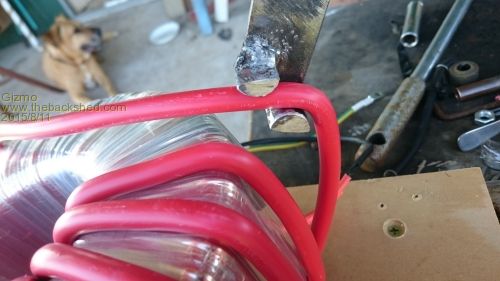

Started on the transformer. Winding the 25mm wire is tough work, but I made a bending tool and a timber wedge tool to help bend the wire for a neater finish and shorter wire length.
Next I'll do some tests and post how it goes.

Posted: 02:21am 12 Aug 2015
Hi Bob
Yeah some photo's would be handy. There is a long row of pins that I guess are for indicator LED's, plus a couple of other connectors. But I would hate to take a guess and damage the board, cant afford another one.
Yes to the welding wire. I read you can use welding wire a few hours after I bought the PVC coated electrical wire . So long as the welding wire has the square mm rating, it doesn't matter if its made of finer strands of wire. The welding wire usually has two layers of insulation, you can take off the outer, reduces the diameter and makes it even easier to wind.
I ended up with 25 turns on the first layer, then added a further 7 turns, which made it a bit messy. I connected up the transformer secondary in series with a 60watt bulb and powered it up. The secondary was sitting at 220vac, and the primary had 35v. If I do the math for 230vac, the primary would be 36.5vac. After reading the forum threads on Fieldlines and Energy Matters, I think I should take off 3 turns to get that voltage closer to 33vac. There is a lot of info in the Energy Matter thread about this, but at over 120 pages, it takes many hours to find the useful bits and I'm still only a third of the way through it
