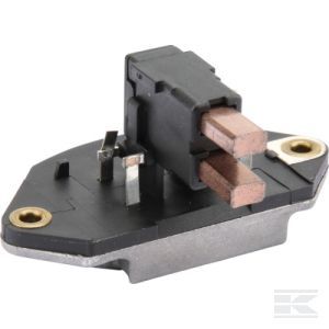

I have got a feeling that the brushes and controller are in one module on those fiats. it pays to check that the power wire onto the module is getting power when the key is on and the earth (probably via one of the bolts) is not crusty before you go to town on the brushes.

This tractor has an external voltage regulator and I also have a circuit diagram. With the switch to ON, I checked if the coils get excited from the regulator and it measures 11.8V after scratching off layers of oxide, with the battery at idle and (after standing for some time) reading 12.3V.
Does this mean the regulator works as there is current going into the coils?
The forum established that the alternator does not charge as I am only reading 12.7 while running, which is the battery voltage after charging but not the alternator's voltage, which should be about 14.7.

Thanks yahoo2. Acetone is also in the nail polish remover for those without guns! Now I think I may have solved one problem to find another:
Cleaned the oxide off the fuse hanging off the external regulator, managed to start the tractor and after warming up measured the voltage repeatedly and at 800 RPM it had crept up to 13.4V.
Later increased the RPM to 1600 and found the voltage had crept up to 15.32V! Must assume the brushes,diodes and the alternator are OK but the regulator has gone West? The battery had not been charged for nine weeks and I am happy that I just managed to start the tractor again. Had I not forgotten the extension lead, then I would obviously charged the battery BEFORE starting.
Must I assume the regulator is dead or would a nearly "empty" battery lead to serious over voltage, as 14.7V should be the max.?

Good! that is progress. the voltage will depend on where you are measuring it and the quality of the wire and connections between those points.
So it might be 15.3 at the alternator and 14.8 or much less at the external regulator. the regulator can only adjust the voltage that it can see at its own terminal. I am doubtful that if you measured the voltage directly on top of the positive battery terminal (not the cable clamp) it would be that high.
it does not necessarily mean the regulator is shot it may just have poor connections on the positive side between it and the alternator or even the negative connections on the regulator might be not making good contact and the earth voltage is not at 0 volts and is floating up.
If you are measuring 15.3 everywhere then its a problem and the regulator is out of adjustment or stuffed or not seeing a good earth.

Everything Yahoo said..... and is this a solid state regulator or a two or three coil type.
If the coil type, then you may well get it to the correct voltage by changing the tension on the return springs ( it will be obvious when you pull the cover off)
They are fairly flimsy, so be careful, but they change the charge characteristics completly.
If you use the tractor for long periods, then 15.3 is high, if you use it for short durations, I would not be over concerned, just check the water occasionally.
But particularly check as Yahoo mentioned, the change in behavior to change in load.
If it regulates, but at the wrong voltage, then spring tension will fix it, if it is oblivious to load change and just runs wild, then it has a problem with crap connection or failure of the resistors on the back of the reg.
If it is solid state, then a new one or build one is in order.
At least the alt works
