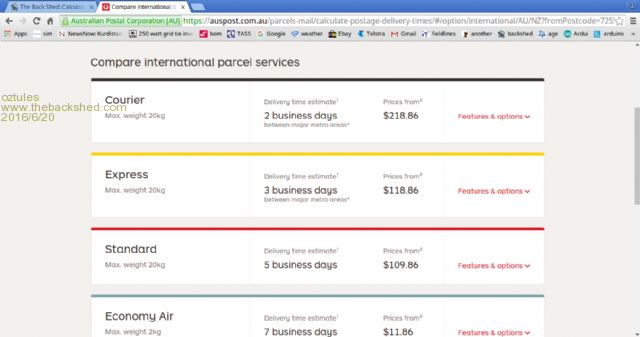

Check out Frackers on anotherpower, he has found torroid material over there, or find some other way out.
Freight from aus to nz is pretty reasonable, at about 110 dollars..for 20kg or so.
There must be better options for you than that you have found so far.

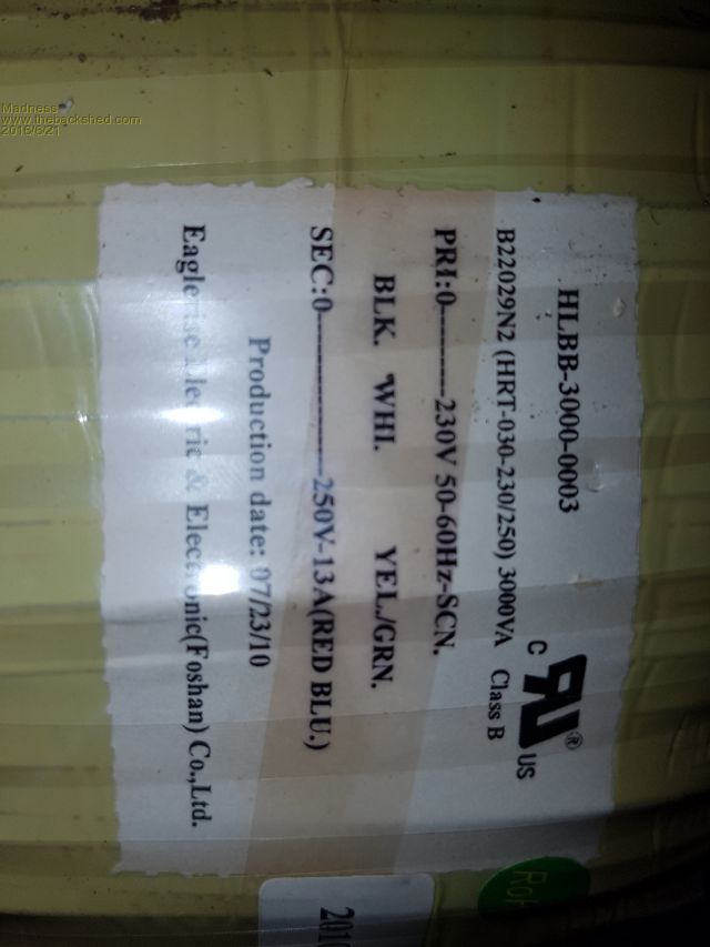

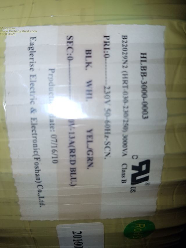

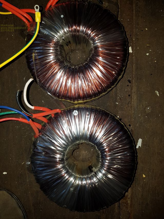

Grogster I should be able to get another Aero Sharp Inverter in the next few weeks. They are $65 AUD each plus $120 for post and a bit for packing. So for about $200 AUD you get a tranny. Maybe Oz has a better solution but this is way cheaper than getting one wound, might cost you a couple beers if I ever visit NZ too.

.. no he gets a much better tranny than he was proposing.... for about 1/3 the cost.
I was hoping you would chime in Mad.
Grog, a standard one will just need the outer( primary 260v) winding removed to have the same thing as you were getting for $600.... then add your own primary of around 22-23 turns.
For the duty you talk about, 25mmsq will probably do fine, so fits very easily, and will still so 2-3kw cont, and 10kw excursions to start things up, or cover for electric jug or toaster etc for small duty cycles of less then 10 mins at a time on top of the house usage.

I know Toll do an international parcel and courier service to NZ (parcels up to 300kg) they do an express and economy version.
if they do a competitive price it could be better to send the inverters complete. I think the weight is calculated from the dimensions of the parcels for their pricing.
most of my freight is delivered by Toll or Toll IPEC.
