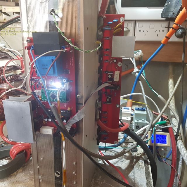

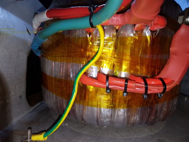

This thread is about my Inverter build based on the brilliant work of Oztules.

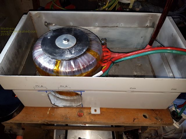

I started with 2 Aero Sharp 3000 Watt grid tie Inverters as per Oztules design. What I have done is wind the torriod slightly differently than Oz's method shown here http://www.fieldlines.com/index.php/topic,148717.0.html
Firstly I have wound the secondary with 4 sets of 1.6 MM windings giving 8 mm square rather than the 3 in Oz's build. I have reused the 2 MM wire that came of the 2 original Torroids for the primary. There is 21 sets of the 2 mill wire giving 66 mm square. With 1/3 more copper than Oz's build in the Torroid it should be able to operate at up to 8 KW continuously.
Here is some specs
Torroid core
ID 100 mm
OD 205 mm
Depth 140 mm
Windings
Secondary 4 X 98 turns of 1.6 MM wire Total 8 MM Square
Primary 21 X 11 Turns of 2MM wire Total 66 MM square
More details of the my Torroid build can be found here.
http://www.thebackshed.com/forum/forum_posts.asp?TID=8220&PN=0&TPN=4
By winding the Torriod this way I will be able to fit everything into 1 original Aero Sharp case and reuse the original heat sink. My reconfigured Mosfet board which is 100 X 250 mm and has the Mosfets soldered to the bottom side of the board so they will be clamped to the heat sink by the PCB.
At least this is the plan, I will post updates as I progress.

Posted: 10:14pm 02 Jul 2016

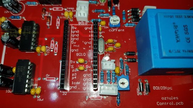

Best transformer I have seen bar none.
The new board will work out very well, and it is easy to replace the fets if needs be too... very friendly to work with.
Can't wait to see the rest of it come to fruition...... and I like the acetone/alcohol laser print thing too.... if I had a laser..... I would try it out tomorrow.

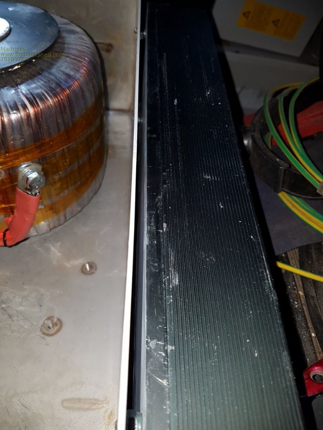

I may need to remove the Torroid bolt so it can move to the left, there is about 20 mm to play with there. I have just stuck the heat sink on there with a few nuts as spacers to see how it all fit together. The idea is to leave a gap for air circulation out the top of the case. Also you can see I have cut the case under the heat sink to allow the PCB to fit and for air flow.Edited by Madness 2016-07-04

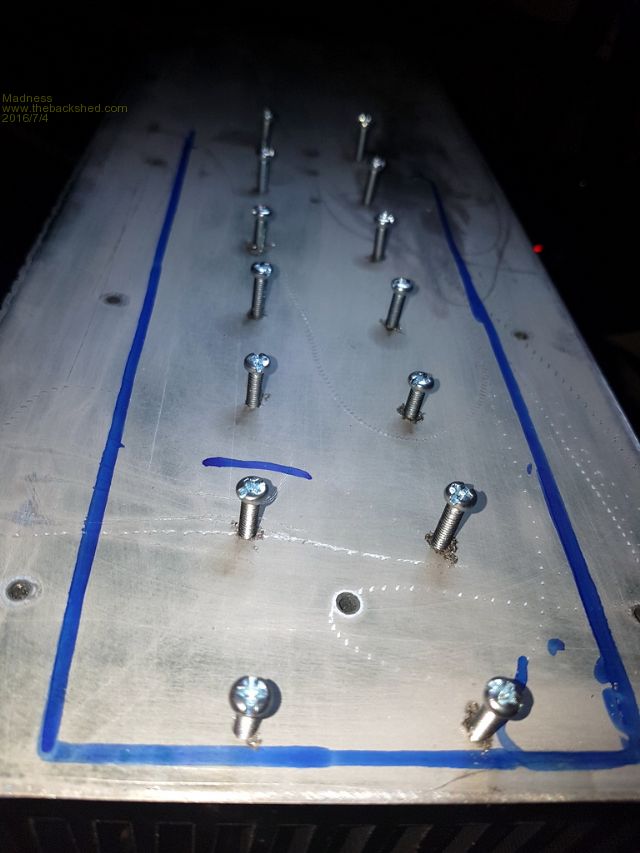

Posted: 10:32pm 03 Jul 2016

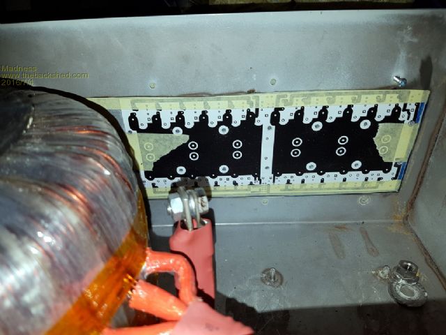

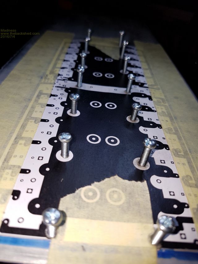

Little bit more progress on the heat sink, found a mistake in my PCB, was a major job to sort it out but I think I have it right now.
The PCB has the screw holes positioned so that they come through between the heat sink fins rather than breaking drills and taps if they where half into the side of a fin.
The hole in the middle of screws will house the thermocouple.
Tried the cold toner transfer but only had a tiny bit of acetone, need to get more tomorrow.
Edited by Madness 2016-07-05
oztules
Joined: 26/07/2007
Posts: 1686
Posted: 11:52pm 03 Jul 2016
Plenty of room for filter networks now... looking very good..... laser works well too.
.........oztules

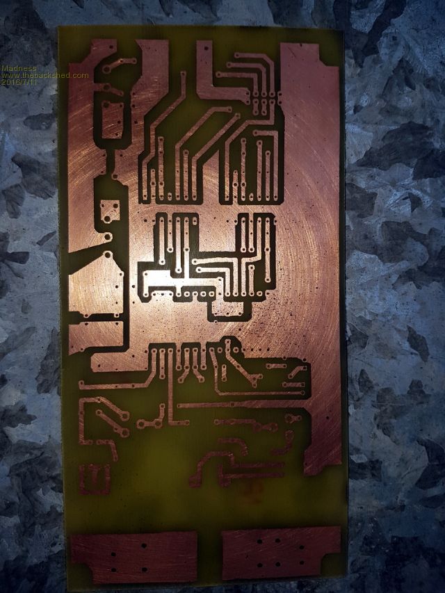

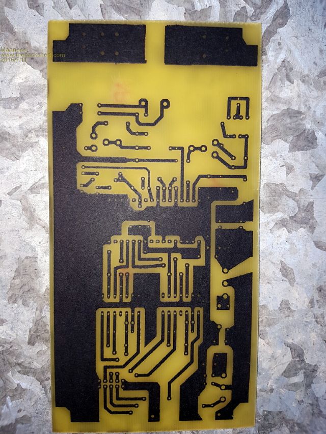

I have been trying all to do toner transfer PCB's, works on small boards but so far have not had success with the larger board.
Has anybody tried any of the Chinese manufactures prices seem to be very cheap but do you get cheap results. Is there any manufactures that anyone is prepared to recommend?
Madness
Joined: 08/10/2011
Posts: 2498
Posted: 05:30pm 10 Jul 2016
Finally a win with PCB making. After trying to use a number of different methods of toner transfer I found one that works quite well for me and my printer.
I have a Kyocera Printer/Copier, what I have found works is to print the art work on glossy paper that has a polished clay surface (most magazines are printed on paper like it). Then using heat to transfer it to the blank PCB, first I tried ironing it on but that was inconsistent, either not sticking in areas or too much pressure causing the toner to spread. Then I used a cheap laminator, that failed, I got better results after heating the PCB in the oven to 165 Celsius then putting it through the laminator.
However I was at the local rubbish dump shop yesterday and got a semi commercial roller type laminator, basically a bigger and better version of the cheap one. The laminator had a smashed power socket and I bought it for $5, I ripped a socket out of an old computer PSU and fixed it.
Running it at full temperature and the slowest speed works really well, just put the printed artwork face down on the PCB and run it through 4 - 6 times. Then soak it in water and rub off the paper. Here is picture of it after etching, some pitting but very usable. This is intended to be a protype and I will get boards made professionally.

Posted: 07:55pm 10 Jul 2016
Looks the goods. Did the acetone not do the trick?
......oztules
Madness
Joined: 08/10/2011
Posts: 2498
Posted: 09:38pm 10 Jul 2016
Hi Oz,
From what I have read the Acetone cold transfer works well with some types of printers. The information online mostly talks about 30% acetone and 70% alcohol, I found that had no effect, but 100% acetone did work to a point. Vary amounts of pressure helped a little but even when I got what looked like a good transfer started flaking off while etching.
The method I am using sticks like s#%& to blanket, I tried giving it a good scrubbing with a tooth brush after etching and it would not move. Cleans off very easily with acetone though when you want it off. It could be used as a silk screen too but I need to check if the toner is conductive.
With the method I am using it is very quick, from print to etching in a couple minutes. I have done the power board by printing top and bottom, stapling them together and putting the blank PCB in the middle and into the laminator. Waiting for my etchant to recover.
It is two-parts of hydrogen peroxide 3% concentration bought from woolies with one-part Hydrochloric acid (30%). At first it is clear, after the first use it turns brown. Leave it exposed to the air and the liquid turns to lime green colour as the copper in it oxidises. Then it has rejuvenated itself and ready for more etching.

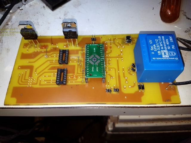

Clockmanfr
Joined: 23/10/2015
Location: France
Posts: 437

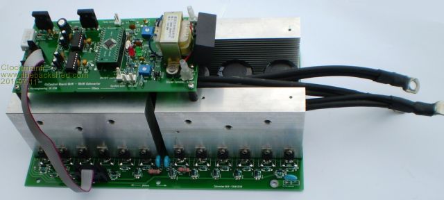

Posted: 12:11am 11 Jul 2016
Hi Madness,
That's looking good.
Yes the isolation transformer is tight. Hopefully there is enough room for that big 2uf capacitor.?
Because of the transformer being tight I have done a little reworking at that end of the board.
Its awkward because of the varied isolation transformer sizes, so I have stuck with a maximum size of 3w 220vac to 12vac open type.
