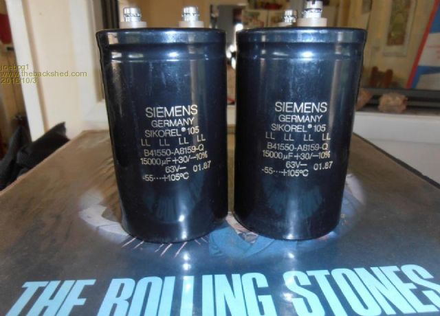

joebog1
Joined: 07/11/2015
Posts: 114
Posted: 05:54pm 02 Oct 2016
hhmmm to give you an idea, these are the caps Im using.
ex raaf long life even if they were made almost 30 years ago. They are brand new
Joe
The LP cover is to give you an idea of scale
joebog1
