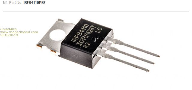

Could also be because what you think are genuine factory spec mosfets are fakes, especially if purchased from EBay or AliExpress.

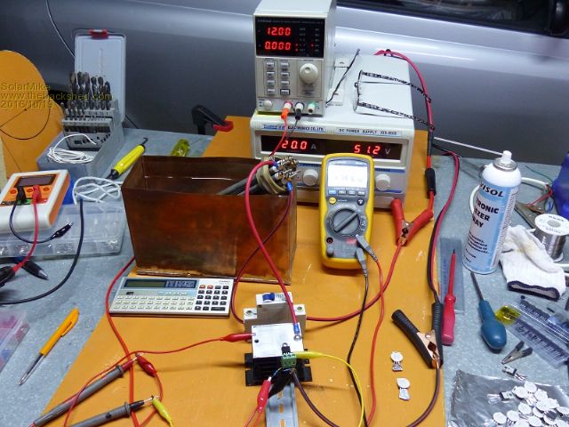

Whilst doing some initial designs for a 200+ amp solid state opto isolated relay module to replace some expensive gigavac type control relays I noticed the IRFP4568PbF mosfets were heating up a lot more than expected, so I built this simple test rig to measure their Rds on, basically a 12 volt bias supply, variable 50 volt 30 amp supply and a 2.5 ohm hot water heater element, see photo.
With 20 amps and measuring the mv across the mosfet drain\source it’s easy to calc the resistance, in this case it was around 23 mOhms rather than the expected 4.8 - 5.9, closer examination of the device shows inconsistencies in the markings compared to that shown on the data sheets, ergo these fets are fakes, and yes purchased on EBay, well over 12 months ago now so cannot do much about it.

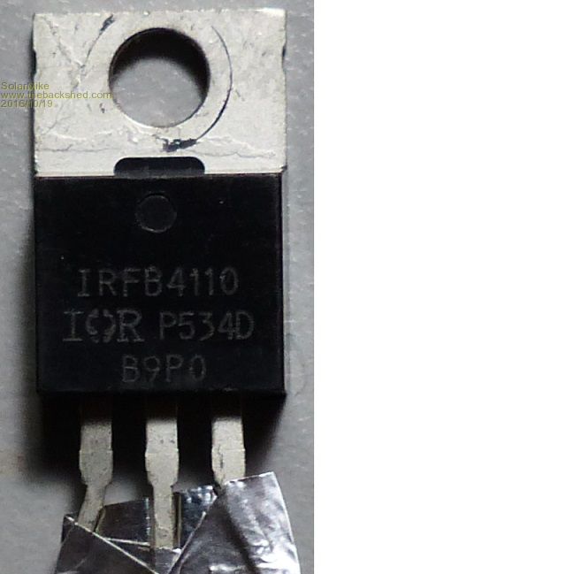

However as I’m also constructing the OzInverter and had just received a batch of 50 IRFB4110 from the AliExpress supplier as published in other topics as source of parts for this project, thought it might be prudent to test them. The spec is around 4 mOhms at 20 degrees C with a 1.25 times increase @60c.
Measuring all 50, the Rds variation was between 6.1 and 7.6 mOhms at room temp, which is pretty consistent but still approx. double what it should be; this was measured at 52v @20amps. I checked just a few at 60c and the increase was as per spec, ie it went up by 1.25 times.
Rough calculations on a 6kw inverter, show peak currents in each mosfet around 45 amps so peak losses = 10 watts for spec devices and 23 watts for the fakes at 60c, that’s just for the RDs on, heaven knows what the other specs are eg input capacitance and switching speed.
Notice the case markings are slightly different from the manufactures, the logo is slightly wrong and the top face indent dot is in the wrong place with no impression stamp in it, also the side copper base indents are not as distinct.
This leads me to the conclusion these are also fakes, possibly cloned from another cheaper device that has been skimmed of original markings and re-done to look like the genuine article.
I have contacted the supplier and they haven’t responded, so have reflected that in the feedback about the sale. I will raise a dispute with them and see what happens.
The main suppliers here in NZ are asking silly money for them and when compared to the same suppliers in the UK, over double the UK price for one supplier and way higher than the manufactures suggested prices, this is the prime reason for purchasing on EBay and the like, we are at the end of a long supply chain here in NZ and we pay for it.

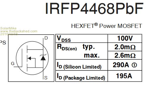

I think for the higher power inverters it may be worth considering to use these, the IRF4468, they have a good power rating and low on resistance. TO-247 package.
Problem now, how do we spot the fakes, I looked at quite a few offerings and the photos of the devices in many cases show incorrect logos and positioning of markings, some look ok and their prices are generally higher, if anyone has tested the EBay\AliExpress devices and they meet spec please publish the link. Is it worth buying any of these devices on EBay?
Cheers All
Mike

Those IRFP4468PBF have some impressive specs but are nearly double the price of IRFP4110PBF at RS components. The IRFP4110PBF are TO-247 also Rs has them cheaper than the IRFB4110PBF.
Their prices for 1 of each are
IRFP4468PBF $11.24
IRFP4110PBF $6.53
IRFB4110PBF $7.01
All prices are AUD +GST, I know there are cheaper places, I have used RS occasionally as they delivery next day for free.

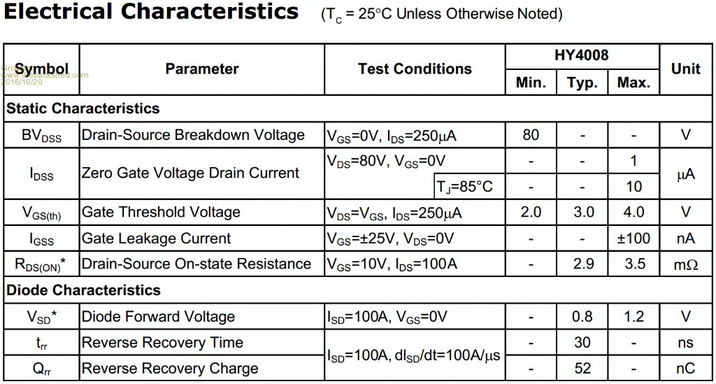

I'm using HY4008's in my design, which are TO247. 80v, 200A RDS(on)=2.9 milliohms.
800A surge rating.
These are quite a common MOSFET in many inverter designs that I have seen, and the datasheet even says they are good for inverter power stages.

Link to PDF datasheet (3.2MB)
They came from - ahem - AliExpress. Just search for the part number - there are plenty of them to choose from.
No, I have NOT checked the RDS, and am going somewhat on the datasheet at this point in time, but BEFORE I use them in my inverter power board, I WILL be load testing each and every one. I am reasonably confidant that mine are genuine, as they are laser-engraved. A very common practise with the fake parts market, is to copy the markings and logo etc, but just print it on the part. I guess it is still possible to get laser-engraved fakes, but probably less likely, as the people making the fakes probably won't want to invest in a laser engraving machine just to produce fakes.
False logic?
Anyway, I am probably going to steal your idea for my testing, so that I can test the RDS - very useful method you posted there.

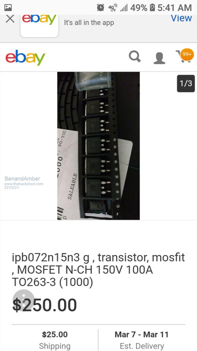

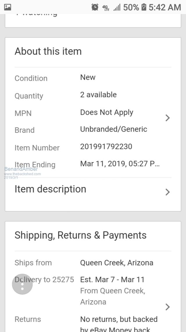

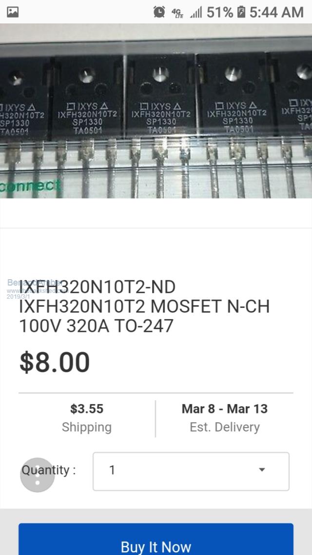

I don't know if this will help or not but this guy is selling a lot of inverter parts from a small inverter company that went under so I think the parts would probably be legit and not fakes he has quite a few different things these are a couple that caught my attention it's all in the USA eBay eBay item numbers in that one pic there's anything I can do to help anybody let me know hopefully this will help somebodyEdited by BenandAmber 2019-03-02
