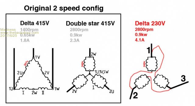

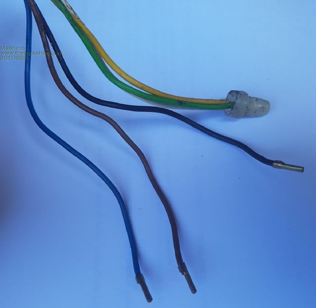

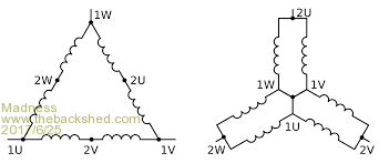

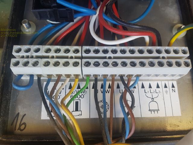

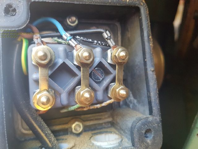

All 3 motors are setup differently, first motor on the planer was dead simple to change to Delta.
Next the saw motor took slightly longer to figure out, it simply has 6 wires coming out with 3 joined together, I separated them and just need to rewire them correctly for delta.
Brown - Yellow = 1 winding
Black - Green = 2nd winding
Blue - White = 3rd winding.
The 2 speed motor for the spindle moulder is a bit more involved, from what I can figure out it is a Dahlander configuration like this.
There is no simple external way to change it to 240V Delta from what I have found. It needs to have each of the Delta windings legs changed from series to parallel, as per this diagram.

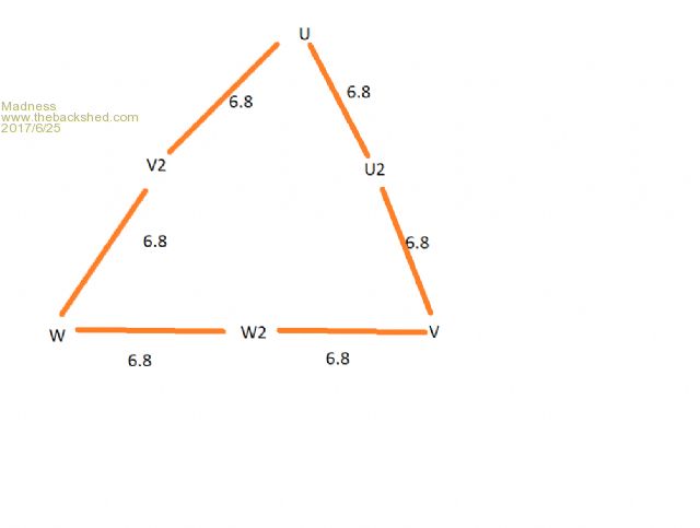

These are the connections of my motor 6.8 ohms on each winding, it seems odd that the W2 and U2 seem to be swapped around.
This is the resistances I get between terminals
U - U2 6.8
U - V2 6.8
U - W2 12.2
V - V2 12.2
V - W2 6.8
V - U2 6.8
W - W2 6.8
W - U2 12.2
W - V2 6.8
Next step is to get the motor out and disassembled to see if I can perform the required surgery on it. Changing it to 240 Delta will eliminate it's 2 speed capability which is no problem as the VFD will provide variable speed.

Posted: 03:33pm 24 Jun 2017
Most VFDs you can set the required nominal output voltage, it does not need to be set to 415v, although that is very likely the VFD default setting if its an Aussie delivered unit.
Whatever voltage the motors were used at originally, you could possibly return to that and tweak the VFD appropriately. That may be a giant step backwards, but just thought I would mention it as something to consider. Edited by Warpspeed 2017-06-26

I'm guessing 6 wires on the left of the first picture are the ones in question.... it looks simple to just connect the wires coming from the motor at this junction, the wires coming from the dual switch are confusing the issue. so just using the wires coming from the bottom of the pic, and throwing away the ones coming from the top.
ie if you connect at the white multi terminal block say 1W to 2V and 1V to 2U and 1U to 2W... then the 3ph from the vfd to 2W,2U and2V, you should have what you want right there.
Warp, I suspect his is 240v 1phase in 240v 3 ph out.

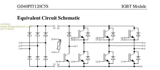

Posted: 06:29pm 24 Jun 2017
No, the ones I have worked on are not like that.
I spent $700 on a bigger unit, and proceeded to blow it up in the first 5 mins.
It used a big intergrated H bridge ( 1200v 40 amps ) and incorporated the bridge as well in the same package.... learnt a lot from that
I could only make 1.414X the input AC rms voltage... it's package was this thing
So it is only the 340vdc not + and - rail.... thus only 240v 3 phase was possible.
My 240v 3 phase is 240v phase to phase. There is no neutral available unless you use a transformer..... sorry for any mix up, but I thought thats how we would use the terminology.
