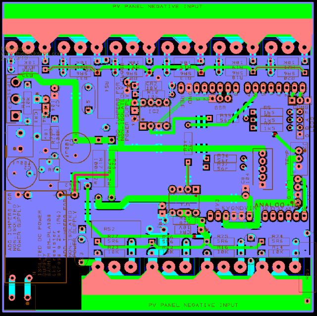

Idle curiosity caused me to combine one of my run of the mill voltage regulators for simple pwm that I use in my 100 amp 48v controllers... into an aerosharo grid tie unit.
I decided this would be simple to do, as it is already set up for 48v battery operation, is fully controllable, and provided high current direct pwm output to drive any kind of fet load.
So the theory looked good, and after 10 mins adapting it to a grid tie ( 1.5kw aerosharp)... stood back and turned it on.
Sadly it was latish in the day, but it still drove near 800 watts back into the ozinverter and into the house and battery bank... then the clouds, and then too late.
So today I hope for some spare time, and some sun to continue testing.
The environment is about 350 volts, and a max of 5.5amps ( yes the little 5x5 cells I DONT use for the off grid system. I only use 6x6 cells for off grid.)
This feeds direct to the aerosharp inputs. Here the neg gets interrupted by a big 600v fet of .35rdson, 20 amps... don't recall the type at the moment, but pulled from a blown up SMA 1kw GTI it was an IXZ something something 600v 20a.
It stayed cold as it was attached to inner case against the heat sink.
Anyway, this turned out to be completely controllable from the 800w down to 14 watts and then no watts.
Now for Clockman, and others where the battery is not available for the monitoring and control, a simple transformer on the output of the GTI will do for the input and driving power of the pwm, so remote operation is possible, using the AC voltage to tell you that the bank is near full, and it will throttle the GTI back and maintain a set AC voltage if the sunlight is available.
Just how that works out in the real world I won't know until I get a 48v tranny or change the board to accept 12v or so .... but it looks stupidly simple at the moment, so am expecting a foot up the bum today as problems arise that i have not bothered to realise yet.
This may help mad and clockman anyway, will update further after some sun turns up and we push it to the max for a bit.
Will rewire the board for 12v and test that on a little 2w tranny today perhaps...... It must work, as thats how the ozinverter regulates itself to very close tolerances.... we will see I guess.
..........oztules

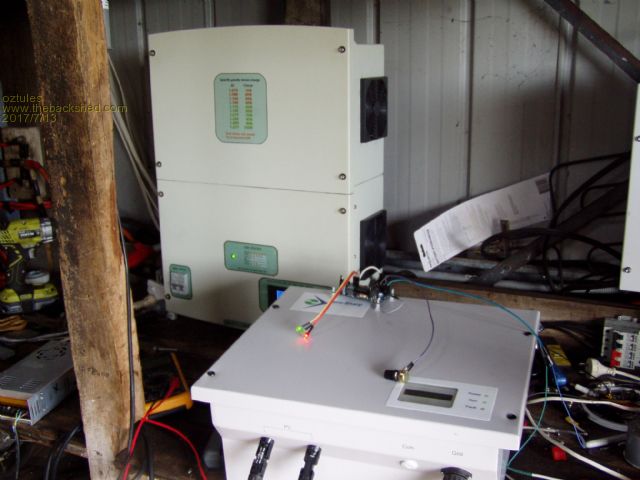

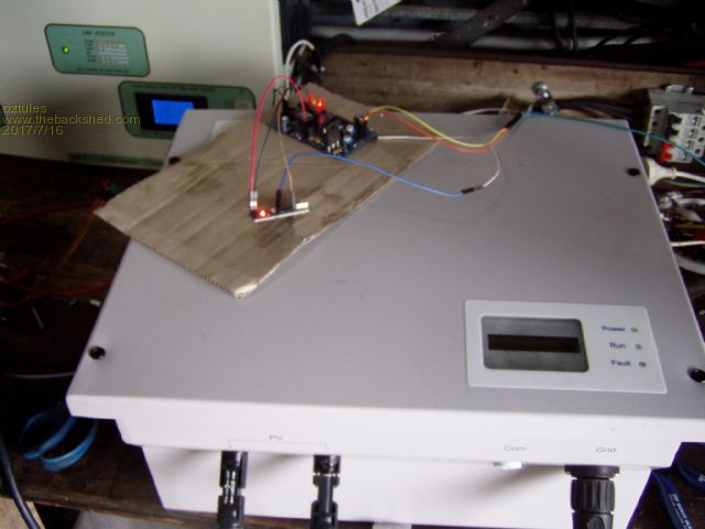

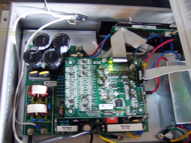

Here are some pics of the setup.

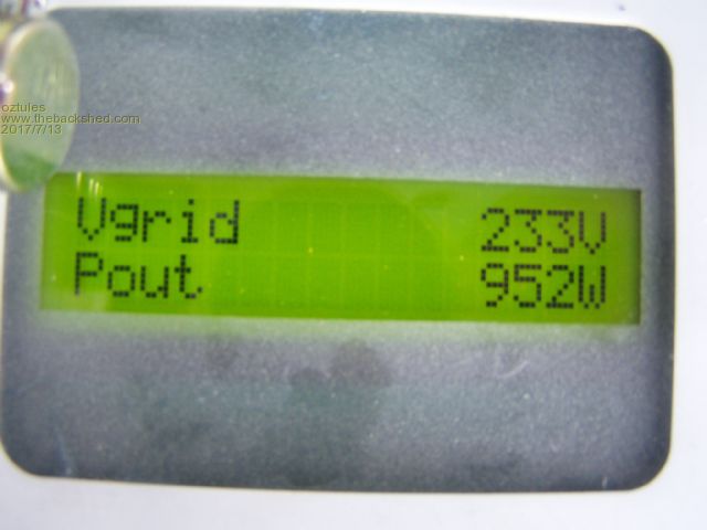

This is the current inverter under test for yet another site... there are quite a number out there now with thousands of hours collectively.... pretty well tested now.... under real house conditions in all kinds of environments.
The GTI is a stock aerosharp 1.5kw unit... only mod is a fet stuck to the back wall, interrupting the neg terminal from the solar neg to the board itself. The input caps are doing any filtering required.
Somehow ( and i don't quite know yet) it keeps the GTI circuits alive while i was fiddling with the control pot, which would have shut all DC power off i would have thought.... but it must leak some hF dc through, as it stays alive, and the caps stay at 150v... threshold before trying to grid connect..... don't know how yet.

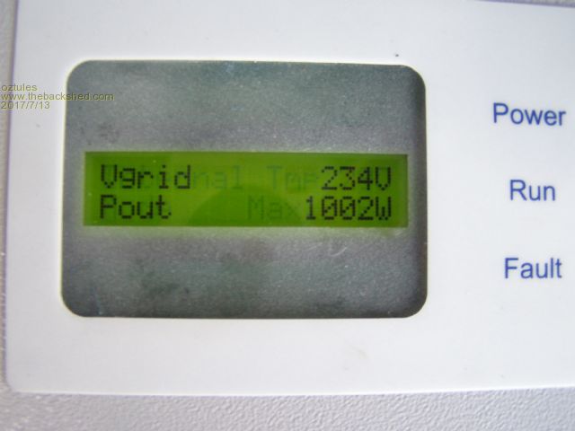

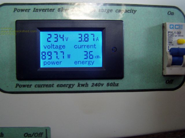

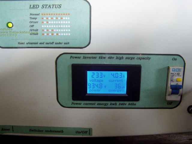

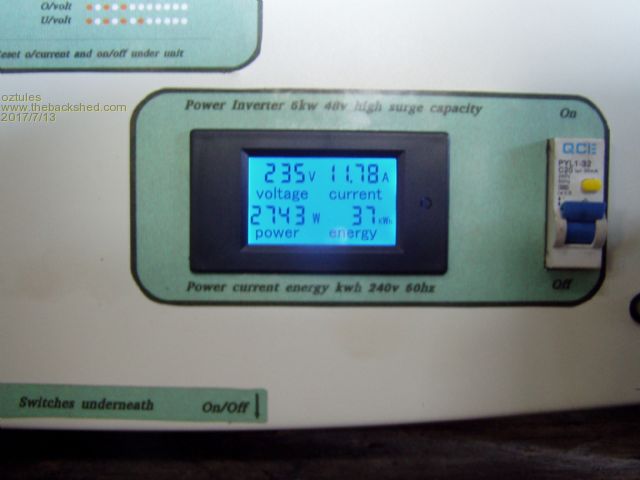

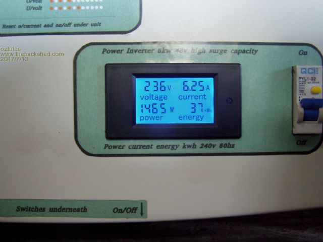

Anyhow, here is the voltage gauge on the main inverter, all AC output is turned off, so anything coming in goes to the batteries...... and the main DC solar controller is set to only 54v, so is not helping in any way to charge the batts.... they are standing at around 56.6v under thi9s test. I have set the off at 57v, so it should taper in about an hour or so.
and another go.....

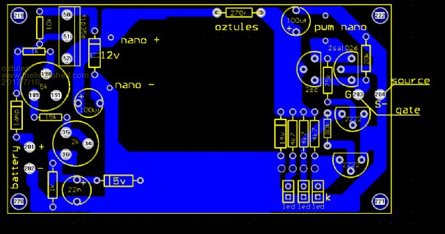

Here is the output screen from the aerosharp... the pics are taken close together, but not close enough for definitive power relationships to be accurately computed... but roughly speaking, there seems to be about a 40- 50 watt difference at the 850 watt range, so 5-6% losses in the system at that level... probably get better as the power goes up from there.... will have to check later in the evening to see how it runs at very low inputs.

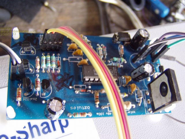

Here is a pic of my 48v control card that is used in the normal solar controller. It can easily run 10 IRF4110 or similar.... here it is only driving a single fet, so it is a doddle.
So for the aerosharps at least , they seem to not mind the control of the panel power. There is no difference to operation apart from less power if I turn the pot down to say 55v, and it pwm's the controller... the GTI just follows perfectly..... hope this continues in this vein.
..........oztules

Well it ran all day with only small stops while i tried different values on the controller board to try to tame the pwm a bit.... it was a bit brutal... well more than I wanted anyway.
Ok.... it works as a concept, and it could work permanently just as it is.
It may be better to just use an arduino for the pwm and sensing, and be done with it, so that Mad can use his algorithm for the charging.... ie get it up to 60v for a few hrs, then back off a bit. This won't do that, it will drive hard till your set point, then feather at that voltage... for winter i set for 59v and leave it, there are not enough hrs of sun to over charge the bank no matter how sunny it is... yes uses water, but i have access to 1000lts per day anyway.
First some dribble.... to say I'm pleased with the ozinverter is an under statement. The noises that came out of the GTI and the inverter when i was tuning it up was scary, but no damage was done, no matter how wildly I tried to upset the power play... It was running the house 3kw loads for a few hrs, whilst accepting wild fluctuations from my twiddling of the pot on the GTI control ( 0-1000w near instantly), while the 80 odd amps from the pwm main solar control gyrated around to match to hold things steady.
Then to really test what would happen, I plulled the 48v leads from the controller to see what would happen at the fet.... then interrupted the solar, then the AC then all of the above....in different combinations.... could not trick it into a deadly fault.
I made that many wild swings in the source voltage and the feedback voltage from full loads to no loads, full solar, full gti solar and all the above... nothing bothered the inverter..... so it is certainly not sensitive to wild loadings and batt voltage manipulation.... I also inadvertently introduced severe instability in the GTI, until it switched out in disgust..... but came straight back on.... I came away impressed. This inverter only has 35kwh on the clock in burn in so far.

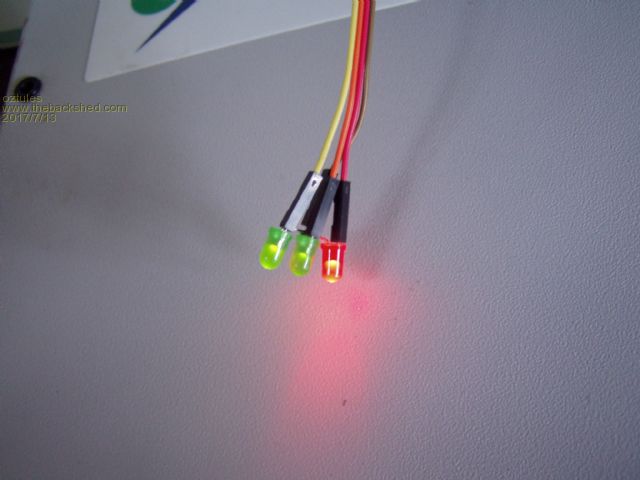

Some pics just to make folks think i did something today.....
Here we have the led lights attatched to the gti controller, three lights means that we have float conditions... ie on, charge and float all together, means it is rattling around between all three very fast.
It measures the input signal ( from an AC tranny or battery voltage in this case) and puts that against a zener voltage in a comparator. This comparator sends the output to another comparator that has a triangular wave form on one input, and the result of the voltage switch ( previous comparator). The level of this voltage , against the triangle forms the pwm wave. This goes to a high power totem pole and out to the remotely mounted fet....A third comparator in the chip makes the triangle wave train.
This fet can be seen in this picture, it has a gate zenner to protect it from me, a 10k gate pull down resistor and a 56r gate resistor if your wondering what is on the pins.... fuzzy I know....
The 1.5kw array managed to get up to well over a kilowatt at one point, so the on off was pretty savage when i was messing about with it.
Seems a pretty efficient way of charging the batts.
One second it was this
and the next second it was this.
And if i kept my finger out of it, it remained battery voltage stable at what ever i set it as. I ended up making the normal solar input fixed at 56v, and the GTI at 59v. Most fo the day it was at the 59v mark, and then dropped back as the light worsened later on.

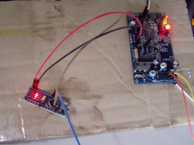

Ok Mad,
This will show you how bad I am at programming the arduino...
Same as i don't do schematics, and just cobble together a circuit on the pcb program my programming is worse... no flow diagrams... just start typing.... and it shows too.
Real programmers may suffer hysterics... read at your own peril
I stole the pwm example function from the arduino site... and then worked out the if statement i think.... will be interested how or what it really does when unleashed on the GTI.
I do this so rarely, that I have to start from scratch each time... bummer really.
So this is what I think will work in some manner yet to be seen.
It compiles at least... first hurdle over.

I have just finished marrying the nano to one of the normal boards shown in the pics above. By just removing the analog bits, leaves the power supply, divider, output totems all ready to hook into the nano with 4 wires... so did that.
loaded into the chip, and ran it on the CRO.... just needed to catch the over flow properly on the 0-255 pwm.... i put the catch all in the wrong part of the routines....
Apart from that, it looks very nice. the waveform smoothly tries to adjust and all looks good... thats the main loop, will look at the absorb and float after seeing the main loop on the real thing.
Should know a lot more in a few hours i guess.

oztules
Joined: 26/07/2007
Posts: 1686
Posted: 08:11pm 15 Jul 2017
ok this is a tidier version... and is known to work properly ( well... in test mode anyway)
This is a test mode version, where the set points will need to be changed for different setups on the input pin voltage versus the real voltage in the battery.
I started off using 500 as the set point for 59v.... but decided to get better definition by using 1000 for 59v.... which made my float at 57v look like 972.
I have left the serial parts in there for looking at whats going on.
But the main thing to take away from this is that dealing with GTI interface is really very very simple.. and why didn't I do this years ago. It would have changed the way I did things and set up the system.
Clockman, I have not seen much in the way of AC voltage swing in the 8010 designs i have.... so you may need to use the power jack instead to get the AC lift, or your 8010 may do a bit better/differently, as I have had barely enough sun to test this out hard as yet.

oztules
Joined: 26/07/2007
Posts: 1686
Posted: 12:46am 16 Jul 2017
Yes, I have just modified the normal 48v analog controller board as I have a 15 of them... will send you some if you want.
The nano will just be glued to the empty space in the center, and has 4 leads going to the board...and two to the fet
plus12v....
gate drive to the fet
Source lead to fet ( neg )
negative/gnd
pwm to the totems
bat plus from the divider.
Thats it.
Here is the pic of the board.... the print to pdf is not set up in this linux at the moment.... just another install..... so a pic will have to do .
edit: the 12v zener... I actually use 18v coz I have a bundle of them... the nano is happy up to 20v. So if you choose the 12, you will have to adjust the 270r resistor to keep at least 11-12v for the totem driver to keep the fet turned on or off properly.
..... oztulesEdited by oztules 2017-07-17
