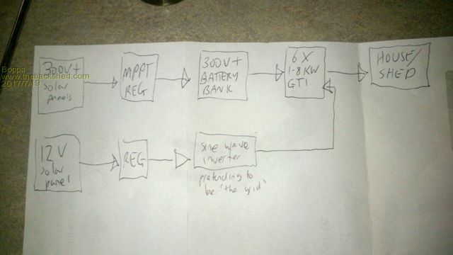

Cant seem to find a reason why I cant online apart from `the rules say' but no electrical reason I can find
To start with, I got the option to get 6x 1.5 or 1.8Kw (owner isnt sure and isnt at the farm atm) grid tie inverters brand unknown- whatever was being installed most commonly in NSW about 5 years ago... for free, just gotta pick them up
they were configured as 3xsingle phase at the house and shed, and another 3x singles phases at the dairy- all being replaced with two larger 5kw 3 phase units
Now I know they are designed for grid tied use, and sample the mains to get phasing etc correct, what I am wondering is if I give them such a signal (from an existing 12v 50w pure sine wave inverter I already possess- that would obviously have to have its own small battery bank/solar panel- handy for 12v lighting etc too) and basically hook up to the correct DC voltage string of batts as a replacement for the solar panels with a `normal panel/controller' system for charging those batterys
Outputs could either be run as individual circuits ie one inverter does bedrooms, another kitchen, another loungeroom etc or surely they could just be paralleled to form one `big' approx 10kw unit (as thats how they basically run in grid tied mode, your inverter hooks up to the same wires as your neighbours etc etc) and as they would all be synced by the same signal from the small standalone inverter
Possible?
Or is my whole idea doomed from the start???
(if so maybe good for parts for a homebrew I spose)

I don't know if that would work but a factor you need to consider is that you would need a battery bank voltage up around 300V.

Now we know we can control the GTI very closely, then theoretically yes.
In practice no.
You really want to try to be fairly normal, and then you have some back up.... going maverick requires that you know all about what your doing, as help may never materialize.
Eg, Most grid ties are not designed to run off a low impedance source, so a battery hook up will probably shut the thing down immediately.. ie normally if to much input current is available, they will just error to over current, and thats it.
So after setting up an abnormal 300v battery, you may be no better off.
If your trying to go it cheaply, then maybe a powerjack or solinda or homebrew 8010 will do it all just fine..... then you can use the GTI off panels to run the thing, and it will work just fine. The GTI cannot be the prime inverter, as it can't support the surge currents inherent in a house situation. Both theirs and my control system is not up to instantaneous surge control.

the voltages arent an issue, used to working with those, just trying to find circuit diagrams on grid ties seems hard, and without those I have been stumbling around without really knowing even the basic details of what controls em....

Get them anyway... you can incorporate them into a system if you buy/build the right sort of inverter. Will be easier than your original thoughts.
Once you have a working "normal "system, you can add things to it... like a few GTI's with controllers like the ones I outlined. then your away....

If you install the GTI with panels connected as normal and use the power jack as your grid it will back feed the excess power into your batteries. The small inverter won't do that.

Boppa
Joined: 08/11/2016
Posts: 816
Posted: 05:00pm 18 Jul 2017
Seems not everyone was getting what I was trying to do
hopefully above will clarify
the 6x gti inverters arent for battery charging or anything else except acting as approx 10kw of offgrid inverters for the house/shed
if the sinewave inverter wasnt happy or the gtis werent happy with the voltages, I got a 300w variac I could put inbetween the sine wave and the gti's to boost/cut the voltages appearing to them and act as isolation between them and the little one(plus maybe a incandescent bulb on the sinewaver to keep it happy)

I think the first reply you got from Oztules is going to be the best answer you will get. GTI's were never designed to be stand alone inverters in most cases. But having the right off grid inverter will allow you to get some use of the GTI's.

Posted: 06:21pm 18 Jul 2017
I know at least some peoples will, I was talking to a friend who got his to fire up off his genny when they had a 3 day blackout after a major storm, during the day it was working off the genny and giving him full output from the panels into the house, and that was just a little 300w chinese job feeding the gti, that fed his water pump and fridge and freezer, something the genny couldnt have done by itself lol
edit to add
just got an email back from him, his inverter is a SB10000TL-US-12 made by SMA apparently, so they do pass through the dc from the panels, which makes me wonder if they would from a battery bank instead
admittedly I still have no idea of what the inverters at the farm are or if they can do this, I'm gunna get him to keep them there for me to pick up next time i'm down there and then basically try it and seeEdited by Boppa 2017-07-20
