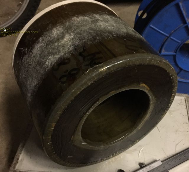

I have 2 x OD 190mm x ID 100mm x 70mm high toroids from 3kw Aerosharps they have been glassed together (another first for me too) and are almost ready for a mylar wrap and then the first winding.
I cant seem to add pictures ATM i will as soon as i can.

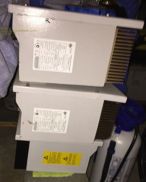

The beast!
2x 3kw not yet tested, and a 1.5kw that faults out, its done a few hours so will probably be gutted.

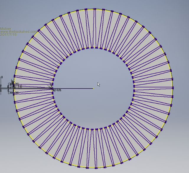

My winding guide.

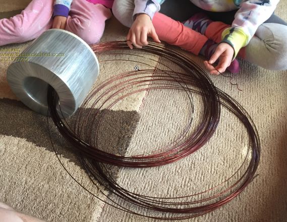

Posted: 02:25am 22 Jul 2017
I managed to get some time and wound the first layer secondary 130 turns.
Then wound on a test primary then powered up the secondary with a variac below are my results.
13 turns 230v = 22.3v 240v = 23.2v 250v = 24.3v
14 turns 230v = 24.1v 240v = 25.1v 250v = 26.2v
15 turns 230v = 25.8v 240v = 26.9v 250v = 28.0v
16 turns 230v = 27.4v 240v = 28.7v 250v = 29.9v
I tested the current on the 240v when powering the toroid and all I could get was 1.2 milliamperes. Is this right? My meters are not great and my good current meter is flat.
Next a coat of epoxy and keep winding. LOL] Edited by Mulver 2017-07-23

You have about 16 turns to do on the primary from the looks of it.
You are mile and miles away from saturation, it is really a 290v transformer, so at 230 it will be just ticking over. As warp has advised, your current should be small... not sure just how small, but 1.2ma seems low. There won't even be any hum I would think.

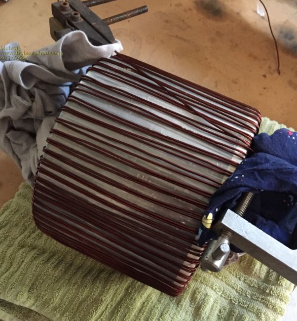

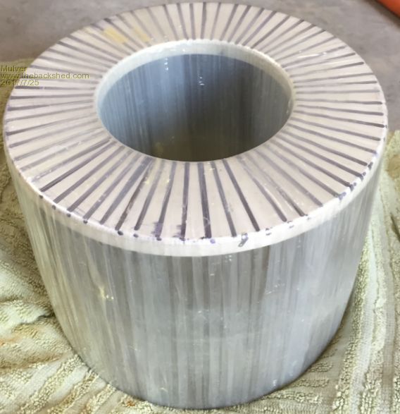

2 layers of Mylar, Heat gun works a treat for removing crinkles in second hand mylar after winding it on.
My winding helpers, yes that's how i wound it on, a little tricky! You must back bend to get the wire laying on the toroid. It did wear my hands out after completing 130turns
Finished first layer of 130 turns, starting to epoxy the winding.
Oztules/Clockman its stated that you use chalk powder to thicken the epoxy.
Are we talking ground up white blackboard chalk? or string line chalk? or something else?

Hi Mulver,
Fiberglass folk use a very fine chalk powder. Mix it with the resin first.
Its used as a thickening agent by weight proportions 20 grams of resin, max of 20 grams of chalk.
The chalk stops the resin from overheating and cracking if used in moulds, but it takes longer for the resin to set.
