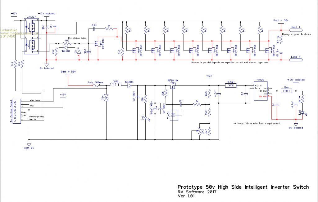

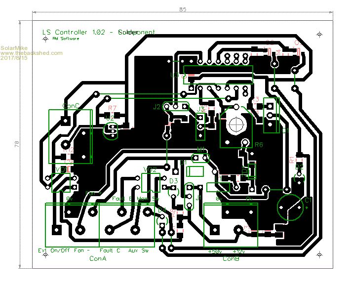

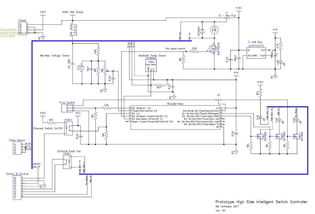

Next item in the do do list for my inverter project, is a solid state electronic switch to replace the various gigavac high voltage relays. These somewhat expensive relays are great and efficient but I require something more generic that can be used elsewhere in other projects with differing currents and voltages; so some sort of very low resistance mosfet switch is required, with limited functional intelligence.
The switch must handle anticipated load currents approaching 300 amps for short periods and perhaps average 100a for extended durations, voltages are for a 50 volt bank but must be able to be used at other volages with minimal modification.
I want the switch to be reasonably intelligent in that it should perform the following actions:
Sense battery limit voltages and switch off if outside set limits, especially low voltage.
Sense heatsink temperature and control fan speed propertionally.
Allow automatic current limited pre-charge delay for charging the humongous caps in the inverter at turn on.
Opto isolated control inputs.
Easy to change settings.
High side operation.

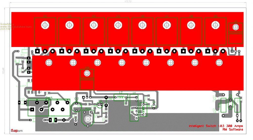

For the prototype, I have come up with a pcb layout for the high power components and a seperate pcb for the controller, note on the control schematic, connectors are miniture spring loaded board sockets, they do not plug into each other directly. As I have a quite a few picaxe chips lying around and they are simple to program, have used a picaxe 14M2 here for the cpu, this gives me another pcb with generic functionality that can be re-used elsewhere.
Main power cct contains the paralled IRFP4468 mosfets and an auxillary mosfet acting as a current limited device, along with a basic 12 volt pre-regulator. Mosfets are switched by high voltage optimos isolated relay chips, no fancy high speed high current drivers are required here; different mosfets could be used depending on expected current load; probably I will only require 5-6, but have allowed for 8.
So I threw this prototype design together without any prior testing and am about to design pcb's:
Controller:
If it works ok, will perhaps add additional load current sensing to the control board (as cpu has unused pins) using a 500 amp DC through hole device to fit over one of the copper busbars, this will allow shutting down the inverter at too high a current load.
Mike
Posted: 08:53pm 07 Aug 2017
This could also be done reasonably economically with a 100 amp dc rated circuit breaker fitted with a shunt trip coil.
The shunt trip coil could be energized from a commercial digital voltmeter that has a pair of programmable voltage threshold alarm relays, for under and over voltage disconnect.
A circuit breaker is going to be a lot more economical than Gigavac relays, and this way you also get the overcurrent protection, and voltage monitoring, and manual disconnect, without really requiring much else. Its also simple with very little in it that can go wrong.
Over temperature could also flick the circuit breaker off with something as simple as a bimetallic thermal switch bolted onto your inverter heatsink.
The above circuit really needs some pretty robust transient voltage suppression.
Breaking 100 amps or more very fast, is likely to produce a pretty fearsome mosfet killing voltage spike.Edited by Warpspeed 2017-08-09

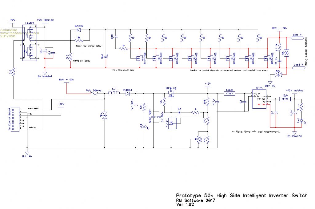

Thanks Tony for your input concerning the transient suppression, I have simplified the main switch circuit to incorporate a 10 sec on time for pre-charge of inverter capacitors and an off time of 50ms.
As transients are caused by fast di/dt transitions on wiring inductances etc, by slowing down the turn off of the mosfets so they remain in partial conducting state for a longer period, any transient spikes should disappear, also placed a couple of transorb devices across the outputs.

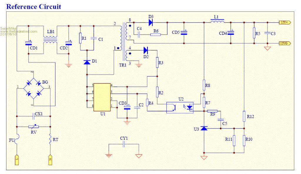

Exactly, got out the magnifier and checked out the driver chip on my non starting PSU board, it is an AP8012, google it and voila AP8012
There is a lot of electronics inside that little chip, looks like the startup resistor R1 could be modified to allow it to run at a lower voltage. The PCB is 5cm x 2.5cm so I could mount it on my main mosfet PCB to replace the clunky 12 volt supply components. Cool will do some investigation, it may even be worth while creating a pcb using that chip with + 5v and 2 isolated 12 volt rails, as I really need the 3 supplies, could use that in all sorts of applications.
Mike
Posted: 11:24pm 09 Aug 2017
R1, C1, and D1 appear to be a snubber network across the primary winding, as D1 is pointing the opposite way.
Bootstrap power for U1 comes via D2 and R3, but if the output is very heavily loaded that will not work very well during initial startup.
From that schematic, the startup system (whatever it is) would appear to be completely contained within the U1 chip, so we are screwed.
There are not too many choices, but a protective zener across CD3 and an added external startup resistor from CD3 to the incoming positive on CD2 might do the trick.
That would supply some additional initial power to U1, and it may only need a very few milliamps to be effective.

Yes of course R1 C1 it is a snubber....
According to the data sheet CD3 on pin 4 must reach 15.5 volts in order to start, supplied via power on pin 5, once it starts then the feedback winding comes into play. I will try the extra resistor, zener to CD2....

  Solar Mike said   Yes of course R1 C1 it is a snubber....
Actually if that the case then i would just start with adjusting R3 lower, at 48v (or there abouts) its getting over its uvlo threshold. I would bet that because the aux winding low for higher voltage, its not getting enough juice to maintain uvlo.. so reducing R3 would mean more current available for chip, regulation still with original opto etc. Just a thought. ..
I think it works !!
