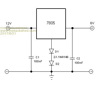

If u put a schottky diode in its ground path (cathode to ground) of the 1.8v device it will bump your voltage up the 200-300mv you need ...sort of like the pic but with a single diode...
I think it works !!

Closest things I have here are MCP1700's & LD1117's in 3.3 & 5v.
I can't use a couple of resistors on the Gnd pin to drop a 3.3 down to 2.0 can I.
I can only go up???
Phil.
Posted: 11:42am 31 Aug 2017
Yes only up, unfortunately.

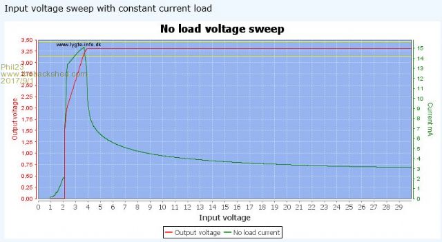

Thing I noticed though is the LM2596 starts to lose stability under 3.85 volts when set at 2.0 out. Typical, as expected from that data sheet.
Bit like this guys test.

@ Phil23 - That link to the test of those modules is excellent. Very comprehensive testing of those modules. I use lots of those modules, so that data is very, very useful for me. I have bookmarked that page for future reference. Thanks for posting that link.

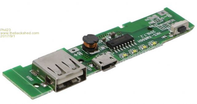

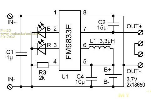

Just pulled a cheap "Juice Bank" charger apart.
2 x 18650's in parallel, little PCB with a FM9833E IC on it.
Notice the data pins shorted on the output. Triggers SOME devices to accept a 2A charge.
But only a Chinese datasheet.
Phil

  Grogster said   @ Phil23 - That link to the test of those modules is excellent. Very comprehensive testing of those modules. I use lots of those modules.
What I'm trying to find is some modules more fitting with 18650's & the 3.6V Nom voltage.
Looking at TI's data, there are plenty of IC's purpose built, but finding a module that uses them is hard.
The Battery pack I popped open, with the 2 cells & the FM9833E is the closest I've seen.
What I planned to with that pack was run an E-100; which it will....
But I planned on adding a wireless charge receiver to it's input, so the unit could just be put back on a "Base" for recharging etc.
Portable E100 sort of thing. That Both charged & kept running when sat on the charger base.
Problem is though, that, that chip disconnects the 5v output when it sees 5V in.
I wanted something like some of my other power banks that maintain their outputs while being charged.
Phil.Edited by Phil23 2017-09-03
