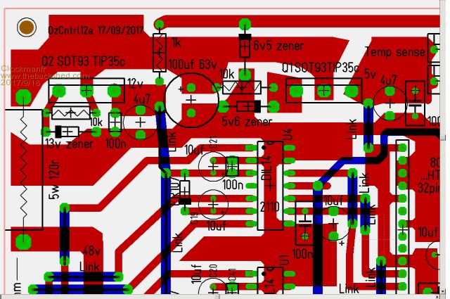

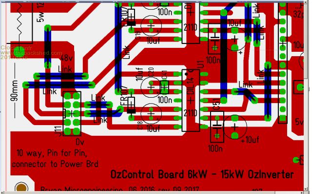

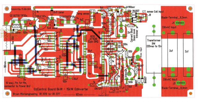

Hi 'Oztules' and guys.
September 2017 and the New PCB has all the latest up-to-date modifications. Thanks to Madness for asking 'Oztules' some clarification questions.
Here are some screen Photos of my latest OzControl Number 12 PCB board, with all 'Oztules' and gangs amendments.
My boards are slightly different than Oz's original's as in the very beginning I wondered away on a different path. But its pretty well Oz's design.
Its 5mm higher/width and 18mm longer, so now 90mm by 187mm. Longer for getting that big extra 2uf capacitor on neatly, with flexibility on deferring sizes with the AC voltage sence transformer.

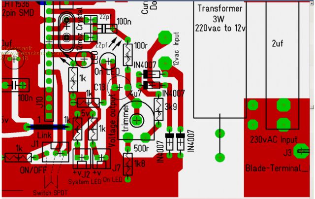

'Oztules' a couple of questions.....
I see with your latest board, 12v supply and 5v supply, you have changed 4.7uf to a 10uf any reason?. .......
Up near the Thyristor there is a diode to the LED, fr101, is this critical?
If you can check my circuit over for howlers it would be appreciated. If okay I will have some made up and put one on test. Then I will post the Gerbers Zip File on here.
Nice design Oztules and thanks.

A quick look seems to show it is ok. The 3k9 may need changing depending on the tranny.
Diode may be anything you have , it is only blocking from memory. 4u7 10uf ... whatever you wish, bigger is better perhaps ... I had a lot of 4u7 left over from something else.

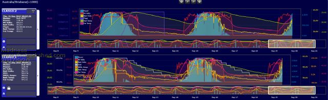

Mad, I had to back off the 25 pwm... it pulled the battery up to 57v in the end... had to go to 5. I also stuffed up the addition of your code, and moved a brace one position... then the absorb used the last pwm setting if the voltage dropped below 57v... sad syntax me.
All good now... but it did not show up on sunny days.... so took a while before I noticed it.

Tomorrow I have some time to try out the new control boards, the transformers I have are 9V so will start out with a 2K resistor and see how that behaves.
My experiments found that the EG1810 is looking for a voltage between 2.5 - 3.0V at the VFB input.
Anything outside that and it blinks a fault.
So, any small transformer from 4.5VAC to 12VAC secondary voltage will do. Just select the first dropping resistor so the pot input sees a max of 4 Volts. You certainly would not want to accidentally feed more than 5VDC into VFB.
Looking at the board Clockman posted above I see there is a 1K8 resistor from the low end of the pot to ground. This complicates the dropping resistor calculation.
If it was me I would short this 1K8 resistor so the low end of the pot is at ground level.
For example, I use a 15K dropping resistor from the rectifier (12VAC in) to the 5K/15turn trim pot input and a 100R series resistor at the wiper to VFB track.
A multiturn pot gives a much finer control here. You'd have to put nail polish on the single turn pot adjust screw to make sure it stays locked to the chosen setting.Edited by Tinker 2017-09-20

"So, any small transformer from 4.5VAC to 12VAC secondary voltage will do. Just select the first dropping resistor so the pot input sees a max of 4 Volts. You certainly would not want to accidentally feed more than 5VDC into VFB."
No, it is not possible to inject 5v into the 8010. This is a negative feedback circuit, and the transformer can be any voltage at all, even 300v... makes no difference to the 8010. It will regulate the output voltage so that it never exceeds it's set point.
Before I added the isolation tranny, it had 320v or so on the input divider, but with the divider the 8010 made sure to keep the voltage on it's VFB input was what was intended. The divider is only there to get the output voltage up over 3.5v or more, not to protect the VFB input... it won't let it rise.
The consequence of this is that the output voltage is driven by this relationship, not the other way around.
By fixing the fixed resistors in a decent combination, we make the voltage range of the trimmer quite small, and so a multiturn ( which I hate) is not necessary,nor is the nail polish. That combination would be a result of poor resistor selection, and excessive range being required to be set by the trimmer.
I can't say the same for the current limiter, there I should have spent more time on the divider values..... but it is what it is, as the range there goes from a few kw to up to 16kw. Over 270 degree range, it is a bit more in the territory of multi turn. May give this some thought one day... and maybe not.

Thanks 'Oztules' for having a peep at the revised No12 version, and your comments, gosh how we have progressed/lept forward in 2 years.
The rev12 Ozcontrol board has the anti blow up if the AC is shorted. ? ........ And the correct Pin 6 start for stable and soft starting correctly without the worry of very short cables to the On/Off button.? yes?

Madness, Regards the 100 x 100mm PCB boards. In the bigger picture of the OzInverter, PCB size is not an issue, but yes cost is, so there is a trade off and I do really try to keep the boards as small as practically possible.
I also think, "what if that type and size of component, etc, is unavailable, is there space for something else"?
I am a Micro engineer, mechanical manipulation to 4 micron, so I come at this from a diffrent angle.
For me, with this OzInverter, simplicity, robustness and longevity, comes ahead of cost effectiveness on PCB size.
My Power board has large tracks and peculiar shape solder pads for load spreading. My FET's from the word go, have there gate components as close as possible, normally just a few mm.
On all my PCB boards I have deliberately designed them with larger than normal component pads and tracks that can be soldered, unsoldered and repaired with minimal substrate separation problems. (I remember my Heathkit modification days, and trying to repair modern PCB's yuk!)
With this project Sub board connections are kept minimal,I hate weak mechanical electrical links.
With this OzInverter operating at 24/7, and in all sorts of harsh environmental conditions, the PCB boards must be seen as a critical issue, especially if we are looking at a good 10 to 30 year period of longevity for this Inverter.
Anyways, hence my old fashioned, through hole component, chunky design so anyone with competence can make a OzInverter anywhere in the World, and anyone with competence can do future repairs with ease.

Clockman, yes it has the current limiter, and the on/off works as you say.
I have not stuck a screw driver into it to test the short circuit capability as yet, so can't say yeah or nay.. it should... just have not had the balls to do it.
The single failing it has is not to shut down from low battery... an over sight that can be fatal with the right combination of load and battery voltage. Have seen two go down from this, as when the battery volts go down, the primary current goes up, and with enough load, and low enough voltage........well, if the low AC does not kick in, then the primary current can go silly..... I must get around to fixing this. Apart from that they seem to be rock solid from the near ten inverter years they have run so far.
If they weren't so easy and cheap to fix, I would have done something already. I might just use a nano and connect it to the driver inhibit pins, and that would cause the 8010 to signal low voltage as well for an indicator.... hmmm...

Probably better to work with actual state of charge also, my charge controllers I am using at the moment do that, very easy to implement with just a shunt.
I am sure you will come up with a good functional version I still want to build a more complex version with data logging and web server.
Like what have currently, the white line is state of charge.
