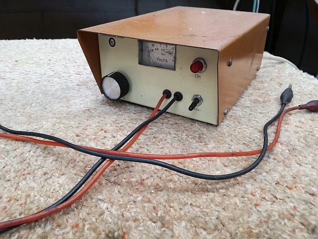

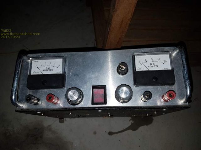

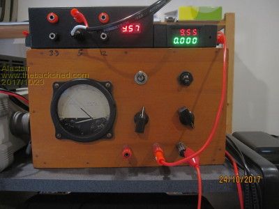

Hi All,

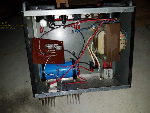

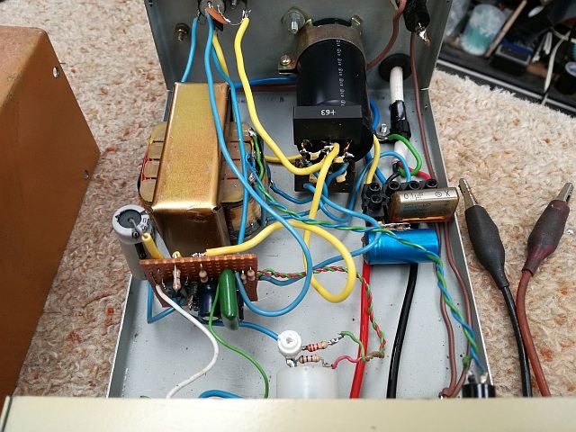

Planning on upgrading the old power supply I built as a teenager....

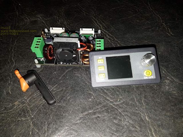

Plan on using a DPH3205 Module I've bought.
Don't really remember the size of the transformer, just that it's good for at least 5 amps & the rectified DC is about 25V.

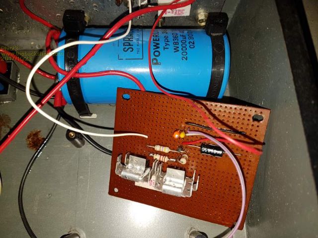

The Cap after the Bridge is 20,000uF; probably because that was impressive to a teenager, (not sure where I got it).
Don't recall the actual circuit, but there's an LM317, a TIP32 & a pair of 2N3055's on a heat sink.
I do remember the 2N3055's were an essential as I like the look of a pair of them on a heat sink. (Nerd version of a set of wide shiny wheels).
Main question I have, is can I just drop the new module in across the bridge & cap & leave the old stuff in place.
Sort of like the immediate control you get from a Pot in some circumstances; quick changes & instant analogue feedback on the gauges...
Phil
And Opp's I left it out & it rained yesterday; standing draining....
The left Pot does nothing; I was going to be current limit, but that never happened.
That big fat Cap was irresistible as a Teenager...
But still needed a couple of T-03 packages on a heat sink for external Bling...
Earpiece is just there to indicate the size of the two modules.
Edited by Phil23 2017-10-24
Alastair
Joined: 03/04/2017
Posts: 161
Posted: 12:55pm 23 Oct 2017
Phil,
Why do you want to change it? What can't it do the you need?
The advantage of what you have is that it is linear and should be free of switching noise. If you add the device you are proposing it will have noise that you will have to watch.
Like you I built a simple linear power supply as my first real project when a teenager. Transformer, variable regulator, 3055 booster, big output cap, dual sweep meter for volts/current ex aircraft from surplus store. Later added current limiting with a 317.
Recently added fixed slave linear regs for 3.3/5/12v and digital meters all mounted in plastic boxes on the outside of the original wooden boxes. Works well but I had to put a lot of work into filtering out the noise from the digital stuff I had added. Not pretty but functional. I have a couple of new clever supplies but still reach for the old one first.
My point is think carefully before changing it. Perhaps make a secondary box with the new bit that just links to the old box so you still have the clean linear when needed. I hate hash on supply lines and have been caught in recent times by issues from el cheapo power supply modules from you know where.
cheersEdited by Alastair 2017-10-24

You can certainly use the newer module in tandem with the old system. Of course its likely expecting pretty clean DC, so a couple of smaller caps on the input as well as the huge one would help ensure smoothing. The new unit I think will be stand alone only, unless you hack into its controls. Despite the HF noise they appear to be very nice units.
Wonder if a ferrite on the output leads would smooth the output much.
Ralph
Phil23
Joined: 27/03/2016
Posts: 1667
Posted: 09:57am 24 Oct 2017
  Ralph2k6 said   You can certainly use the newer module in tandem with the old system.[/quote]
That's what I had in mind. Leaving all the existing circuit intact,
but just adding the new module for a second output.
As others say there are lots of benefits of the old design & I don't want to scrap it.
Just like the extra features like presets & current control that's not in my old design.
So if can go straight across the existing DC input, It's just a matter of cutting the front panel & connecting it to one pair of the existing output terminals, or maybe adding a new pair.
[Quote]Wonder if a ferrite on the output leads would smooth the output much.
It does have a fairly big toroid on the output; LHS in the above pic.
Phil.
