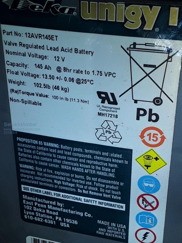

Renewablemark did you end up getting you a forklift battery
I see Madness has got one
I read somewhere that I may only get like three hundred Cycles out of my batteries so maybe only about a year
So I am curious about other types of batteries
so I don't make the same mistake again but I did get these batteries very cheap
They are 10-year batteries
but only made two cycle very few times in that 10 years
they're back up batteries for power failure just long enough for the generator to start up
I've read somewhere that I may be able to drill holes in these batteries and add water and make them last a lot longer
so I'm very interested in anything to do with batteries on the cheap if any of you Pros have any suggestions please share them

Ben and Amber,
I've had and still got working Valve regulated lead acid batteries for around 15-20 years ,some of them I've thrown out ,because they slowly died.
So, I think you will be happy with your purchase, if you treat them nicely ..

Wow that is incredible do you have any post on how you take care of your batteries

My banks ,3 of them , are all the same brand and Ah type ,so thats first recommendation , . then because of this I can cycle between the banks to give each a similar work time and watch their voltage-even though you may see very slight voltage drop .
apart from that ,I just feel with the palm of my hand along the fronts of the batt cases, you will notice any diff in temp ,the palm of your hand is very sensitive to temp,I've found. when I found one that was warmer ,I disconnected it and are enough , the voltage dropped fast. So--the Ol hand trick is fairly sure of something going wrong.
mine are small banks, around 200-300 Ah. -I have a battery control switch board that has those big red battery switches you see in boats on it -so I can isolate or parallel banks whenever.
( I once connected up a bank mistakenly with 3x12V ,INSTEAD OF THE USUAL 4x12V for a few hours.(48 VOLT bank)
so it was charging into 36 volts?
YOU'LL SOON KNOW, BECAUSE MY ROOM ,WHEN I OPENED THE SLIDING DOOR TO IT ,SMELLED OF THIS ACID TYPE SMELL ,AND ,OF COURSE ,I disconnected them immediately and found my mistake-that was just a couple of hours..

The life expectancy depends very much on how deep you discharge them each time, I had a huge bank of exTelecom batteries that lasted well over ten years when I lost track of them after moving interstate, I had them for the first five years, and they never got below 80% charged (ie I used 20% overnight at most, usually less) and after 10 years they seemed still pretty much at full capacity...
I also had a single 120ahr lead acid I used for my first camping battery in the ute, which hit the voltage cutoff every night on the fridge, and after just under two years of once a week/fortnight of usage, was so down on capacity it was unable to run the fridge for more a couple of hours- when it was replaced I actually refitted two instead, they lasted about eight years
So yeah the depth of the discharge is a major killer

Have you guys ever heard of adding distilled water
or battery acid 2 AGM batteries that are maintenance free
basically Telecom batteries like boppa was talking about

These were pre-agm's Telecom batteries, flooded L/A (complete with auto watering system)
Yeah adding water to acid is dangerous, as it can boil and spit back out at you- it's always acid to water (doing it the other way can actually get to the boiling point of water in less than a minute with equal amounts of water and acid!)
Years ago when I was an apprentice we got to do the battery fills where I worked, which was less than pleasant- you literally ended up with your clothes being rags at the end of the day... (we were supposed to get 'acid resistant ' clothes, but they were always out of stock lol, so we went to Vinnies!!!)
We had to dilute the supplied acid 10:1 with water before putting it in the batteries, so it was strong stuff indeed- full respirators and goggles were mandatory, and we had 'filling stations' for each battery (massive things about 70cm high, 30cm wide and 20 cm across) and you filled the premix (ie diluted down to 'standard car battery acid strength' in special glass containers with thermometers, and there was a clock, you wrote the time down on the glass for each level of dilution and waited the correct time, checked the temp, and if it was acceptable, add the next amount...
These days you probably wouldn't even get away with what we were doing without a full 'spacesuit' kit etc
ETA one thing that would be safer, would be adding extra acid mix to it, you can buy 'battery acid' in bulk, don't know about smaller amounts- as batteries are usually shipped 'dry' and filled onsite (or were)
If you mix, diluted to the same level as the batteries existing electrolyte, it would be (relatively) safe to pour straight into the battery....Edited by Boppa 2019-05-06

Okay I will keep my eye out for some acid the batteries are new right now but after I use them for 6 months to a year I was planning on maybe trying to do this to make them last longer
