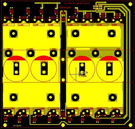

So, my first step is to draw a schematic of the power board based from the gerber that Oztules posted somewhere, probably here also.To minimize my confusion, the schematic basically follows the same viewing orientation as the gerber. I will appreciate it if anybody has the time to look at it as I always make mistakes. Thanks.

Good day ,
Looks good
I can not find the red 4.7uF 400v polyester capacitor fitted to the middle of the powerboard in between the large capacitors.

I have added the capacitor (silkscreen says 4 uF). Also, found that it has 4 10000 uF capacitors instead of 6 and 6 GND pads instead of 5. They are also corrected.

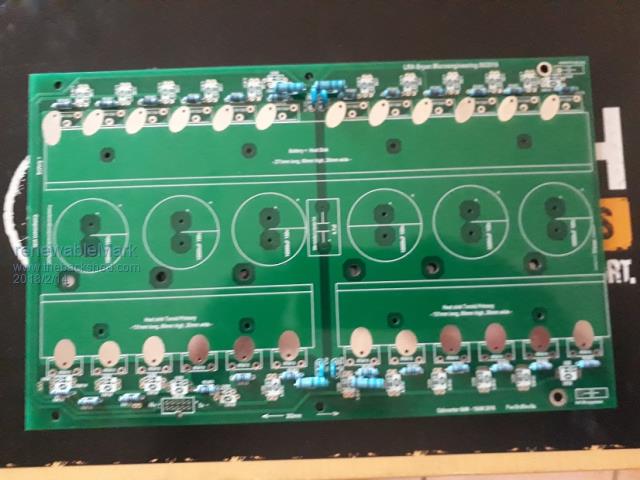

You can buy the boards here
Cheers Caveman Mark

Madness
Joined: 08/10/2011
Posts: 2498
Posted: 10:23pm 13 Feb 2018
Oz has reduced the FETs as well to 16 in total as he is now using the beefier HY4008's rather the 4110's. Nothing wrong with 6 caps, that is what I am using.

Here is a GerbTool screen capture of the top silkscreen and top copper gerbers that I traced to make the schematic.

tinyt
Joined: 12/11/2017
Posts: 564
Posted: 11:28am 14 Feb 2018
Hi renewableMark,
Good question.
Silkscreen marking says 5 kw. I don't know if it was tested at higher loads. I only need to use it for a 1.2 KVA application with power coming from a 48V 100AH battery bank.Edited by tinyt 2018-02-15
Posted: 12:20pm 14 Feb 2018
Should be fine for 1.2KW.
5KW would be risky unless the heat sink and cooling capacity are up to that.
I'm building a 16 mosfet/ 4 capacitor inverter presently but its for 3KW.
