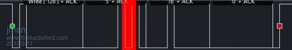

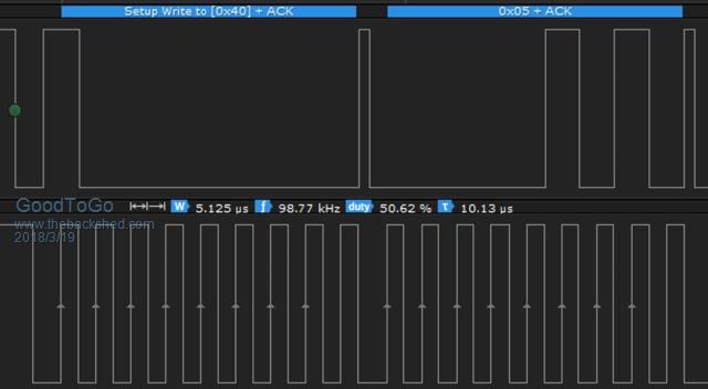

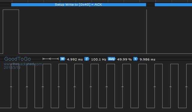

jman
Joined: 12/06/2011
Posts: 711
Posted: 06:58am 17 Mar 2018
And some more food for thought
Screenshots of the write and we can see the timing is not the same.
The working write is below the bit in RED is 10.1us
The NON working write the bit in RED is 9.988ms
Export of the trace in txt format, seems odd the reads are missing from the NON working one
Working
Time [s],Packet ID,Address,Data,Read/Write,ACK/NAK
0.621046166666667,0,'128','5',Write,ACK
0.621140333333333,0,'128','16',Write,ACK
0.6212345,0,'128','0',Write,ACK
0.637430666666667,1,'128','0',Write,ACK
0.637524833333333,1,'128',<,Write,ACK
0.637619,1,'128','207',Write,ACK
0.640441,2,'128','4',Write,ACK
0.640916833333333,,'129','0',Read,ACK
0.641014083333333,,'129','3',Read,NAK
Not Working
0.902392583333333,0,'128','5',Write,ACK
0.992295416666667,0,'128','16',Write,ACK
1.08219,0,'128','0',Write,ACK
1.30808975,1,'128','0',Write,ACK
1.39799591666667,1,'128',<,Write,ACK
1.48789825,1,'128','207',Write,ACK
1.70038208333333,2,'128','4',Write,ACK
So it seems the timming is an issue
Jman

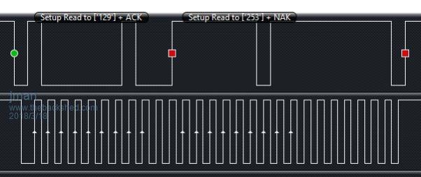

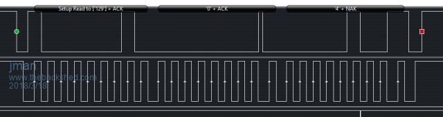

jman
Joined: 12/06/2011
Posts: 711
Posted: 09:11pm 17 Mar 2018
Some more info from the logic analyzer
Working read
Non working read
Working export
0.567969875,0,'128','5',Write,ACK
0.568064,0,'128','16',Write,ACK
0.56815825,0,'128','0',Write,ACK
0.57616525,1,'128','0',Write,ACK
0.576259375,1,'128',<,Write,ACK
0.576353625,1,'128','207',Write,ACK
0.58779375,2,'128','4',Write,ACK
0.58826975,,'129','0',Read,ACK
0.588367,,'129','4',Read,NAK
Not the non working one has NO ack after the setup to read but instead has a second setup to read ?
NON Working export the read is missing :(
0.784313625,0,'128','5',Write,ACK
0.8742155,0,'128','16',Write,ACK
0.964119375,0,'128','0',Write,ACK
1.181285875,1,'128','0',Write,ACK
1.271188875,1,'128',<,Write,ACK
1.36108075,1,'128','207',Write,ACK
1.5783975,2,'128','4',Write,ACK

Posted: 05:47am 19 Mar 2018
Finally got around to trying this on my logic analyser. (Saleae knock off)
The first thing I noticed is that the I2c clock for the MM port is 100KHz. However the CFunction appears to be 100Hz!
Using the dedicated I2C port:-
Using the Cfunction:-
Attached are the analyser files (in LOGICDATA format) for anyone to have a look at.
2018-03-19_154535_I2C_INA219_Logicdata_files.zip
The clockspeed explains why it's slow I guess......
Thoughts?
