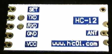

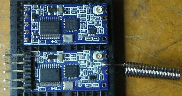

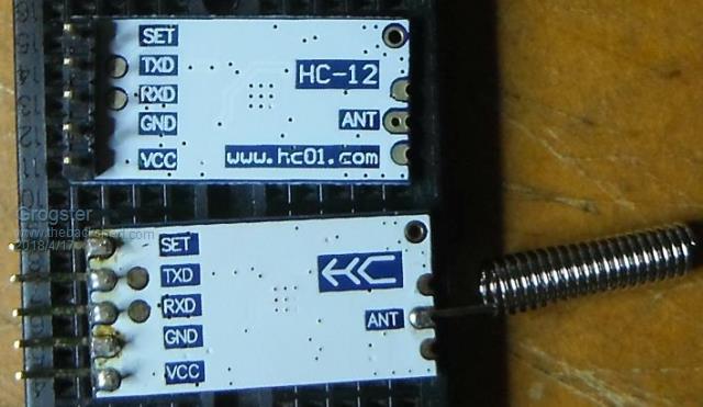

Looking at the modules up close, they appear to be identical electronically, but there is a silkscreen difference with the newer ones over the older ones:
The module with the helical fitted is the OLD one. Note that the newer one has the website on the bottom silkscreen.

Just to clarify the setup:
You have a new module with no antenna (helicoil) trying to connect to an old module with an antenna (helicoil).
What antenna configurations have you tried to get them to talk to each other on either/both modules?
Posts: 10081
Posted: 05:55am 17 Apr 2018
No, both have helicals. I just left the helical on the old one, so you can easily see the difference between the two in the photos.

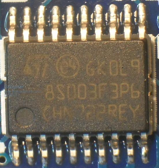

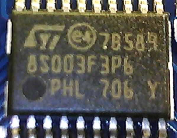

Here are close-up shots of the MCU's, which do appear to be a different part number:
OLD HC-12 MCU:
NEW HC-12 MCU:
It is possible I am on the wrong track here - I don't really know my ST part numbers, so it might just be an equivalent part.
EDIT: I take that back - they both seem the same. The ST part number would appear to be the 2nd line, not the first one. Both 2nd lines match, so I expect that is the actual MCU part number, meaning both modules are EXACTLY the same.
I need a large Whisky.....Edited by Grogster 2018-04-18

This is the chip the bottom right is the date and revision code (page 93 in the manual).
So they are both rev Y of the same chip AFAICT (as far as I can tell).Edited by Azure 2018-04-18

Do you have a close up of the two chip versions. Might be some chip revision stuff worth looking up.

Both exactly the same part, that being "44631B" on the chip, which is a Si4463 revision 1B, so the RF chips are identical.
Looking at the datasheet, page 33 talks about setting the frequency synth, and so I suspect that in the latest version of the HC12 firmware(in the ST chip on the module), they have changed the stepping factor for setting the frequency, which would explain this issue.
To confirm this, I could swap the ST chips between the boards. If that is indeed the case, then that would make the NEW one behave if you see what I am getting at. Naturally, that is not a practical fix for the issue, but it would prove one way or another if the ST MCU is the problem here, and I now suspect that it is - it HAS to be, cos everything else is identical between the two different boards.

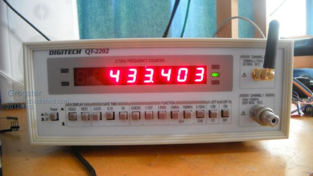

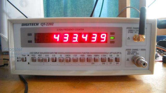

Here is a little evidence of what I am saying:
NEW module on Channel 1(433.400MHz):
OLD module on Channel 1(433.400MHz):
Definitely a 30kHz or so frequency problem.

  Grogster said   Yup, the new ones are 37kHz out on the 433MHz band too.
I reset the new module to Channel 1(433.4MHz), and they are NOT there on 433.400MHz on the scanner, but they ARE there on 433.437MHz....
Hmmm... I am wondering if there is something "hooky" about the new modules you have.
The ones I have in stock (with the URL on the silk) match precisely what you show and according to my scanner, 433.4MHz - not as precise as your measurement though.

Possibly, but I bought these 'New' ones ages ago now - I bought them for stock, as I was always using so many of them at the time. As I had had such great success with them before.....
Technically speaking, if they only list the channel frequencies to one decimal place, then they are still within spec. I am just reading them to three significant figures which is pretty much standard for UHF frequencies, but the old ones are correctly on frequency, so I expected the new ones to be too.
I have a feeling that as far as the producers of the HC12 are concerned, 433.4MHz and 433.437MHz(or so) are the same thing - they only care about 100kHz resolution if you see what I am getting at.
LETS BE VERY CLEAR ABOUT THIS - The new modules work just fine, and do exactly what they say they do, they just seem to have a 30kHz or so error in their channel frequency, which makes them incompatible with the older generation module.
