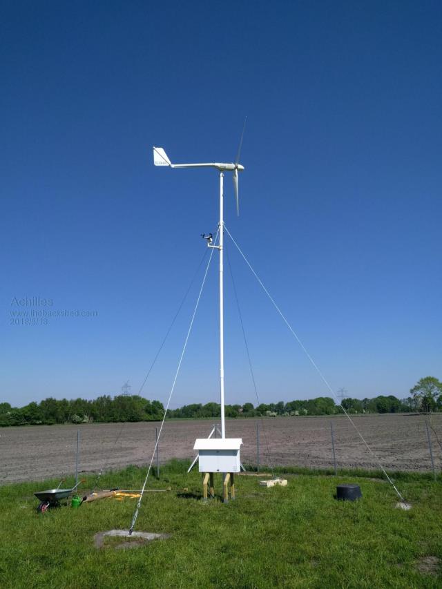

This is the turbine I bought:
https://www.alibaba.com/product-detail/HENRYD-2kw-wind-turbine-for-home_60299449838.html?spm=a2700.8443308.0.0.504b3e5fz cXKRn
I mounted it on a 9m (30 feet) tower and use this kind of grid tie inverter:
https://www.alibaba.com/product-detail/12-years-manufacturer-1000W-wind-power_60643408337.html?spm=a2700.7724838.2017115 .1.5f3d618288f1KC
It can handle 22-60V of input voltage.

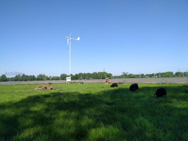

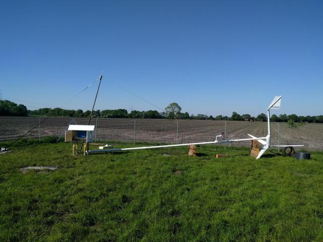

Anyway, the whole system looks like this:

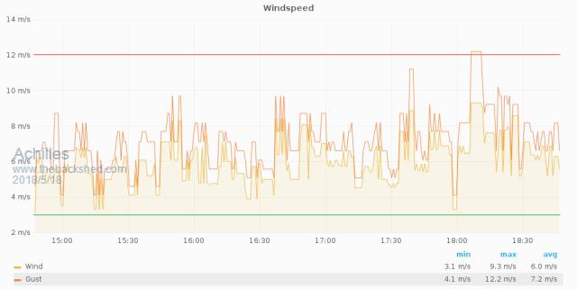

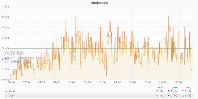

2 days ago I had some nice wind:

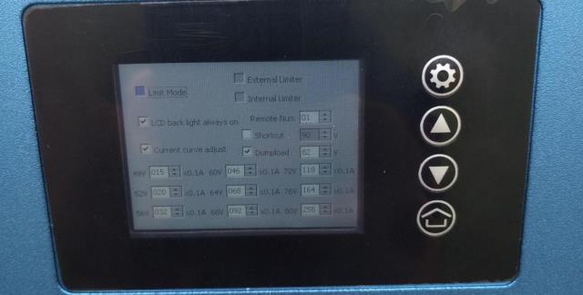

The problem I am faced with now is that I don't get up to speed.
Even at 7m/s wind (15.6 mph) it is only rotating at about 60-80 rpms.
At that speed I get 30 volts peak and 67W for just a few seconds.
I am assuming that the controller / inverter puts too much load on the turbine too early, thus preventing it from spinning up.
Maybe you guys have ideas on what is fishy here.
I just ordered a 45-90V Inverter to check whether it is different with that one.
If not I can still send it back.

I was just outside for an hour trial and erroring those inverters.
When I only use one, set a moderate current curve and then let the generator spin up to like 30V and THEN connect the grid tie, it just works fine.
Once there is a moment with no wind and power generation stops, it doesn't go higher as 22V when the wind picks up again.
I then have to repeat the procedure of disconnecting the inverter, getting some rpms to generate about 30V and reconnect again.
Those chinese things seem to be buggy as hell.
I've had no luck running them in dual mode though.

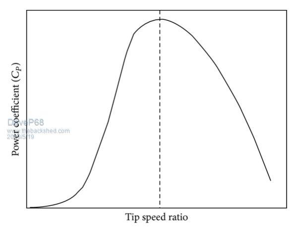

Thought it was 48V which means you are stalling the blades at cut in due the 22 - 60 inverter trying to take too much power at low RPM.
The 22 - 60 VDC 1000 W grid tie inverters try to take about 20 - 25 W of power at start up.
I suspect the 45 to 90 VDC inverter you have on order will solve the problem you have.
The blades you have look like they have a tip speed ratio of around 7 to 7.5 at a guess. This means as they start turning want to operate at over 100 RPM in light winds 2.5 - 3 m/s.
Here is a TSR graph to illustrait my point

Last wednesday, as we had some great wind speeds I was also able to observe the mechanical yawing protection during some gusts.
In terms of mounting errors, I read about those before and paid very close attention when assembling the rotor. I'm certain that it is built correctly. :)
The vendor told me that the rotor was balanced at the factory and thus the blades were labeled. Yet I still detected some wobbleing during spin up.
So since I will take down the generator today anyway in order to find and fix that squeaking I will also check the rotor for any imbalance.

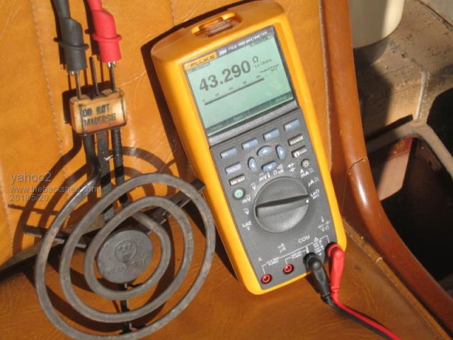

Since this is a DIY forum we would prefer to see dump loads built out of scrap.
old heaters, stove and oven elements, floodlights or even heavy gauge soft tie wire strung between insulators. You can run a fan to dissipate heat. The dump load you buy is only nichrome wire on an insulator cut to a specific length to get a certain resistance. Almost every heater element is made from nichrome wire.
You just need enough of them in parallel to handle 3200+ watts and finish up with the right resistance.
roughly 60 volts and 53 amps that's going to be 1.1-1.2 ohms
38 of these, OK maybe not, that only 90 watts each at 60 volts.
electrical laws
but you get the general idea, 3.2 kw is a lot of wind turbine to handle in a storm.
(90v x 90v) / 43 ohm is 190 watts.
16 units if it is switching on at 90 volts and 35 ampsEdited by yahoo2 2018-05-21

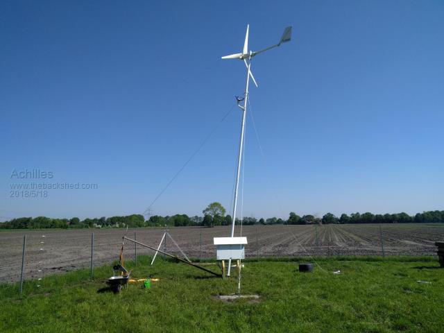

By the way, I performed maintenance on the turbine yesterday.
The Blades where offset by up to 2cm (.8 inches) which I corrected to be within 2mm (.08 inches). It looks like this solved my wobble during spinup problem that I completely forgot to mention.
The Squeaking was fixed by simply applying some good old WD-40 to where the shaft leads into the generator, rotated it a few times in both directions and tadaa: Silence!

I was able to test a 45-90V inverter and it works much better.
The turbine spins up to much more rpm than with the 22-60v inverters and even in slow wind conditions (like 3m/s).
It then reaches 40-45 volts at which point the inverter kicks in.
Apperently the 22-60V inverter put too much load on the generator too early.
Since a single 2000W inverter cannot handly this turbine, I'm getting 2 of those and run them in parallel. I will adjust the current curve so that each inverter draws only half the current.
I tested this config with my 22-60V inverters and it does work properly.

if your wire is soft enough you can measure the resistance of a length of wire, fold in half stick the two cut ends in a vice and twist the folded end to halve the resistance if it needs to be bigger.
when I used to put up turbines it would either be dead calm for days or blowin its arse off. I'm sure i was jinxed.

  Quote  So they can now be programmed?
They can, check the picture.
But not the start current which was the issue with the low voltage version of this inverter.
Once the 45-90V model starts up it actually works all the way down to 40V which is very nice in low wind speeds.
I'm curious about how well the dump is going to work.
I will post some pictures once I have built the resistors.
I will also let you know how well 2 of those work in a stacked setup.

The 2nd inverter arrived today and after installing it I observed that the blades did not speed up as much as it was the case with a single inverter. (I modified the voltage points to split the current evenly between the 2, modification is only possible from 48V upwards though.)
I will wait and observe before I modify the hardware though.
Today wasn't particulary windy.
