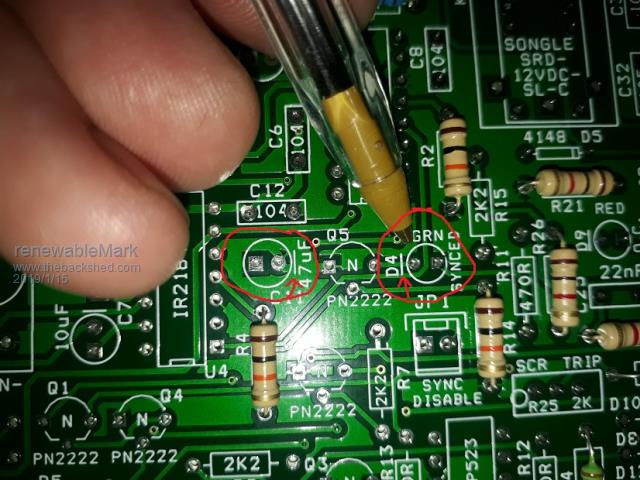

Hey guys, just started assembling my nano control board.
Just want to confirm the silkscreen markings, does the line here mean the negative side?
Cheers Caveman Mark

Yes, it is the cathode of the LED. If you have a DMM with diode test function, placing the negative probe of the DMM at the cathode and positive probe at the other LED pin (anode) will show voltage across the LED and most of the time will also make the LED light up.

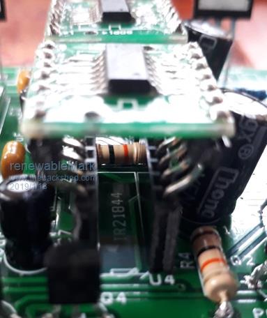

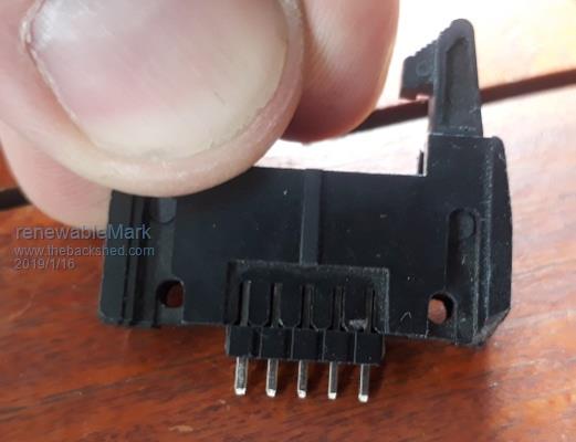

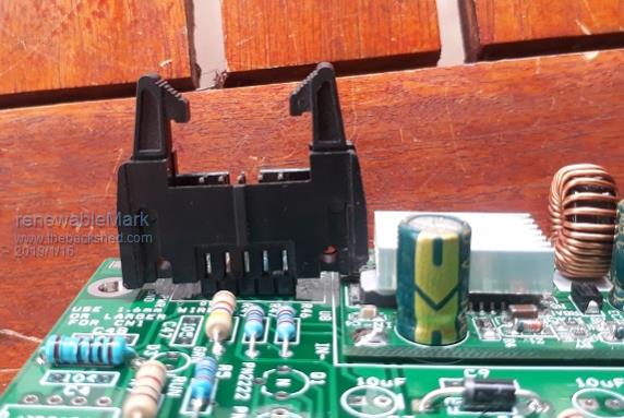

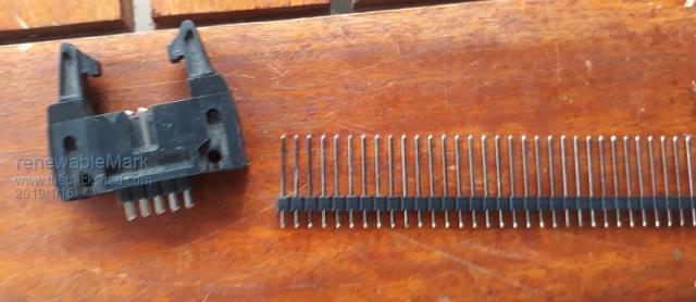

Had a little space issue, the idc connector is a tad close to the power supply board, so I pulled the pins from the idc and replaced them with 19mm long header pins, that rose it up a tad, then gave it a little shave on one corner and soldered it in slightly crooked. Now it all fits in nicely.
Mulver and John, I have included some of the long pins with your boards to do this alter, went in the mail today.

  renewableMark said   ....Had a little space issue, the idc connector is a tad close to the power supply board, so I pulled the pins from the idc and replaced them with 19mm long header pins, that rose it up a tad, then gave it a little shave on one corner and soldered it in slightly crooked. Now it all fits in nicely.
Oops.
I used OST 302-S101 connector to make the footprint for J1 (spec. attached)2019-01-17_011157_302-SXX1.pdf
Sorry about that.

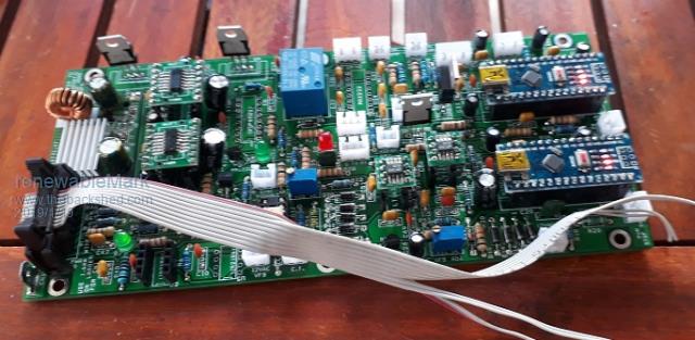

All done.
Sourcing the dip pinned chips was a bit hard so ended up making some smd adaptors using the long header pins.
Edited by renewableMark 2019-01-19

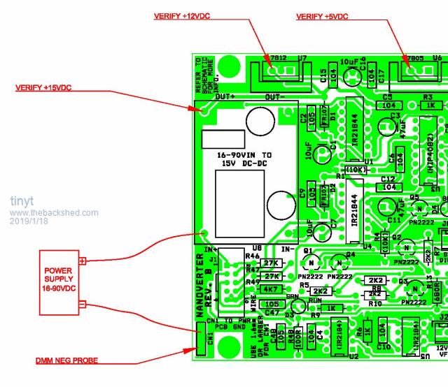

tinyt
Joined: 12/11/2017
Posts: 564
Posted: 12:49am 18 Jan 2019
Nicely done.
As a precaution, prior to first power on, I would remove all socketed ICs, then apply power and measure for correct voltage outputs of the dc-dc, the 7812, and 7805 linear regulators. If all good, install one IC at a time and remeasure the output voltage of the linear regulators after every IC install.Edited by tinyt 2019-01-19

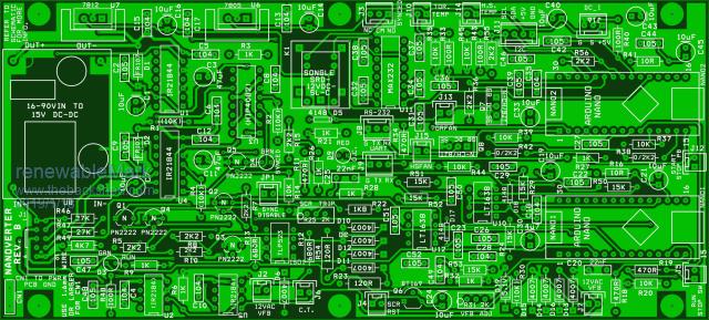

Hey Tinyt, or Poida, I was just checking the PDF schematic again, R23 and R54, it shows to install one only.
What is that for?
So with 7812 looking at the black side I should see 15v on the left pin and 12v on the right pin (ground middle)

Mark, this is a good thing you have done: start a new thread for the build (and debug)
My view on R23 and R54 is one is loading the AC side of the diode bridge, the other loads the DC side. I would probably use the AC loading side since a current transformer needs a load. There might be situations when the CT will be unloaded if the DC side resistor is used. Correct me please readers if I am barking up the wrong tree.

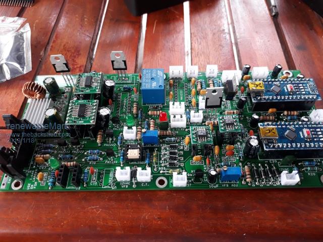

Thanks Poida, here is a pic of the board.
What is that for?..
This was discussed in poida's 'Various aspects of homebrew...' thread pages 43, 45 and 46.

Correct.
Maybe this will also help. Use a power supply with voltage output close to your battery bank. If your power supply shows load current reading, note the readings as each of the socketed ICs gets plugged in. Increase in current should be small. After all ICs are plugged in, do touch temperature test to the body of 7812 and 7805 every 5 minutes for maybe 30 minutes. Maybe heatsinks are not required on them.

Posted: 11:38pm 18 Jan 2019
Thanks Tinyt,
did that test, first with no chips, power supply was fine then the 7812 and 7812, tested fine.
Added the 21844 one at a time and voltages all ok, then the lt1638's one at a time and voltages still the same.
Then removed all chips and did the same test measuring mA.
Each addition of a chip rose the current slightly, when all 4 were in place the current was 11 mA, then when adding the two arduino's it rose to 53mA.
No noticeable temp on the 7812, 7805 is slightly warm to the touch after a while.
Will still put heatsinks on them though.
Prob not enough room for this
this should be fine.
So far so good.
No smoke!!!
BTW green LED bottom left was dimly lit.Edited by renewableMark 2019-01-20

Posted: 12:13am 19 Jan 2019
  renewableMark said  ....So far so good.
No smoke!!!
Excellent!
That green LED is being driven by nano1 pin 15. Try removing nano1 from it's socket and see if it turns off. I don't know what code is preloaded in the arduino nano when purchased.
