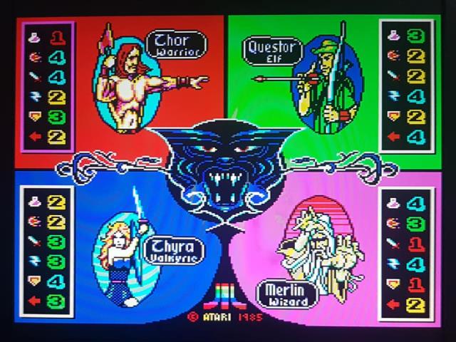

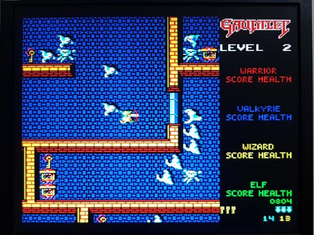

To challenge me to force the full potential of a Colour Maximite and the PSGLib, dealing with the eight color limitation, pure basic and limited sprite architecture, I'm porting one of my favorite games: Gauntlet.
I'm starting making all things based on the NES version, which is the one i had the most contact in adolescence and still think it is the most fun and with better maps, wherever, I began to see in more depth the graphics of the version of the Master System and some screens of other versions and so I decided to make a nice mix in this port, where it will have:
- Master System version based sprites
- Title screen, maps and NES musics (converted to PSG)
- Some arcade voices
- Good sound effects, voices and openning music even without a sound card (the new PSGLib supports PWM Sound emulating a PSG)
- Sprites and screens making the most of the 8 colors, all done in pixel art without rough conversions
- Map editor
Well, obviously some technical limitations was found, and by now it's too hard to work around, and MAYBE it stays as a "limited features" from this port:
- All moves and scroll are in 8x8 pixels blocks
- Main character moves in 8 directions but sprites are for only 4 directions (to save RAM). At least the shots have all the 8 directions sprites glory.
- Some enemies have all sprites and some are cut in the same way of the main character, based in the NES Gauntlet II port.
- Only two frames per angle, instead 3 like the SMS version
- Unstable frame rate around 20 fps. Note: It's may seen little, but gives a good result due to the movements every 8 pixels.
- FPS can drop severely when the screen fills with enemies
- When turn on the music, the performance can be hurt (waiting to the MMBasic 5 and C Functions in the CMM)
- Digital sounds directly from SD card, but only in 8 bits, 4Khz. It's almost acceptable, since the arcade voices contribute to the retro atmosphere
- After I finish everything... Will I be able to allow at least 2 players without hurting the game speed a lot??
Of course there are many bugs to be fixed and optimizations need to be done, but now the main engine I consider almost ready.
Finally, soon the Colour Maximite will have a Gauntlet port (or not too soon enough).

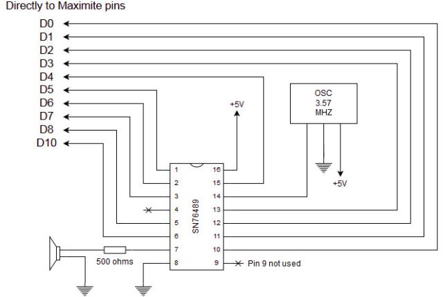

Another impressive job Mauro!
By the way - you were going to post a schematic of your sound card. A hand drawn sketch would be fine.

  Turbo46 said   Another impressive job Mauro!
Bill
It's not drawed by me, but I believe it's correct:
Anyway, inside the PSGLib / Shadow of The Beast Demo has the specifications of the soundcard:
https://www.casadosnerds.com.br/maximite/PSGLIB.zip
With it you can have some options:
- Only one SN76489 (all my softwares support this mode)
- 2 SN76489 for stereo
- 1 AY-3-8190 or YM2149 (with clock divide support in MStudio software, which I must release soon)
You can build it inside the CMM using the Arduino connector in a little board. The bus I made is not necessary (that board that appears in some photos I've posted), I built it just to make my prototypes easier to implement and test.

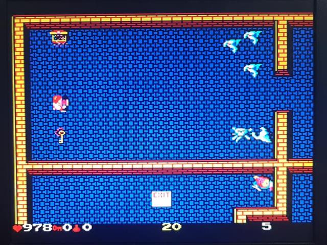

New map editor (inside the CdN Media Studio):
The loading screen was remade with manual dithering and some pixel art changes to better details in low resolution (ex.: Faces, hands etc).Edited by MauroXavier 2019-05-20

One more update!
Game panel like the arcade version, with the advantage of a better scroll speed up using a smaller tile grid.
This weekend I will publish the source of CdN Media Studio (to edit maps) and the current alpha development version of Gauntlet.
Stay tuned!

Posted: 06:25pm 30 Jun 2019
  MauroXavier said  It's not drawed by me, but I believe it's correct:
It's drawed by me. Under careful guidance of MauroXavier. :)
I'm glad it turned out to be useful for others.
By the way it is schematic for only one SN76489 (not stereo).
And in place of speaker you should put amplifier+speaker or headphones, bacause output signal of SN76489 is very low.
Yesterday I assembled this schematic on protoboard, and I confirm it works!

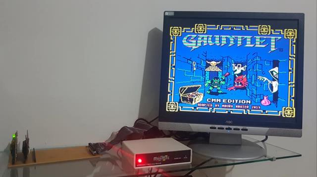

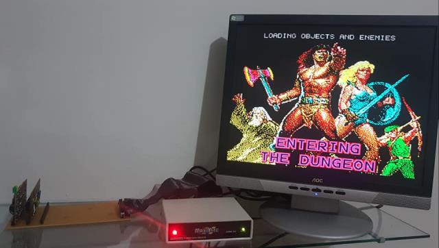

MauroXavier
Joined: 06/03/2016
Location: Brazil
Posts: 307
Posted: 07:43pm 01 Jul 2019
What a beautifull piece of protoboard ;)
Here I'm mixing the sound out from Colour Maximite directly in a amplifier.
I'm very glad that you are using it, I have so many things to show but was a little dissapointed because doesn't had some feedback from users, with this appears that nobody is interessed in this.
But with your perseverance, I'm happy again to continue the project!
I will publish soon other videos and more recent codes with heavy optimizations and with a ton of good PSG musics.
Thanks a lot by your feedback!
