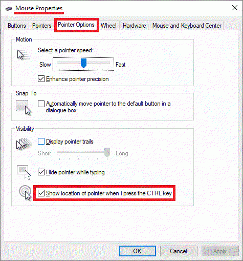

you can enable mouse pointer location in windows here:
as far as i am aware, this works in all versions of windows from XP upwards. when enabled, just tap the ctrl key to cause a circle to flash for half a second around the mouse pointer.

Mouse pointer location information, I recognise the information.
Got stuck again with the pointer focus. ie can't understand why I can't see characters in GFXterm, the cursor is blinking so it must be active?? No I realise what it is that throws me off track. The blinking cursor, that it blinks does not mean the mouse has focus. That is a tricky one.  ZZzzz.... rime here

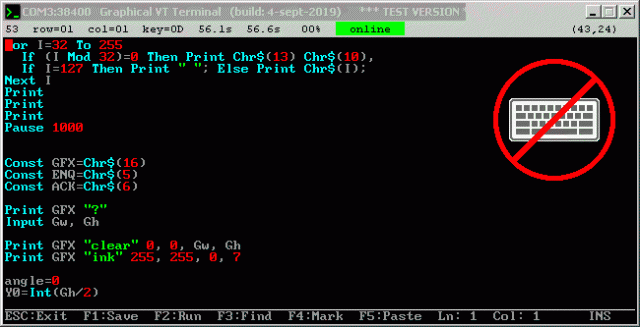

Posts: 2552
Posted: 02:11pm 03 Sep 2019
hi,
   give this test version a try:
GFXterm test (2019-09-04).zip
it shows a very 'unsubtle' icon on the screen when the application does not have focus:

Thank you very much, was jus closing for the night when I noticed the new version. I was a bit absentminded and just downloaded the zip file, forgot to switch off AVAST before starting up, the result it started up for about 5 seconds before AVAST woke of the the fact that this was a 'very rare file' and snatched it and sent it for testing.

Well sleeping turned a few gearwheels in my brain.  I think I know the answer to my problems above.  The above statements need to be used inside a program. So that should be the next thing I look at.
The focus alert absolutely great for me. Even before I get around to hit the command line I know if the focus is away or already in place, a real treat.
