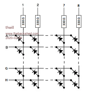

Hi folks,
Thanks for the answers, my takeaway is that "Yes, you can cook your CMM by turning on too many LEDs simultaneously."
Thanks for everyone offering "off the shelf" suggestions including Mick's generous PCB offer, but the soldering practice of building the matrix is a big part of this <laughs>project</laughs>. I'm happy to experiment and cook discrete LEDs and transistors which are basically "free", I just don't want to learn the hard-way how to cook £70 worth of CMM.
Just to clarify (as there did seem to be some confusion, perhaps only in my mind, over what I was trying to source and sink).
<HowToSuckEggs>
This diagram is what I was proposing:
With pins 1-8 and A-H connected directly to 16 of the 20 signal pins of the CMM GPIO connector.
I understand I should have no problem illuminating a single LED by setting one of the source pins (1-8) high and the others low, and a corresponding sink pin (A-H) low and the others high. By traversing the matrix, never illuminating more than one LED at a time and relying on persistence of vision I should then be able to display an image.
</HowToSuckEggs>
My concern is that if I deliberately or accidentally set all the source pins high and only one of the sink pins low, i.e. try to illuminate all the LEDs in a row am I going to "cook" the sink pin by trying to sink ~80 mA into it? Or is there something that is going to save me?
Ditto what is going to happen if I try to light all the LEDs in a single column? Am I then going to source too much from the corresponding source pin?
If I want to get around any such problems I'm assuming I can just have each pin drive a transistor to switch between sourcing 5V or sinking to ground directly. Or am I still likely to hit limits on how much current I can source/sink through a transistor (bc547 or 2n2222).
Thanks again,

Just to clarify Warpspeed's explanation above. For the multiplexing you would set pin '1' high and any or all of pins 'A' to 'H' low. This means that only one LED on pins 'A' to 'H' would light but pin '1' could be supplying anything from zero to eight LEDs. Then you set pin '1' low and pin '2' high and set pins 'A' to 'H' appropriately and so on until you start again on pin '1'.
This means that pins '1' to '8' will need drivers for the multiple LEDs but pins 'A' to 'H' will be OK because they are only feeding one LED. You will need a PNP transistor like a BC557 or similar. The matrix will take about 40mA with all LEDs on so it may be wise to use an external 3.3 volt supply to supply it at least for extended use.
As PeterB says the micromites are pretty tough mites so I would expect the Maximite to put up with a bit of abuse for a short time if things go wrong.
Bill

  Turbo46 said  Just to clarify Warpspeed's explanation above. For the multiplexing you would set pin '1' high and any or all of pins 'A' to 'H' low. This means that only one LED on pins 'A' to 'H' would light but pin '1' could be supplying anything from zero to eight LEDs. Then you set pin '1' low and pin '2' high and set pins 'A' to 'H' appropriately and so on until you start again on pin '1'.
This means that pins '1' to '8' will need drivers for the multiple LEDs but pins 'A' to 'H' will be OK because they are only feeding one LED ...
By "feeding" in this case you mean sinking the current from?
  Turbo46 said  ... You will need a PNP transistor like a BC557 or similar ...
Why PNP rather than NPN? I'm guessing because you'd rather drive the pin of the matrix with a low from the CMM instead of a high? Why is this significant?
  Turbo46 said  ... The matrix will take about 40mA with all LEDs on ...
Presumably you mean all the LEDs in a single column, as opposed to all 64 LEDs ?
  Turbo46 said  ... so it may be wise to use an external 3.3 volt supply to supply it at least for extended use ...
Why is the 3 or 5V line from the GPIO insufficient?

'Feeding' was a bad choice of words. You will be sinking current from the LED anode.
You could use an NPN transistor to drive the rows OR a PNP to drive the columns. Just reverse the sense of my description above - set one row to zero at a time and any of the columns to logic '1' then move on to the next. Remember that the transistor will invert the sense of the logic output.
The idea of multiplexing is that only one column (or row) is enabled at any one time and any or all of the row (or column) LEDS are enabled at the same time. So yes, there should only be up to eight LEDs in one column (or row) on at any one time.
I think the 3.3 volts from the GPIO should be sufficient but I know the 5 volt regulator gets a little warm. The logic level of the Maximite outputs are 0-3.3 volts so you cannot use the 5 volts without some form of level shifting.
There is an issue sinking or sourcing too much current from a single pin. As Geoff says you may damage the chip. I suspect it should survive a short term overload.
I suggest you proceed slowly. Build the LED matrix and thoroughly test it with clip leads before you connect it to the Maximite. Then experiment with the Maximite.

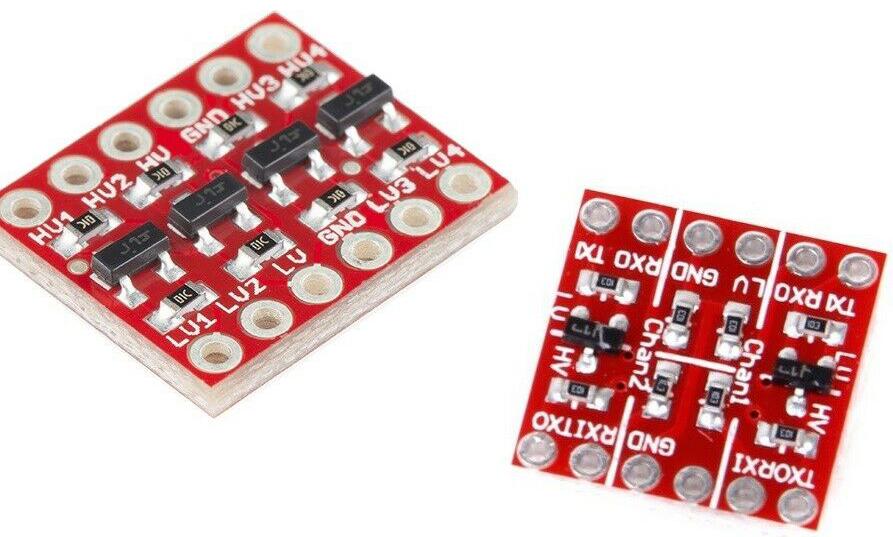

I havent tried that this works but one of those cheap level converters such as this one might work with the same voltage for LV and HV but if not then you can design your LEDs around 5V and use them.
They are dirt cheap, this 4 way (first I found on eBay so they may be much cheaper were about $3AUea for a 4 channel, I have seen an 8 channel and I think a 16 cannel out there as well.

G'Day Mick
Those things are interesting. The 3.3V input connects to the S of a FET. The FET G goes to 3.3V and the D goes to 5V through a resistor. If the input is 3.3V the FET is off and the output is pulled to 5V. If the input is 0V the FET is turned on and the output is 0V. It is a clever way to convert from 3.3 to 5 but the output is not driven high just pulled.
There are CMOS 3.3V buffers but the output is only a few mA.
I have been thinking of a 330 ohm R connrcted to the input of a CMOS buffer. The input to the buffer becomes the MM input and the buffer output becomes the MM output.
The buffer input could be used as a high impedance output.
