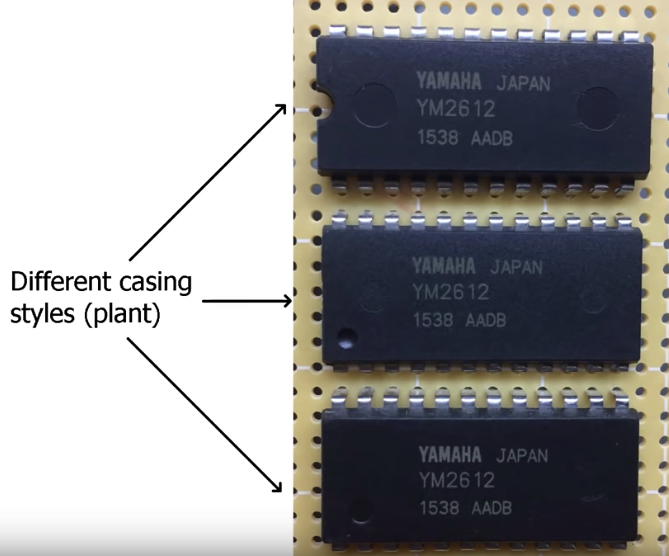

I have no problem with recycling - we should all be doing it, but this vid shows the scale of counterfeiting that goes on where components are recovered from old kit, "recycled" and sold as new stock... in itself that is bad enough but the chips often receive an upgrade in the process and often times they don't even care about the chip so long as its got the right package and pins... You want a 6116 2Kx8 static RAM? You could end up with a 16 channel analogue multiplexer in the same package badged up to look like a 6116.
Check this still from the vid:
three IC's. Identical part number, identical date code, identical batch - DIFFERENT CASINGS this absolutely cannot happen! and the sellers don't care they want your $$$ and will stoop to any cheat necessary to get them.
I know it's not a new phenomenon but it never occurred that a 6116 might be a 4534. You might get lucky and get what you want but new $ for old? and maybe "upcycled" to mil-spec or different speed rating? cheeky basts!
"enjoy" https://youtu.be/k72SFBOZ_lw

Very interesting link, confirming that this sort of thing does indeed happen.

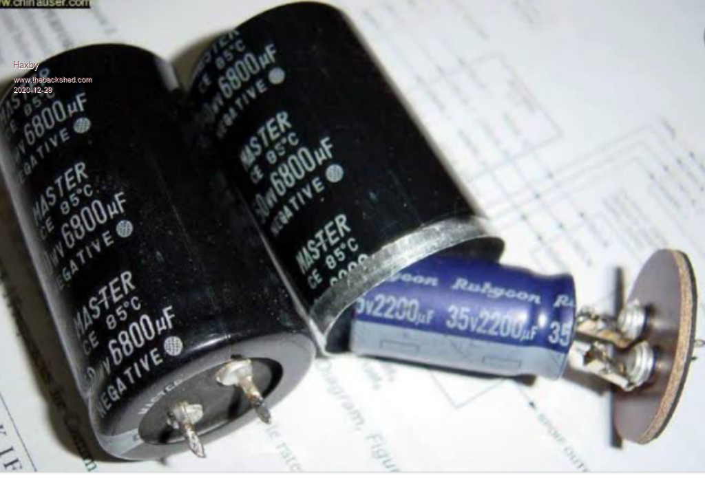

Reminds me of this gem:

  Haxby said  Reminds me of this gem:
    The dirty basts!  Anything for a buck.
