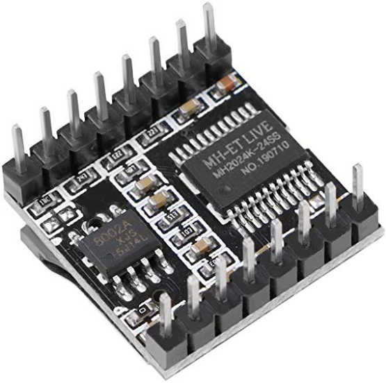

Hi all.
I've been using the DFPlayer Mini for some time with no problems with MM Basic and a while ago got some MP3-TF-16P ones from Aliexpress. Both units look the same but have different chips. The MP3-TF-16P uses a MH2024K chip, while the DFPlayer Mini uses a YX5200 chip.
Both unit work fine in standalone mode, connecting pin 9 to ground will make the unit play, but only the DFPlayer Mini will work using the serial port.
I've searched the internet and found a few people with the same problem.
Is there a workaround for this chip or is it fake and just cannot be used with the serial port?
Thanks in advance.

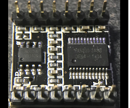

Some of these modules marked as MP3-TF-16P have the YX5200 chip and work ok. It's the ones that have the MH2024K chip that seems to have the problem working with the serial port.
Thanks. Dave.

Buy only DFplayer modules with the YX5200 or YX5300 IC.
These ones seem to work just fine with the standard commands.
The MH2024K chip seems to use a different serial protocol, and details are very hard to find.

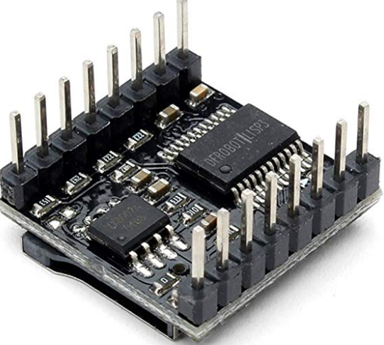

Some pic's of the boards reviewed.
From sellers images so who knows good/bad/other wise
I hope this information gleamed from others help here.

It would seem that the authentic YX5200 based DFplayer Mini......is now being cloned.
....just like anything else that becomes popular, such as the HC12 module, and we all remember THAT fiasco....
All the ones I have are marked as YX5200, and they work.
You CAN buy just the YX5200 chip, so you could always pull the MH2024, and replace it with a YX5200 which should then restore the module to working status.
YX5200 chip link...
Weather that is a waste of effort for a $2 module, who can say.  If you build a project around the DFplayer Mini though, and the clones won't work, then it probably is worth it if you don't have another one handy.
The EARLIER version of the MP3-TF-16P did indeed have the 5200 chip on them, and they work.  I have ten of those here, and they work, but I think the later version of this module they swapped to the chip that does not want to work.

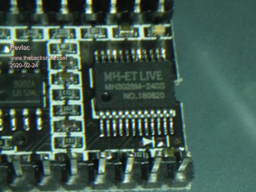

After reading this and the info about the fakes, thought I would check the ones I bought and saw this in the chip MH-ET LIVE MH3028M-24SS.
So now I'm confused.
Bought these for a model railway project to add sound to some parts of the layout, was thinking about using it for loco sound loops but that would be too limited, so on to the next idea for that.
Have not seen another of these DFPlayers with this MH3028M-24SS chip.
Cheers Aaron

@ Revlac(& also cosmic frog): Yes, I would be interested if the 3028 responds to serial.  It is possible that 2028 is buttons only, and the 3038 might be serial and buttons.  Who can say.  I cannot find any useful information about the MH series.

Have not tried it yet, its in the endless list of things to do, will update when I get it together.
Already have most of the parts and there is a Nano somewhere on the table and will give it a run
Got this one from Ebay and the seller no longer stocks them...whats new.
I was going to ask if there are any other module that has similar functions to these?
When I look up MH3028M There are pictures of a different module, eg. Aideepen YX5300 UART Control Serial MP3 Music Player Module for Arduino/AVR/ARM/PIC
It looks more serial orientated, so I'm thinking it would work.

I can confirm the module labelled MP3-TF-18P with a MH3028M-24SS chip does work with the serial interface.  I have another module labelled DFPlayer-Mini with a chip marked as AA1752CJ3J13.1-94 and that also works with a serial interface (both 9600, 8n1).
Gerry

It would seem then, that perhaps the 2028 chip is simply button-only, and no serial support?

Tested using a nano and DFPlayerMini_Fast-master, the DFPlayer with this MH3028M-24SS chip works nicely with serial, the wav or mp3 files, last one saved to the micro SD was the first one to play.
Also it was a bit fussy about the file names, it refused to play 01 (ended up corrupting the file) but 001 or was it 0001 works fine.
There was some explanation about this in the DFPlayerMini_Fast file.
Obviously I'm new to this, but I have it the player doing what I want it to. eg. play first track then loop second track.
perhaps the 2028 chip wants the correct file names.

The MH2024K chip = Will NOT work with serial
The YX5200 chip = Works with serial BUT has problems with folder "00" and "99"
The YX5300 chip = Works as expected

Some observations about the MH2024K-24SS modules that I received:
1) The modules look very similar to the YX5200 module that I have (the component values and placement seem similar).
2) The indicator LED on these modules behaves differently.
      a) on the MH2024K modules, the LED is always off unless the module is playing, in which case the LED turns on brightly
      b) on the YX5200 modules, the LED is always dim unless the module is playing, in which case the LED turns on brightly.
3) The series resistor between PIC TX and module RX prevents successful serial communication.  The MH2024K module serial communication does work successfully if I short out that series resistor, and I can get the module to play my tracks.
4) The audio from this module has high-frequency digital noise on some tracks, always toward the beginning of the recording (for the first 5 seconds of a 10-second recording, for example). The noise sounds like mid-band glitching, followed by bursts of low-frequency noise. The noise does NOT seem to be correlated to:
