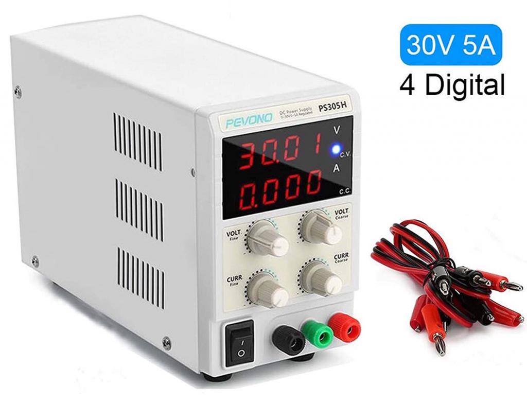

Posted: 11:42pm 08 May 2020
So why don't you just buy or make yourself a charger to your own specifications ?
Fully adjustable voltage and current limited bench power supplies are readily available, and the Chinese ones are not that expensive.

Warpspeed-A power supply is pretty simple stuff and of course I have and could make many.
I have an old AT supply and another later Dell that will put out whatever I want . A small device from ebay would make it adjustable in voltage and in amperage. The supply you show I have but they do not show the correct voltage when in a charging situation also.
Revlac-I have a camera battery too that is probably 10 years old and is still good. Its probably only been charged 20 times in its lifetime and is NiMh. I'm looking at batteries that are charged twice a week like laptops , phones etc. However the being adjustable point is new. I had not considered that the charger might have such an adjustment and thats worth looking for. First charge could be full and subsequent charges less!
That's not the question nor is it the answer and this thread is simply derailed by the irrelevant posts now.
The question remains how to stop such a supply at a point desired?
Say I want to stop charging at 4.1 Volts . The charger is set for 1 amp at 4.2v which is where it is supposed to be for that cell . How would I disconnect it when the plate voltage gets to  4.1 vols? Could I build another circuit to put inline that would sense the cell plate voltage and cut supply?

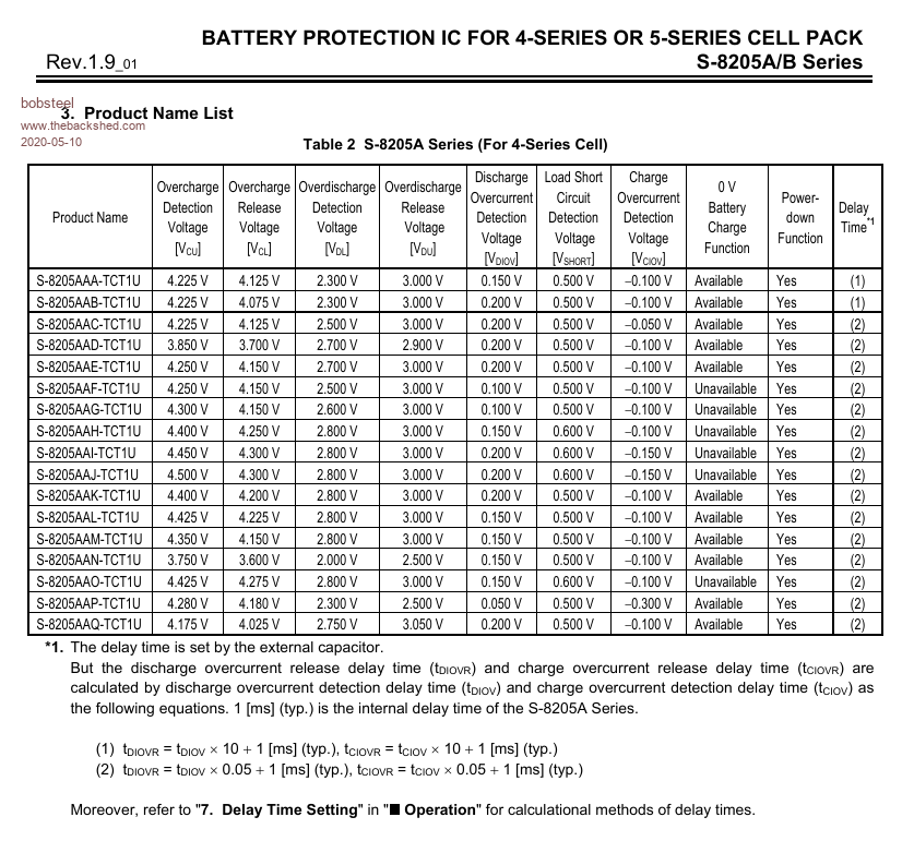

I'd be interested in finding one with some sort of adjustment of the actual charging chip used . IE using a TP4056 designed to cut off at 4.2v exactly but can be adjusted to 4.1v cut off.
People should understand too that LiPo cells are 3.7v nominal but spend most of their charge time at about 3.9v . Its not linea as I understand it. They can be charged easily and safely with a 5v input limiting the current to a quarter of their capacity without damage but when the plates get to 4.2v they are damaged.
A circuit example
So there are many chips available for various cut off voltages but I don't see how I can set them to cut off a bit lower ?
