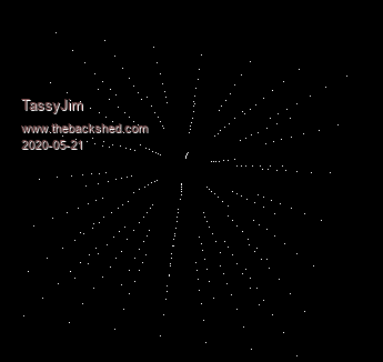

During the testing of the CMM2, I needed a few short programs designed to demonstrate some of the features.
This rotating cube program started life in a QuickBasic forum.
To change it to MMBasic the only changes needed were PSET changed to PIXEL and  BOX used to erase the frames.
I then used PAGE to remove the ficker and a timer so you can compare the different graphic MODEs
A couple of tweaks to the formula shaved about 10mS of each frame.
 ' cube rotator
 ' From a 19 liner by Entropy, shrinked by Antoni Gual
 ' for Rel's 9 LINER contest at QBASICNEWS.COM  1/2003
 ' translated to MMBasic for the CMM2 by TassyJim May 2020
 DIM INTEGER x,y,z
 DIM FLOAT r,x1,y1
 DIM FLOAT COSr,SINr,denom,xyz
 DIM INTEGER cx = MM.HRES/2  'scale things for different display resolution
 DIM INTEGER cy = MM.VRES/2
 DIM INTEGER b = cx/2
 DIM INTEGER s = cx*3/4
 CLS
 DO
   TIMER = 0
   PAGE WRITE 1
   'cls
   BOX b,cy-b,cx,cx,1,0,0 ' 1mS quicker than CLS
   r = (r + .01745) + 6.283185 * (r >= 6.283185)
   COSr = COS(r)
   SINr = SIN(r)
   FOR x = -30 TO 30 STEP 10
     FOR y = -30 TO 30 STEP 10
       FOR z = -30 TO 30 STEP 10
         denom = x*SINr+(z*COSr-y*SINr)*COSr+100 ' saves about 4.5mS
         xyz = x*COSr-(z*COSr-y*SINr)*SINr       ' this one saves 3mS
         x1 =(xyz*COSr+(y*COSr+z*SINr)*SINr)/denom
         y1 =((y*COSr+z*SINr)*COSr-xyz*SINr)/denom
         PIXEL (s * x1 + cx), (s * y1 + cy), RGB(WHITE)
       NEXT z
     NEXT y
   NEXT x
   PAGE WRITE 0
   BLIT b,cy-b, b,cy-b,cx,cx ,1
   TEXT cx,cy+b,STR$(TIMER)+"mS",cm
 LOOP UNTIL INKEY$ <>""
 ' formula before speed refinements
 ' x1 =((x*COS(r)-(z*COS(r)-y*SIN(r))*SIN(r))*COS(r)+(y*COS(r)+z*SIN(r))*SIN(r))/(x*SIN(r)+(z*COS(r)-y*SIN(r))*COS(r)+100)
 ' y1 =((y*COS(r)+z*SIN(r))*COS(r)-(x*COS(r)-(z*COS(r)-y*SIN(r))*SIN(r))*SIN(r))/(x*SIN(r)+(z*COS(r)-y*SIN(r))*COS(r)+100)

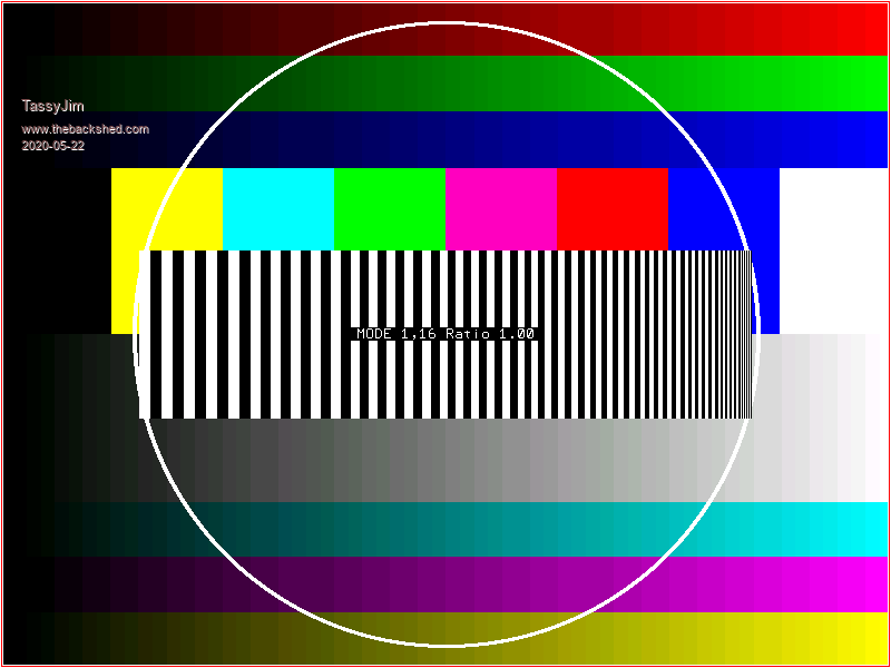

ColourBars is a short program to test all available graphics modes.
It can be tricky to set up a monitor to display all modes without trimming off pixels from one edge in some modes.
This program helps.
It also lets you find the optimum aspect ratio needed for the CIRCLE command. This will vary between monitors.
colourBars.zip

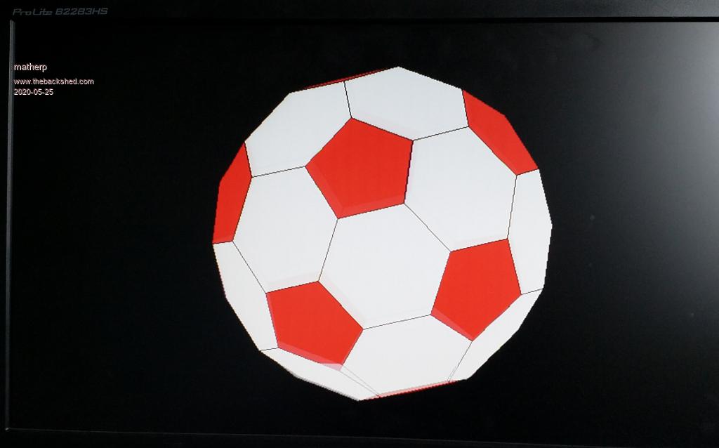

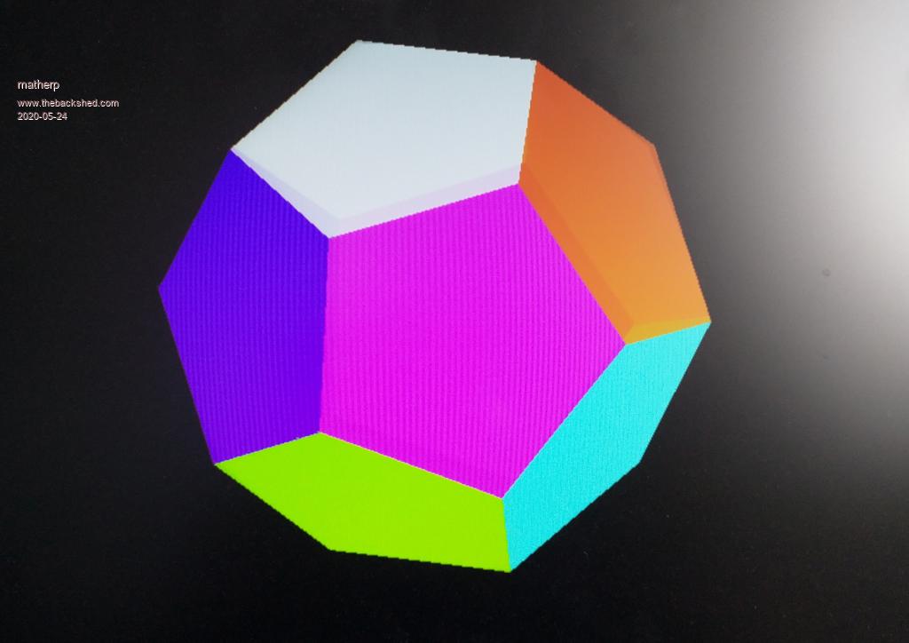

Posts: 11881
Posted: 02:16pm 23 May 2020
Rotating Dodecahedron
Check the video
option explicit
option default none
page write 1
const edgelength=200 'set the length of the verticies of the dodecahedron
const zlocation=1000 'how far is the center of the dodecahedron away from us
const viewplane=800 'how far is the viewplane away from us
dim float xarr(4),yarr(4)
dim float phi=(1+sqr(5))/2 ' golden ratio
dim float x,y,x1,y1,z1
dim integer col(11), sortorder(11)
dim float q1(4),depth(11),v(4), vout(4)
' data for location of verticies for dodecahedron of edge length 2
data phi,phi,phi
data phi,phi,-phi
data phi,-phi,phi
data -phi,phi,phi
data -phi,-phi,phi
data -phi,phi,-phi
data phi,-phi,-phi
data -phi,-phi,-phi
data 0,-(phi^2),1
data 0,phi^2,1
data 0,-(phi^2),-1
data 0,phi^2,-1
data phi^2,1,0
data -(phi^2),1,0
data phi^2,-1,0
data -(phi^2),-1,0
data 1,0,phi^2
data 1,0,-(phi^2)
data -1,0,phi^2
data -1,0,-(phi^2)
dim float dodec(2,19), ndodec(3,19)
dim integer i,j,k
' read in the coordinates of the verticies and scale
for j=0 to 19
 for i=0 to 2
   read dodec(i,j)
   dodec(i,j)=dodec(i,j)*edgelength/2
 next i
next j
'convert coordinates to normalised form
for i=0 to 19
 x1=dodec(0,i): y1=dodec(1,i): z1=dodec(2,i)
 create_vector(x1,y1,z1,v())
 ndodec(0,i)=v(2): ndodec(1,i)=v(3): ndodec(2,i)=v(4): ndodec(3,i)=v(0)
next i
'create a quarternion to rotate 5 degrees about a chosen axis
'play with the x,y,z vector which is the sxis of rotation
create_normalised_quaternion(5,1,0.5,0.25,q1())
'array to hold verticies for each face and its colour
dim integer faces(4,11)
data 10,6,17,19,7,rgb(red)
data 7,19,5,13,15,rgb(blue)
data 6,14,12,1,17,rgb(yellow)
data 19,17,1,11,5,rgb(green)
data 8,2,16,18,4,rgb(magenta)
data 2,14,12,0,16,rgb(cyan)
data 18,16,0,9,3,rgb(brown)
data 4,18,3,13,15,rgb(white)
data 12,0,9,11,1,rgb(gray)
data 13,3,9,11,5,rgb(255,0,128)
data 8,4,15,7,10,rgb(128,0,255)
data 8,2,14,6,10,rgb(128,255,0)
for j=0 to 11
 for i=0 to 4
   read faces(i,j)
 next i
 read col(j)
next j
do
cls
for i=0 to 19 'rotate coordinates
 v(2)=ndodec(0,i): v(3)=ndodec(1,i): v(4)=ndodec(2,i): v(0)=ndodec(3,i): v(1)=0
 rotate_vector(vout(),v(),q1())
 ndodec(0,i)=vout(2): ndodec(1,i)=vout(3): ndodec(2,i)=vout(4): ndodec(3,i)=vout(0)
next i
' Now see which faces are furthest away by adding up the Z coordinates
for i=0 to 11
 depth(i)=0
 sortorder(i)=i
 for j=0 to 4
  depth(i)=depth(i)+ndodec(2,faces(j,i))
 next j
next i
sort depth(),sortorder()
for k=0 to 11
 i=sortorder(11-k) 'get the index to the faces in order of nearest last
 for j=0 to 4
  xarr(j)=ndodec(0,faces(j,i))*viewplane/(ndodec(2,faces(j,i))+zlocation)*ndodec(3,faces(j,i))+MM.HRES/2
  yarr(j)=ndodec(1,faces(j,i))*viewplane/(ndodec(2,faces(j,i))+zlocation)*ndodec(3,faces(j,i))+MM.VRES/2
 next j
 polygon 5,xarr(),yarr(),col(i),col(i)
next k

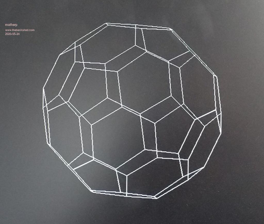

Rotating wire-frame bucky ball
Video

Posts: 11881
Posted: 06:16pm 24 May 2020
Last one of these more as a proof of the absolute performance of the CMM2 than anything useful - 60 vertices, 32 faces full perspective projection using Painter's algorithm to establish face order. Time for each iteration 85mSec despite a huge amount of maths being done
Watch the video
option explicit
option default none
mode 2
page write 1
const edgelength=100 'set the length of the verticies of the ticosahedron
const zlocation=1000 'how far is the center of the ticosahedron away from us
dim float x,y,d
dim float x1,y1,z1
' data for location of verticies for ticosahedron of edge length 2
data 0,1,3*phi
data 0,1,-3*phi
data 0,-1,3*phi
data 0,-1,-3*phi
data 1,3*phi,0
data 1,-3*phi,0
data -1,3*phi,0
data -1,-3*phi,0
data 3*phi,0,1
data 3*phi,0,-1
data -3*phi,0,1
data -3*phi,0,-1
data 2,(1+2*phi),phi
data 2,(1+2*phi),-phi
data 2,-(1+2*phi),phi
data 2,-(1+2*phi),-phi
data -2,(1+2*phi),phi
data -2,(1+2*phi),-phi
data -2,-(1+2*phi),phi
data -2,-(1+2*phi),-phi
data (1+2*phi),phi,2
data (1+2*phi),phi,-2
data (1+2*phi),-phi,2
data (1+2*phi),-phi,-2
data -(1+2*phi),phi,2
data -(1+2*phi),phi,-2
data -(1+2*phi),-phi,2
data -(1+2*phi),-phi,-2
data phi,2,(1+2*phi)
data phi,2,-(1+2*phi)
data phi,-2,(1+2*phi)
data phi,-2,-(1+2*phi)
data -phi,2,(1+2*phi)
data -phi,2,-(1+2*phi)
data -phi,-2,(1+2*phi)
data -phi,-2,-(1+2*phi)
data 1,(2+phi),2*phi
data 1,(2+phi),-2*phi
data 1,-(2+phi),2*phi
data 1,-(2+phi),-2*phi
data -1,(2+phi),2*phi
data -1,(2+phi),-2*phi
data -1,-(2+phi),2*phi
data -1,-(2+phi),-2*phi
data (2+phi),2*phi,1
data (2+phi),2*phi,-1
data (2+phi),-2*phi,1
data (2+phi),-2*phi,-1
data -(2+phi),2*phi,1
data -(2+phi),2*phi,-1
data -(2+phi),-2*phi,1
data -(2+phi),-2*phi,-1
data 2*phi,1,(2+phi)
data 2*phi,1,-(2+phi)
data 2*phi,-1,(2+phi)
data 2*phi,-1,-(2+phi)
data -2*phi,1,(2+phi)
data -2*phi,1,-(2+phi)
data -2*phi,-1,(2+phi)
data -2*phi,-1,-(2+phi)
' 12 faces with 5 sides
data 0,28,36,40,32
data 1,29,37,41,33
data 2,30,38,42,34
data 3,31,39,43,35
data 4,12,44,45,13
data 5,14,46,47,15
data 6,16,48,49,17
data 7,18,50,51,19
data 8,20,52,54,22
data 9,21,53,55,23
data 10,24,56,58,26
data 11,27,59,57,25
' 20 faces with 6 sides
data 0,2,34,58,56,32
data 0,2,30,54,52,28
data 1,3,31,55,53,29
data 1,3,35,59,57,33
data 4,6,17,41,37,13
data 4,6,16,40,36,12
data 5,7,19,43,39,15
data 5,7,18,42,38,14
data 8,9,23,47,46,22
data 8,9,21,45,44,20
data 10,11,27,51,50,26
data 10,11,25,49,48,24
data 12,44,20,52,28,36
data 13,45,21,53,29,37
data 14,46,22,54,30,38
data 15,47,23,55,31,39
data 16,48,24,56,32,40
data 17,49,25,57,33,41
data 18,50,26,58,34,42
data 19,51,27,59,35,43
dim float zpos(31),zsort(31)
dim float ticos(2,59), nticos(3,59)
dim integer i,j,k,l,m,n
dim integer xs(179),ys(179),xe(179),ye(179)
dim integer index(31),nnum(31)
for j=0 to 59
 for i=0 to 2
   read ticos(i,j)
   ticos(i,j)=ticos(i,j)*edgelength/2
 next i
next j
dim integer xarr(179),yarr(179)
dim integer nv(31)=(5,5,5,5,5,5,5,5,5,5,5,5,6,6,6,6,6,6,6,6,6,6,6,6,6,6,6,6,6,6,6,6)
dim integer np(31)=(0,1,2,3,4,5,6,7,8,9,10,11,0,1,2,3,4,5,6,7,8,9,10,11,12,13,14,15,16,17,18,19)
dim integer nd(31)
dim integer f5(4,11), f6(5,19)
dim integer ncol(31)
for j=0 to 11
 for i=0 to 4
   read f5(i,j)
 next i
next j
for j=0 to 19
 for i=0 to 5
   read f6(i,j)
 next i
next j
for i=0 to 59
 x1=ticos(0,i): y1=ticos(1,i): z1=ticos(2,i)
 nticos(0,i)=v(2): nticos(1,i)=v(3): nticos(2,i)=v(4): nticos(3,i)=v(0)
next i
'create a quarternion to rotate 4 degrees about a chosen axis
create_normalised_quaternion(4,1,0.5,0.25,q1())
do
 cls
 for i=0 to 59 'rotate coordinates
   v(2)=nticos(0,i): v(3)=nticos(1,i): v(4)=nticos(2,i): v(0)=nticos(3,i): v(1)=0
   nticos(0,i)=vout(2): nticos(1,i)=vout(3): nticos(2,i)=vout(4): nticos(3,i)=vout(0)
 next i
' average the z positions for the five sided faces
 for k=0 to 11
   zpos(k)=0
   for i=0 to 4
     zpos(k)=zpos(k)+nticos(2,f5(i,k))
   next i
   zpos(k)=zpos(k)/5
'    index(k)=k
 next k
'average the z positions for the 6 sided faces
 for k=12 to 31
   zpos(k)=0
   for i=0 to 5
     zpos(k)=zpos(k)+nticos(2,f6(i,k-12))
   next i
   zpos(k)=zpos(k)/6
'    index(k)=k
 next k
' sort the z positions
 sort zpos(),index()
 j=0:m=0
 for l=0 to 31
   k=index(l)
   m=np(k)
   nd(l)=nv(k)
   if nv(k)=5 then
     ncol(l)=rgb(red)
   else
     ncol(l)=rgb(white)
   endif
   for i=0 to nv(k)-1
     if nv(k)=5 then
       xarr(j)=nticos(0,f5(i,m))*viewplane/(nticos(2,f5(i,m))+zlocation)*nticos(3,f5(i,m))+MM.HRES/2
       yarr(j)=nticos(1,f5(i,m))*viewplane/(nticos(2,f5(i,m))+zlocation)*nticos(3,f5(i,m))+MM.VRES/2
     else
       xarr(j)=nticos(0,f6(i,m))*viewplane/(nticos(2,f6(i,m))+zlocation)*nticos(3,f6(i,m))+MM.HRES/2
       yarr(j)=nticos(1,f6(i,m))*viewplane/(nticos(2,f6(i,m))+zlocation)*nticos(3,f6(i,m))+MM.VRES/2
     endif
     j=j+1
   next i
 next l
 polygon nd(),xarr(),yarr(),rgb(black),ncol()
 page copy 1 to 0
loop
sub create_normalised_quaternion(theta as float,x as float,y as float,z as float,q() as float)
 local float radians = theta/180.0*PI
 local float sineterm= sin(radians!/2)
 q(1)=cos(radians/2)
 q(2)=x* sineterm
 q(3)=y* sineterm
 q(4)=z* sineterm
 q(0)=sqr(q!(1)*q(1) + q(2)*q(2) + q(3)*q(3) + q(4)*q(4)) 'calculate the magnitude
 q(1)=q(1)/q(0) 'create a normalised quaternion
 q(2)=q(2)/q(0)
 q(3)=q(3)/q(0)
 q(4)=q(4)/q(0)
 q(0)=1
end sub
sub invert_quaternion(n() as float,q() as float)
 n(0)=q(0)
 n(1)=q(1)
 n(2)=-q(2)
 n(3)=-q(3)
 n(4)=-q(4)
end sub
sub multiply_quaternion(n() as float,q1() as float,q2() as float)
 local float a1=q1(1),a2=q2(1),b1=q1(2),b2=q2(2),c1=q1(3),c2=q2(3),d1=q1(4),d2=q2(4)
 n(1)=a1*a2-b1*b2-c1*c2-d1*d2
 n(2)=a1*b2+b1*a2+c1*d2-d1*c2
 n(3)=a1*c2-b1*d2+c1*a2+d1*b2
 n(4)=a1*d2+b1*c2-c1*b2+d1*a2
 n(0)=q1(0)*q2(0)
end sub
sub create_vector(x as float,y as float ,z as float,v() as float)
 v(0)=sqr(x*x + y*y + z*z)
 v(1)=0
 v(2)=x/v(0)
 v(3)=y/v(0)
 v(4)=z/v(0)
end sub
sub rotate_vector(vnew() as float,v() as float,q() as float)
 local float n(4),iq(4)
 multiply_quaternion(n(),q(),v())
 invert_quaternion(iq(),q())
 multiply_quaternion(vnew(),n(),iq())
end sub

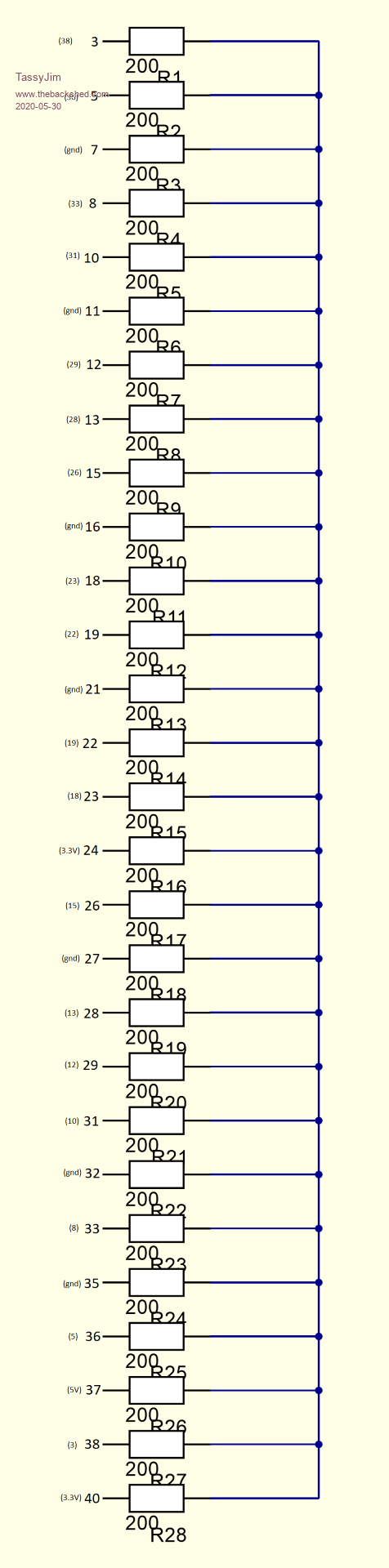

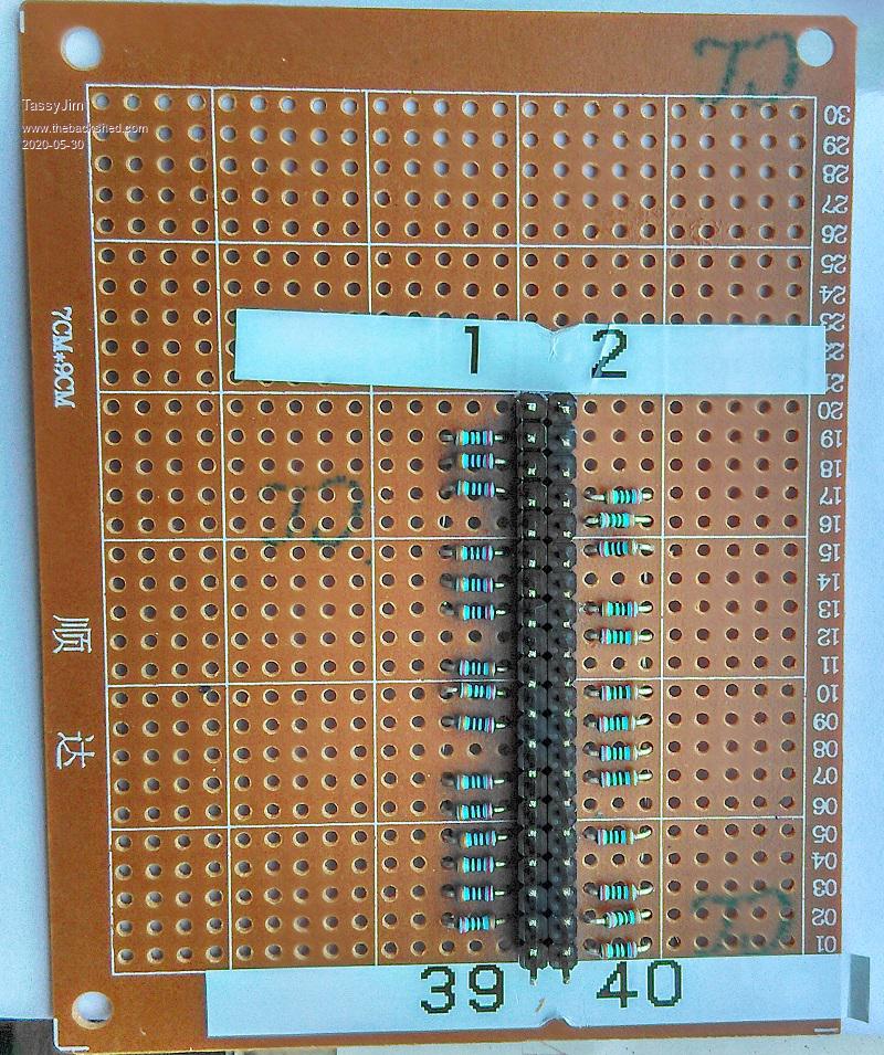

Not a demo - more a test but I had to put it somewhere.
This tests the wiring of your 40 way connector.
It needs 28 resistors of the same value. I used 200 ohm but anything from 200 to 2k should do the job.
It first checks to see if the cable is the right way around.
Then we test all digital IN and digital OUT.
The analog in is tested by setting one digital OUT high and one LOW to give a voltage at VCC/2.
My fist go was on a breadboard then I got creative with the soldering iron.
 ' CMM2 pin tester.

Posts: 3881
Posted: 11:10am 30 May 2020
Are the outer leads of the resistor all ganged? That is what I appear to see through some of the aligned holes.
Posts: 6606
Posted: 12:23pm 30 May 2020
  lizby said  Are the outer leads of the resistor all ganged? That is what I appear to see through some of the aligned holes.
Yes
As per the comments in the code
  Quote  ' requires a bank of 28 same size resistors (I used 200 ohm)
' connected from each pin in pintest() array to a common point
I should have been clearer.
In the circuit, the numbers in brackets refer to the pin numbers when the cable is arse about.
Posts: 11881
Posted: 01:28pm 30 May 2020
  Quote  Are the outer leads of the resistor all ganged? That is what I appear to see through some of the aligned holes.
' requires a bank of 28 same size resistots (I used 200 ohm)
