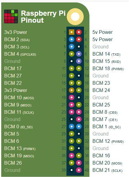

This has been a topic of discussion elsewhere so here are my
recommendations for a joystick I/F standard. Use this thread to add comments in order to reach a general consensus.
If this is agreed it will be included in the manual and any external devices should then be built to meet the standard.
All digital pins to be pulled high and will be active low. NB: all digital pins are 5V capable.
Analog inputs to be in range 0-3.3V. Center zero inputs should give a value of 1.65V
analog x - pin 7
analog y - pin 13
analog z - pin 15
digital up - pin 35
digital down - pin 36
digital left - pin 38
digital right - pin 40
Button A - pin 32
Button B - pin 33
Button C - pin 27
Button D - pin 28

As far as Peter's opening proposal at the top of this thread, I would only suggest the following minor change:
analog x1 - pin 7    renamed
analog y1 - pin 13   renamed
analog x2 - pin 15   renamed
analog y2 - pin 26   extra analog pin added
Everything else is perfect and AND IS NOW THE STANDARD (that I will be using for anything I write.)

One concern about using pins 27 and 28, since I think they're also the recommended pins for one of the I2C ports. Would there be a risk of hardware damage if someone had the joystick buttons connected there as listed above, but the program was expecting the Nintendo nunchuck? That would be bad.
I don't think there would be any problem the other way around (i.e. nunchuks plugged in when joystick buttons are expected), since if the program was expecting joystick buttons it would just be reading the pins.
