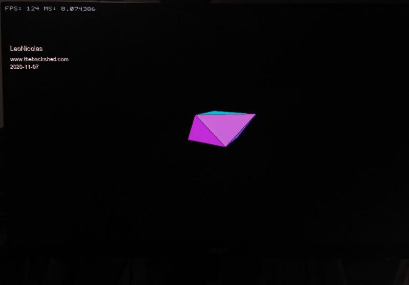

Peter
Is this what you are expecting?
Octahedron rendering with page copy (125 FPS):
https://youtu.be/OFFE4AApq4U
Octahedron rendering directly to page 0 (250 FPS):
https://youtu.be/vvfzPPXxBUQ
No optimizations yet, but it's being very cool

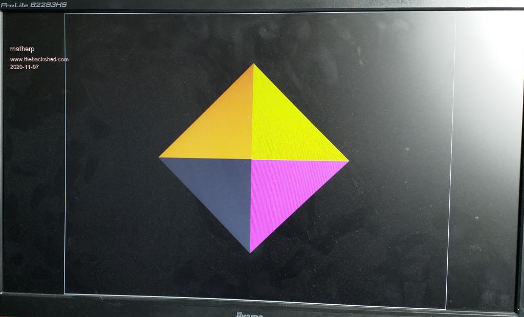

Looks too small. I'm expecting the octahedron will be about 400 pixels high ((250+250)/1000*800)
More clarification on the rules:
Please print out the coordinates of all 6 vertices after 650 iterations.
Do not use specific characteristics of a tetrahedron for hidden face analysis  (i.e. only 4 faces can ever be showing). Please make the techniques for hidden faces fully generic.
Should also have said to centre the output on MM.HRES\2, MM.VRES\2
angles to be considered as follows:
X + 2 degrees rotates the top of the tetrahedron away from you
Y + 1 degrees rotates the left of the tetrahedron away from you
Z + 0.5 degrees rotates the tetrahedron clockwise from the perspective of the viewer
If you are using Euler angles then rotate in the order x,y,z
Before any rotation the screen should look something like this. The white border is the edge of the 800x600 display area (BOX 0,0,MM.HRES,MM.VRES)

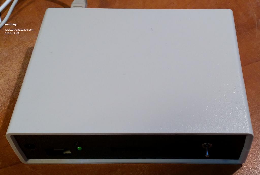

My current time for 720 iterations, with the area to be drawn cleared each time (mandatory), but no page copy is 3.449 seconds or 208FPS using Euler angles and Painters. The screen output seems to be taking just under half of the time so that could be nearly halved if hidden planes are not output , albeit at the expense of possibly more calculation.
Of course without page copy the video output is a complete mess but the challenge is to do the calculations and display the output on a clear page as fast as possible.
Video with page copy for reference
This is running at 132 FPS

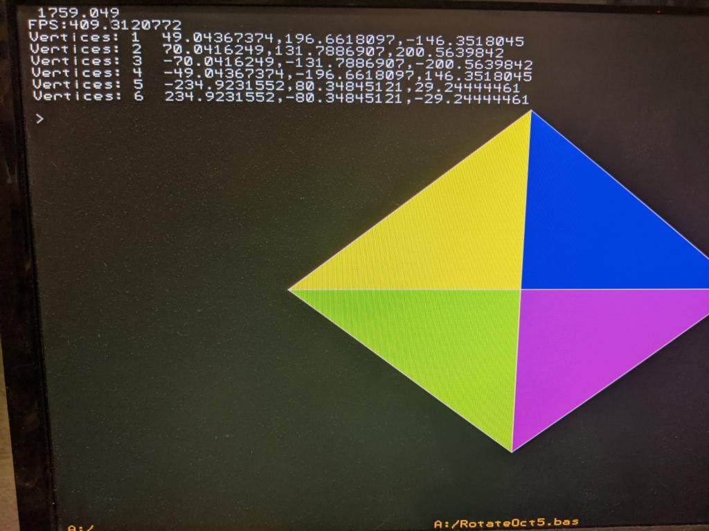

I guess I'll go first
I have no idea if these vertices (from the 650th iteration) actually match anyone elses?
1759ms (409 frames per second)
With Page Copy it drops to 5485ms (131 fps)
Edited 2020-11-08 07:52 by PeteCotton
