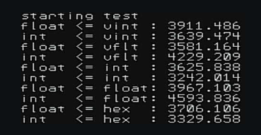

Posted: 06:39pm 14 Nov 2020
My octahedron code was running in 1004ms using the RC18 with all numbers coded as hexadecimal and variables as float (because in the previous version float variables were fastest than integer). After upgrading to the RC19 these were the results:
1) Without changing the code: no time difference
2) Using decimal instead of hexadecimal (with all variables as float): 1045 ms
3) Using decimal but changing some variables to integer: 978ms
I run the following test:
option explicit
option default float
dim rf,l,vf=1.0
dim integer vi=1,ri
print "starting test"
timer=0
for l=1 to 1000000
 rf=vi
next l
print "float <= vint : "+str$(timer)
timer=0
for l=1 to 1000000
 ri=vi
next l
print "int   <= vint : "+str$(timer)
timer=0
for l=1 to 1000000
 rf=vf
next l
print "float <= vflt : "+str$(timer)
timer=0
for l=1 to 1000000
 ri=vf
next l
print "int   <= vflt : "+str$(timer)
timer=0
for l=1 to 1000000
 rf=1
next l
print "float <= int  : "+str$(timer)
timer=0
for l=1 to 1000000
 ri=1
next l
print "int   <= int  : "+str$(timer)
timer=0
for l=1 to 1000000
 rf=1.0
next l
print "float <= float: "+str$(timer)
timer=0
for l=1 to 1000000
 ri=1.0
next l
print "int   <= float: "+str$(timer)
timer=0
for l=1 to 1000000
 rf=&H1
next l
print "float <= hex  : "+str$(timer)
timer=0
for l=1 to 1000000
 ri=&H1
next l
print "int   <= hex  : "+str$(timer)
These are the results:
My conclusion is setting hex to float variables still a little fastest than decimal to float variables, but for decimal to integer variables the improvement is huge.
