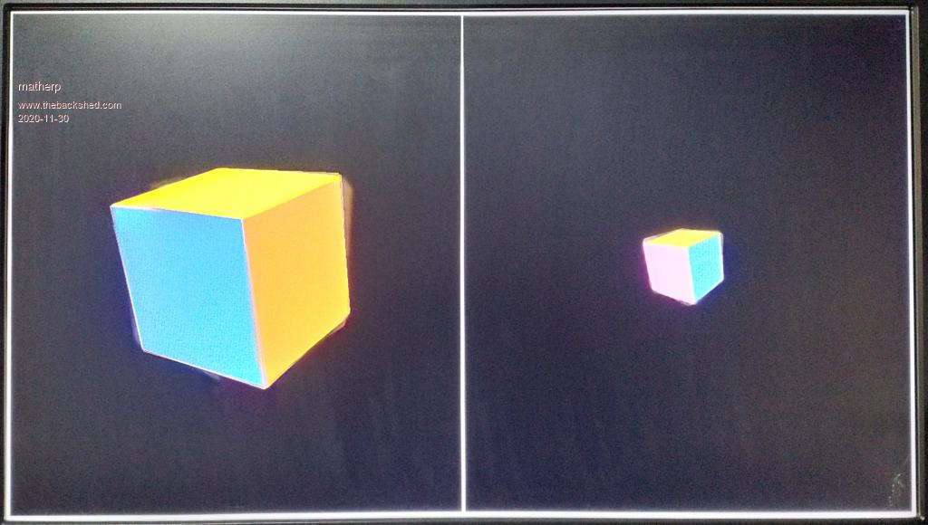

For a simple example of a 3D object in action check out this video and I'll attach the code below so you can see how simple it is.
Hopefully the above gives you a basic understanding of how the 3D engine works and its limitations. The way the camera works may seem to create a specific limitation in terms of multiple views of an object but we will see in a subsequent post how this can be overcome.
The next post will look at the DRAW3D command in detail but in the meantime you can download the firmware and try the two attached example programs.

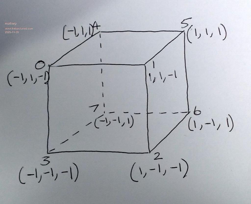

DRAW3D commands
DRAW3D CREATE
DRAW3D CREATE nv, nf, camera, vertices(), fc(), faces(), colours() , edge() ,fill()
DRAW3D CREATE is the command that creates a 3D object and all the information needed for the object is included in the parameter list. We will use a cube as an example.
nv: number of vertices (e.g. 8 for a cube)
nf: number of faces (e.g. 6 for a cube)
camera: number of the camera to use when displaying the object (1 to 6)
vertices(): This is a 3 by nv array that holds the x,y,z coordinates of the 3D object. For example the vertex definition for our cube with side length 2 with Option Base 0 centred on 0,0,0 could be:
vertices(2,7) = (-1,1,-1,  1,1,-1,  1,-1,-1,  -1,-1,-1,  -1,1,1,  1,1,1,  1,-1,1,  -1,-1,1). Note that the negative values represent the vertices closest to the camera.
fc(): is a count of how many vertices are needed to define each face, so in our example for the cube which has 6 faces it would be fc(7)=(4,4,4,4,4,4)
faces(): This is a very important array and defines the vertices that make up each face of the 3D object. There is one critical thing in setting up this array. The vertices must be listed in a clockwise order for each face as though you were looking at that face from in front of it. It doesn't matter which order the faces are listed as long as they match the correct vertex count in fc() and it doesn't matter which vertex you start on for each face. In our example this array could be:
faces(23)=(0,1,2,3,  1,5,6,2,  0,4,5,1,  5,4,7,6,  2,6,7,3, 0,3,7,4)
colours(): This is an array that holds a simple list of all the colours you want to use to colour the 3D object. So if we want a different colour for each face and another one for all the edges we could set this array as follow:
colours(6)=(rgb(blue), rgb(green), rgb(yellow), rgb(cyan), rgb(red), rgb(magenta), rgb(yellow))
edge(): This arrays specifies which of our colours to use for each edge of the 3D object. We will set them all to the array index in colours() holding the value yellow
edge(5)=(6,6,6,6,6,6)
fill(): This array specifies which colour to use for each face of the 3D object. We will set them each to a different colour by specifying the array index into colours()
fill(5)=(0,1,2,3,4,5)
Those familiar with 3D graphics will notice that the parameters to DRAW3D CREATE exactly match the way 3D objects are defined in .WRL files. For example see the attached is a wrl file downloaded off the web for a dodecahedron. In a later release I may include a command for loading a 3D object directly from a .WRL file but this could easily also be done with a simple MMBasic function.
Next post I will look at the other DRAW3D commands and display and manipulate our cube.

We set up the vertices using:
dim float vertices(2,7) = (-1,1,-1,  1,1,-1,  1,-1,-1,  -1,-1,-1,  -1,1,1,  1,1,1,  1,-1,1,  -1,-1,1)
We can make the cube the size we want by simply multiplying all the elements in the vertex array by the amount we want. So to make the length of each side 200 we can use:
MATH SCALE vertices(), 100.0, vertices()

Now lets build up a another very simple demo using our cube
First lets define the basic parameters of the cube and some general purpose variables
option explicit
option default none
option base 0
DIM INTEGER i
DIM FLOAT Q(4), yaw=0, pitch=0, roll=0
dim integer nv=8, nf=6 ' cube has 8 vertices and 6 faces
const camera1 = 1, camera2 = 2' define two cameras
dim float vertices(2,7) = (-1,1,-1,  1,1,-1,  1,-1,-1,  -1,-1,-1,  -1,1,1,  1,1,1,  1,-1,1,  -1,-1,1) 'define the vertices of the cube
dim integer fc(5)=(4,4,4,4,4,4) ' define the number of vertices in each face
dim integer faces(23)=(0,1,2,3,  1,5,6,2,  0,4,5,1,  5,4,7,6,  2,6,7,3, 0,3,7,4) 'define the vertices that make up each face
dim integer colours(6)=(rgb(blue), rgb(green), rgb(magenta), rgb(cyan), rgb(red), rgb(magenta), rgb(yellow)) 'define our colour palette
dim integer edge(5)=(6,6,6,6,6,6) 'define the colours used for the edges of each face
dim integer fill(5)=(0,1,2,3,4,5) 'define the colours used to fill each face
That should give us everything we need to define out cube but before doing anything else let's make it a sensible size
MATH SCALE vertices(), 150, vertices()
and finally using that data lets create a couple of 3D cube objects
DRAW3D CREATE 1, nv, nf, camera1, vertices(), fc(), faces(), colours(), edge(), fill()
DRAW3D CREATE 2, nv, nf, camera2, vertices(), fc(), faces(), colours(), edge(), fill()
Before we can display anything we need to set up our cameras. We are going to use 1 for a front view of the cube and one for a top view with a greatly reduced scale by having a lower "focal length" lens
DRAW3D CAMERA 1, 750, MM.HRES\4, MM.VRES\2
DRAW3D CAMERA 2, 250, MM.HRES\4*3, MM.VRES\2
At the moment the two cubes are identical but we need to pitch the second one down 90 degrees to make its starting position the top view
MATH Q_EULER 0,RAD(-90),0,q() 'create a pitch down rotation of 90 degrees
DRAW3D ROTATE Q(),2 'apply the rotation
DRAW3D RESET 2 'lock in the change as the default position
Let's split the screen to separate the front view from the top down view. We will do that on page 1 so that we can get a nice clean display
PAGE WRITE 1
BOX 0,0,mm.hres\2+3,MM.VRES,3
BOX mm.Hres\2, 0, mm.hres\2, mm.vres,3
Finally let's display our two images
DRAW3D SHOW 1,mm.hres\4,mm.vres\2,1000 'display the first cube
DRAW3D SHOW 2,mm.hres\4*3,mm.vres\2,1000 'display the second cube
That's all pretty boring so lets set them rotating and remember to copy the page to page 0 after wach time round the loop
do
 inc yaw,rad(0.25) 'increment the yaw angle by 0.25 degrees
 inc pitch,rad(0.5) 'increment pitch
 inc roll,rad(1) 'increment roll
 math q_euler yaw, pitch, roll, q() 'create the rotation matrix
 DRAW3D ROTATE q(),1,2 'apply the rotation to both cubes
 PAGE COPY 1 TO 0, B 'copy the page during blanking
loop

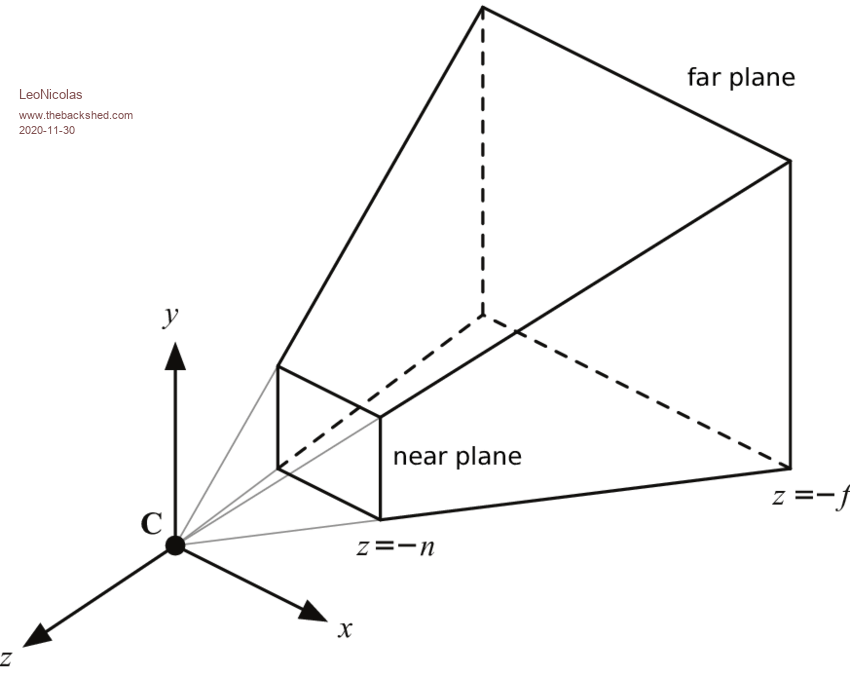

Now a question. You fixed the near and far camera parameters in 1 and 6 (fixed Frustum depth). Is it not better to allow us to specify these 2 values?

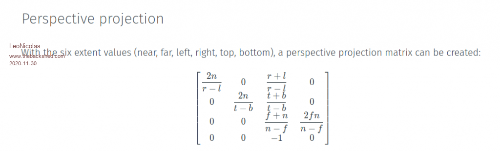

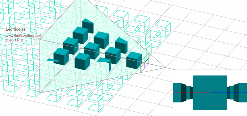

The near / far planes are the clipping planes for the Z axis.
They are part of the perspective projection matrix:
https://jsantell.com/3d-projection/

  LeoNicolas said  The near / far planes are the clipping planes for the Z axis.
Excellent graphics.
Are the near and far planes for image generation convenience?
In other words, items beyond the far plane are too far away to see (clearly) so don't bother calculating them?
And items closer than the near plane are too close so ignore them?
How would you reconcile this with, say, reading a notice stuck on the face of a 3-D cube? Or a 3D edge that passes almost, but not quite, through the camera?
Or put another way, how do you select where the near plane should be?

I'm experiencing a lot of issues in the 3D examples. I recorded a video to show you what is happening.
The camera example is not moving the camera and the cube example is stopping to rotate the cube when I try to change the rotation angle.

Vegipete
Normally the far argument is used for improving the render performance in complex scenes reducing the horizon distance. We can see the far effect in games when the far objects appear in the scene suddenly.
