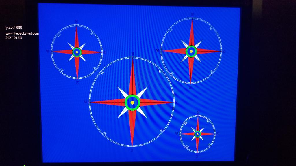

I worked on that code quite a bit more after that...it was like an 'ear worm'!
Here it is, in a little demo, but contains a standalone 'compass' subroutine. Basically, I had to use trig functions for everything.
Steve

That code looks amazing.
It's just a shame it won't work on Pi-Cromite

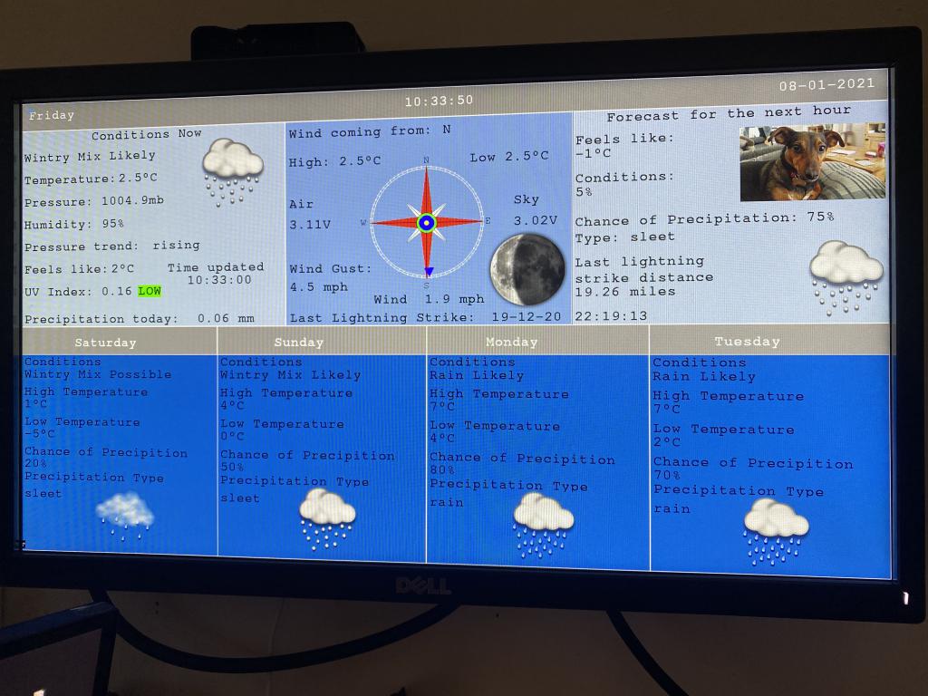

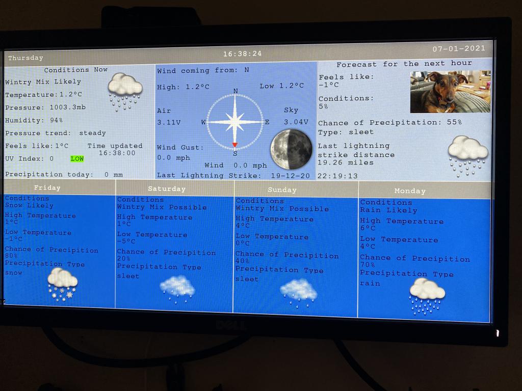

This is what I've done with your previous code
The red triangle rotates to the current wind direction
Lewis
Edited 2021-01-08 19:35 by lew247

Updated it
For some reason the vertical line isn't pointing directly north and south and I can't figure out why
This is my "modified" version of your code
for some reason the intermediate direction markers aren't working they go off the screen, NE, SE etc
and Image rotate won't work on Pi-Cromite which is why it's commented out
