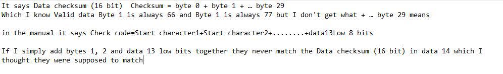

I'm trying to write code to read a sensor that sends data by serial at 9600 baud but I don't understand some things.
I've looked on here and searched Google but was not able to find anything that explained it in simple words I could understand

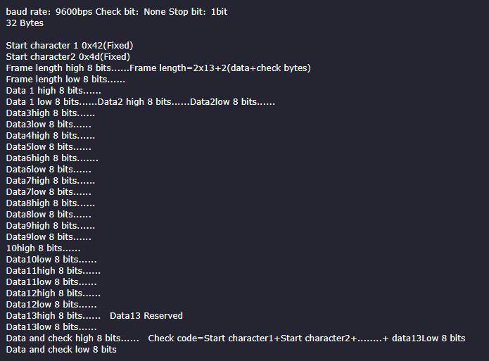

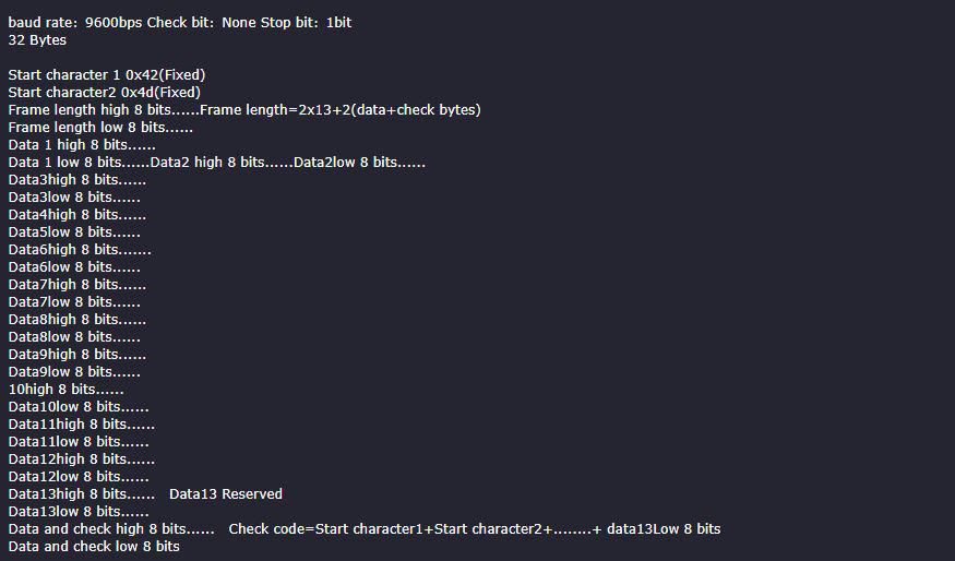

The format of the data I'm trying to decode is

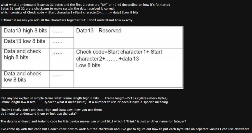

If I'm right then shouldn't character 31 start with BM? but it doesn't, it changes
This is what it's decoding
I'm trying to understand properly so I don't have to keep asking for help
This is also getting really frustrating having to take pictures of what I want to say so I can post it as the forum keeps saying it contains illegal ascii characters even when none of the ones I use are over 127 most times

For the checksum, add all the individual bytes together then take the lower 16 bits of the result.

Its the PMS5003 air quality sensor Datasheet

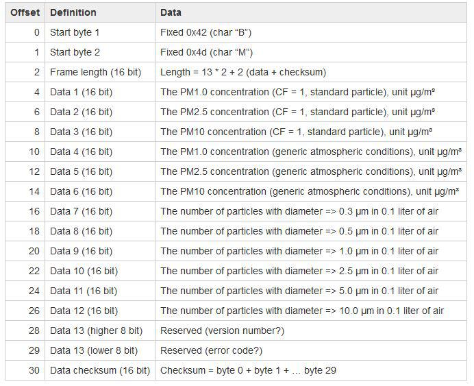

My issue is
it has 32 Bytes and each one of the ones I need consist of 16 bits 8 high and 8 low
I don't know if I#m meant to add the ascii values for the high and low bits to get the correct data, or what to do with it
for example below offset 12 which is Data 26 (16 bit)
Do I simple add the 8 upper and 8 lower bits together to get the byte value?
it's ascii values received if that helps
Also I really cannot get how to generate the checksum
As well as checksum, in binary format (its fairly easy to parse the binary format, but it doesn't come out as pure readable ascii text)
Adafruit have a tutorial here but it doesn't tell me in plain english what I need to know

You have to add +all+ bytes--30 in total--2 start bytes, 2 frame bytes, 26 data bytes.
Posts: 6624
Posted: 10:57pm 26 Jan 2021
You have to compare your calculated checksum with the devices checksum
for n = 1 to 30
  checksum = checksum + asc(mid$(b$,n))
next n
checksum_sent = asc(mid$(b$,31))*256 + asc(mid$(b$,32))
if checksum = checksum_sent then print "Yippee!!!!"
to get your values, you multiply the high byte by 256 and add the low byte.

In the datasheet it says
Check code=Start character1+Start character2+........+data13Low 8 bits
Could that mean add characters 1 - 12 + data 13 low bit?
then if it's the same as characters 31 and 32 it's valid?
OR does it mean add characters 1 + 2 + data 12 low 8 bits?
As the first 4 bytes are always 66,77,0,28 in valid data and I guess I could use that instead of the acual checksum sent to ensure valid data?
it's just the fact I can't figure out how the checksum is calculated that's bugging me.

  Quote  Where did you get the *256?
The data consists of 16 bits. The low byte contains the value 0-255. The high byte holds the values of 256 and up. To get the 16 bit value you must multiply the high byte by 256 and add it to the low byte to get the full 16 bit value.
  Quote  Check code=Start character1+Start character2+........+data13Low 8 bits
That is a bit confusing but I think it does mean to add all of the bytes from Start character1 to the data byte13low to get the checksum which is a 16 bit number. As Jim has done.
  Quote  do I add the bytes together to get the values?
in the last data line that would be
1,3,3,1,3,3,60.165,26,2,0 and 79 is the checksum?
No. As above you must multiply the high byte by 256 and add it to the low byte to get the 16 bit value. So the checksum is:
(2 * 256) + 77 = 589 decimal.
Check out Jim's code and try to understand it.
I haven't put your data into Jim's program yet.
Bill

Surely this can't be right?
If that is the case then with this data
66 77 0 28 0 31 0 43 0 48 0 26 0 38 0 47 22 77 6 77 0 230 0 17 0 6 0 2 151 2 3 226
then the
PM10 particle count is data 10* 256 + data 9  which is 48*256+0 = 12288
PM2.5 particle count is data 8* 256 + data 7  which is 43*256+1 = 11088
PM1.0 particle count is data 6* 256 + data 5  which is 31*256+0 = 7936
Those values seem really high?
Especially for indoors

Sorry but I see the data for PM10 as 0, 48.
  Quote  66 77 0 28 0 31 0 43 0 48 0 26 0 38 0 47 22 77 6 77 0 230 0 17 0 6 0 2 151 2 3 226
PM 2.5 = 0, 43
PM 1.0 = 0, 31
I don't see where you get your values from.
