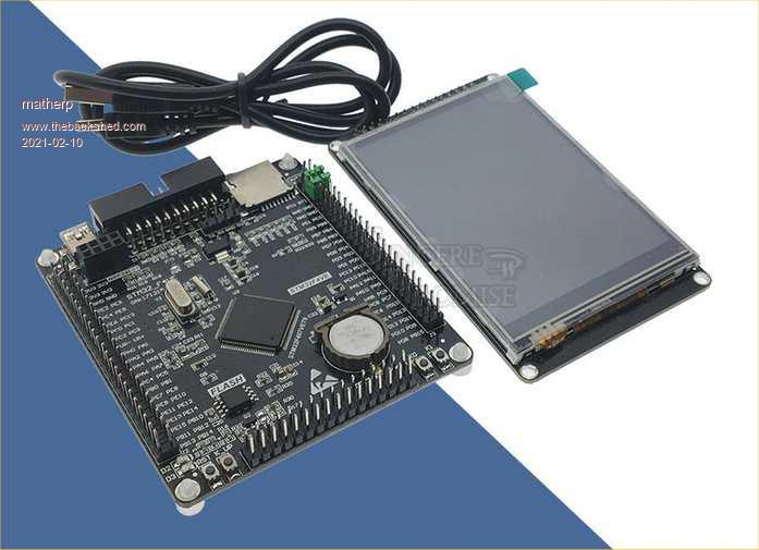

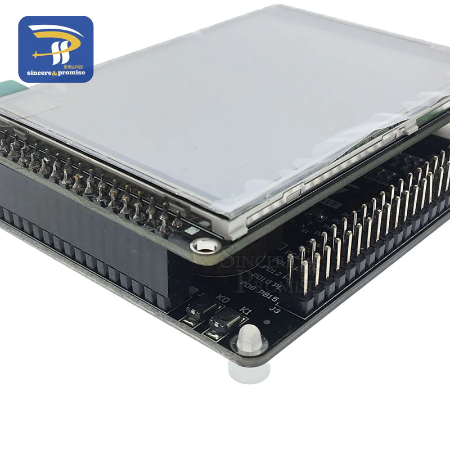

For those that don't know about the ArmmiteF4, it is my favourite MMbasic port. A single board that has everything you need - USB serial port, RTC with battery, SDcard slot, TFT header. It runs faster than the MM+ and is much cheaper as a complete system. Lots of projects like Geoff's Super Clock, DDS signal generator, and boat computer are easy to port to the ArmmiteF4 with display and run superbly.
The matching display is 16-bit parallel and very fast
Buy the pair from here and many other vendors
Note there are lots of variants of STM32F407 development boards. You must buy the one pictured for the firmware to work.

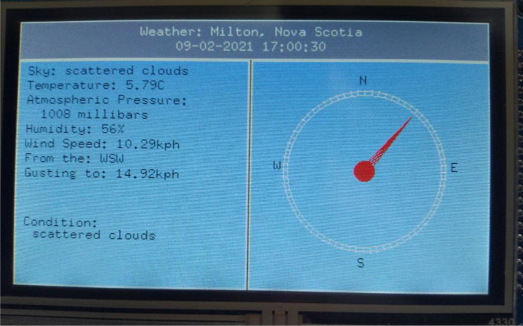

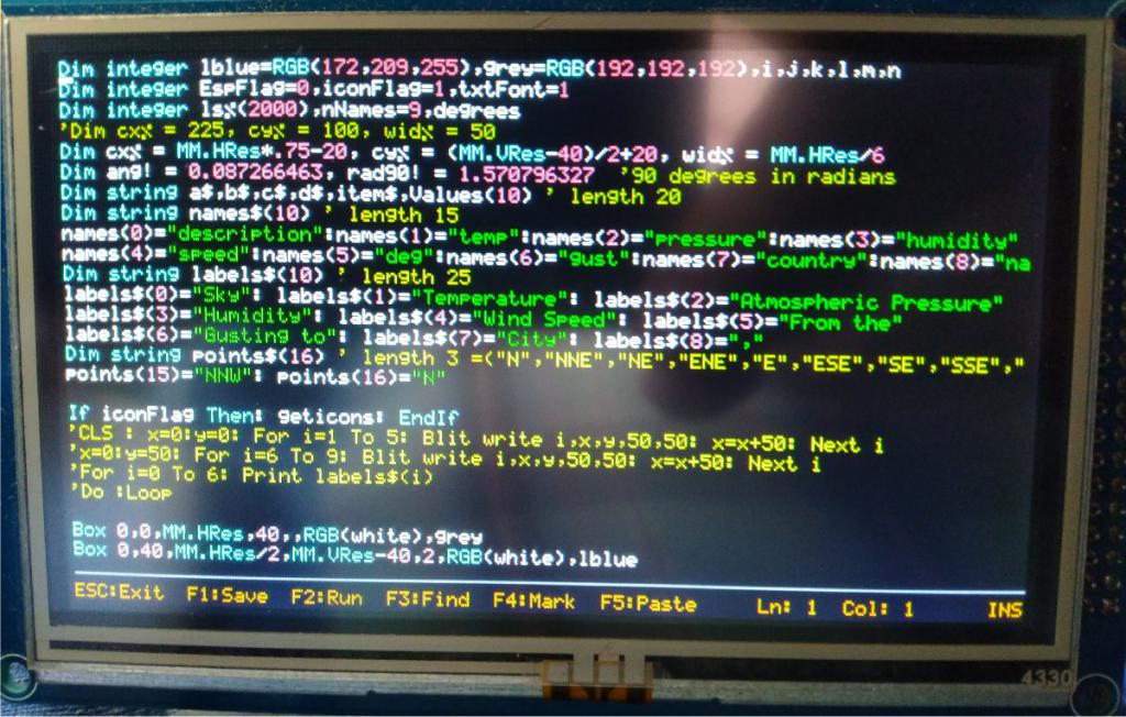

Thanks for the update. That works. After programming firmware on F4 with 4.3" 480x272 LCD:
OPTION LCDPANEL DISABLE
OPTION LCDPANEL SSD1963_4_16,L   [Power cycle]
OPTION TOUCH PB12, PC5
gui calibrate
F10 [AUTOSAVE] (after selecting my code on the PC)
Ctrl-Z [save program]
F2 [run]
Ctrl-C [quit]
F2 [run again]
(As ever, the LCD is crisp, though photo from my phone is mangled.)

Posted: 09:35pm 09 Feb 2021
Does that display plug directly onto the board ?
my site
Quazee137
Joined: 07/08/2016
Posts: 603
Posted: 09:58pm 09 Feb 2021
Yes

Posted: 11:26pm 09 Feb 2021
Neato .... Thank You ....
Is that a certain ' brand ' or ?
Edited 2021-02-10 09:29 by hitsware2
my site
Posts: 3885
Posted: 12:06am 10 Feb 2021
  hitsware2 said  Neato .... Thank You ....
Not the "black pill", not other STM32F4 varieties. Search aliexpress for "STM32F407VET6". If you want the LCD, pick, a site which shows it in addition to the F4 board.
Like this. Matherp's site has a better price.

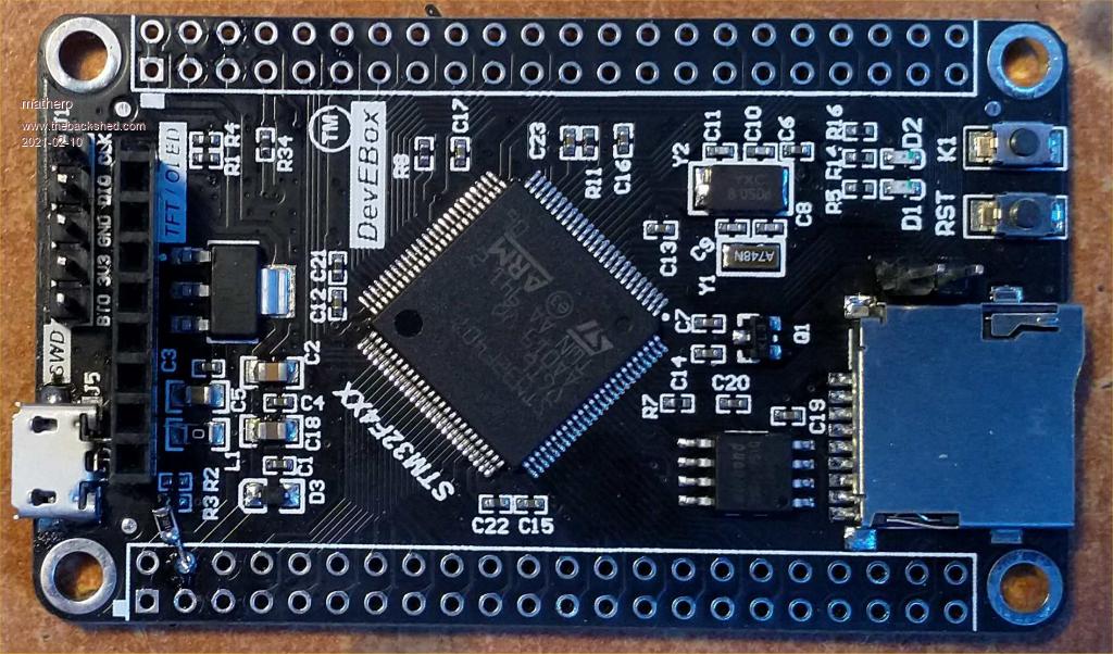

This version (V5.06.01) should be switchable. Program the firmware as usual. Then hold down KEY0 while you reset the board and it should switch it into serial console mode
ArmmiteF407.zip
NB: I've also tested this version on a "black pill" and it works fine. HOWEVER, the black pill is missing a 1.5K resistor from D+ to 3.3V. In the picture I've used a 1206 1.5K resistor between the top of R3 and 3.3V. With this mod W10 sees the USB CDC and I can connect with teraterm. The SDcard works fine. I haven't tried the display header as the pinout is non-standard but it should work suitably wired with a ILI9341. Do note that the standard of production of the black pill seems to be extremely poor. The usb connector fell off on mine the first time I pugged a cable in so I re-flowed all the components

Posted: 10:57am 11 Feb 2021
I haven't been able to find that version of the Black Pill Peter. Can you provide a pointer please?
Rgards,
IanT
Posts: 11982
Posted: 11:15am 11 Feb 2021
  Quote  I haven't been able to find that version of the Black Pill Peter. Can you provide a pointer please?
here but you can find much cheaper elsewhere
But I do not recommend it. The target board is better in every respect
Posts: 6168
Posted: 11:31am 11 Feb 2021
Not sure about the name of the board. If you google at STM32 black pill the things that show up are boards that have the shape of the "blue pill"
They typically have STM32F401/F411 chips on them.
That is why you might have been confused.
here
here
here

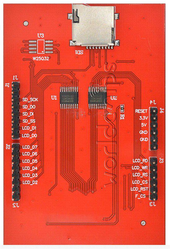

  Quote  To me, a much better fit would be the 480x320 SPI ILI9488, which would give an 80x40ish edit screen with font 7. Of course, it would also require a backpack to bring out the interface pins.  I would propose to design one which would also include a PS/2 keyboard connector, socket for RTC & ESP-01, mini-stereo socket, IR capability, and a 20x2 pi-type connector like that on the CMM2. The 3.5" ILI9488 can be had for $10US including shipping. There is apparently a 'loadable' driver for this LCDI think for the MM+ (and perhaps MMX). This would make a very capable "MMBasic computer").
If you design a backpack I'll commit to getting the ILI9488 working. Be aware though that the display is slow: 480x320 16-bit is a lot of data over SPI
Better would be something like this

Posted: 03:13pm 11 Feb 2021
  matherp said
  lizby said  To me, a much better fit would be the 480x320 SPI ILI9488, which would give an 80x40ish edit screen with font 7. . . . This would make a very capable "MMBasic computer").
Excellent. I've ordered one of the "3.5" inch 480x320 TFT LCD Touch Screen Display Board For Arduino UNO R3 Mega2560" LCDs from here
Is the connection from the F4 LDC header straightforward?
