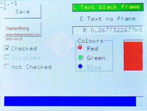

Morning everyone.
Just wanted to share my current "spare time" project.
I have put WindowsCE/95-a-like GUIs in a lot of my projects on the smaller MicroMites that dominate my work. Larger 'mites (MM+, ARMMite etc.) have a GUI built into the firmware but size restriction on the Mk2 mean if you want a nice touch-screen display you have to build it yourself - and I have... from scratch, every time, resulting in rigid un-portable code.
I have had some interest from other users on how I did it and it seems to surprise everyone that MMBasic is quite capable of producing a responsive display on these smaller machines. Not a CSUB in sight - which is my aim because I want portability between the 'mite platforms.
So I have put together a more inclusive pack that you can simply insert in your code, a tiddly bit of config and start plopping your screen elements on the LCD panel and using them. It is about 10K at the moment - you can chop out the code for gadgets you won't be using easy enough, but I often had 6K of monolithic code for a far less capable GUI, so I don't consider it too much of a "waste". YMMV
For now, the main screen service routine is polled and returns the number of the object touched or -1 (nothing). It has proper handling of enablement, visibility, grouping of radio buttons etc. Please remember it is very much a work in progress and there are some bits missing but I think these are the not-used-as-much bits. I just wanted to get it out there for critique.
Note: I always poll for touches in the main loop of my code and the example code shows this. It wouldn't be a big task to do a touch interrupt handler with a wrapper to call the touch processor if that is your thing.
Main article (detailing how to use it with example) and code is here
Comments in the code are a bit thin but I will do a better job as releases occur.
Screen grab is a bit bleached out but you get the idea.
enjoy

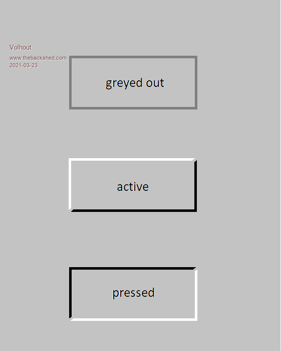

Posts: 6253
Posted: 12:22pm 23 Mar 2021
I always used it and never wondered how they did it, but it is so simple.
W95 buttons....they only redraw the contour. The button text can even be part of the canvas... Never knew that...
Thanks for razing my curiosity.

Running your demo program I get these speed indications:
-Mk2 shows R 0.833167ms
-Plus shows R 0.587412587ms
-In your picture above R 0.2677322677ms (suppose it is F407).
Both Mk2 and Plus has fast response to the touches. (Using your demo program.) Will be interesting to see how it will be in "real" applications with more processing besides the GUI.

  Pluto said  Running your demo program I get these speed indications:
That is good to know. Thanks (those numbers don't actually mean anything). More often it is perception to how the interface works that is important. So long as the user feels their request has been immediately acknowledged, they are seldom bothered too much if it takes a moment to actually do some work.
Yes, the response is directly a function of how often you poll the screen. If your main loop is just zipping round waiting for things to happen dropping in a call to the touch processor will probably be fine. If it gets to be a pain then an interrupt would probably be best - only thing I see there is waiting for the touch to go away (WaitNoTouch) would be operating inside the ISR... not ideal.
Posts: 6253
Posted: 04:14pm 23 Mar 2021
I have actually seen this one:
fake dome
It was amazing when seen from the right angle....

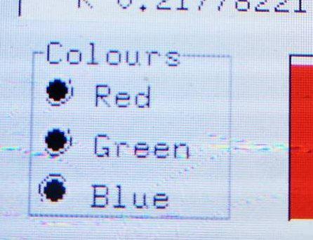

Playing with the test program a little bit on an F4 with SSD1963_4_16, and I like it--very clean-looking.
One thing I notice--perhaps it is because the the radio buttons are themselves red, green, and blue, but it's difficult to tell which one is selected.
Very nice work on the FruitOfTheShed documentation, too.

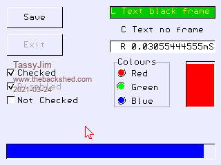

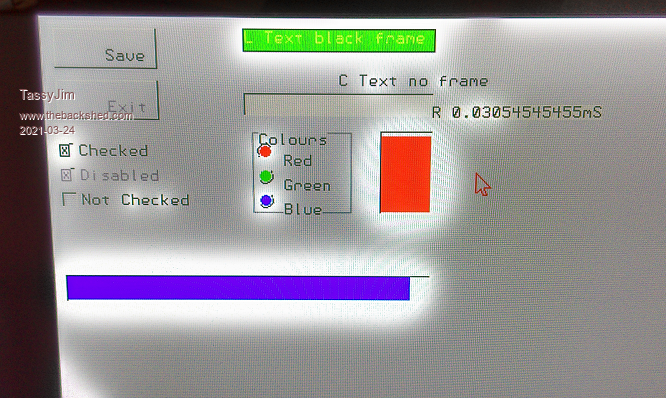

Posts: 6638
Posted: 01:17am 24 Mar 2021
A wet day in Tasmania today so I thought I would have a play.
I am interested in how portable code can be and this is a good example of 'very portable'
To run it on a CMM2, I had to include the MOUSE and CURSOR initialisation and change the TOUCH(X|Y) to a function that reads the mouse
Simple enough.
The only other gotcha I have seen is GUI BITMAP
Not available on the CMM2 so I simply put a tick character in the box.
(Image has it as a cross)
The other obvious thing is the alignment of the text boxes. I haven't chased that one down yet.
Posts: 6638
Posted: 05:36am 24 Mar 2021
A better result after some work:

Posted: 07:03am 24 Mar 2021
  lizby said  Playing with the test program a little bit on an F4 with SSD1963_4_16, and I like it--very clean-looking.
The "dot" inside the button can be any colour you like.
Looking at the demo code, see the lines:
res=GUIObjDef(40,2,170,100,,,"Red",1,&hff0000)
res=GUIObjDef(41,2,170,120,,,"Green",1,&hff00)
res=GUIObjDef(42,2,170,140,,,"Blue",1,&hff)
last property is the hex for RRGGBB so if you want a black dot, use 0, if you want white use &hffffff or any combination for any colour you like.
Selected buttons are "depressed". perhaps could make the line a bit wider. I will play

Posted: 07:15am 24 Mar 2021
  CaptainBoing said
Actually, I think you have a good point. with a black dot, it is even less obvious.
will do some work on them... have a close look at what W95 did with them - I don't remember any confusion there so obvs they had the mix right

Posts: 6638
Posted: 07:18am 24 Mar 2021
Changes made to run on CMM2
At the beginning:
 if mm.device$ = "Colour Maximite 2" then
   mp = mm.info(option mouse) ' mouse port
   cmm2 = 1
   option console serial
   GUI CURSOR ON 0, 100,100,rgb(red)
   CONTROLLER MOUSE OPEN mp
   mm.fontheight = MM.INFO(FONTHEIGHT)
   mm.fontwidth = MM.INFO(FONTWIDTH)
 endif
That gets the mouse underway and makes MM.FONTWIDTH etc available
Getting MM.FONTWIDTH working fixed all the alignment issues.
