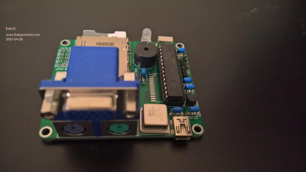

PS: There is two PS/2 connectors in the schematics (kbd & exp), but why is there none of them on the PCB?

Yes, that is correct. Of course, the keyboard driver and video are to a large extent rewritten now to fit the needs of the project, but the basis came from Geoff's Terminal. The C interpreter takes up the biggest chunk in the flash with about 100k in total (that's including the libraries).
Both PS2 connectors are on the PCB. Refer to the pictures I posted in an earlier topic.

I'm definetely missing something out, since I don't see PS/2 connectors here: http://ello.cc/pages/doc_files/image001.jpg

VGA PS/2 combo! That's what I missed. Haha! )
