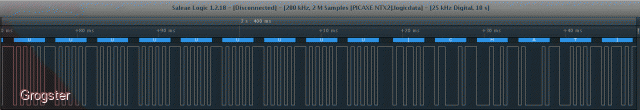

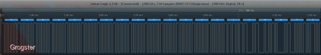

Posts: 10008
Posted: 07:06am 26 Jul 2021
  Justplayin said  Hey Grogster... I see you are using the hardware based COM1 on the MM2.  Have you tried the software based COM2 or CFuntion serial port to see if the timing is better for the PICAXE?
--Curtis
Hi there
Good idea.
I tried it, but it made no difference at all.
Was hoping it might!
I have captured the PICAXE data, I am now just doing the MM2 data then I will post images and SaelieLogic data files in a ZIP.
Posts: 9027
Posted: 07:40am 26 Jul 2021
I trust you are using direct wire-wire connection (or at least nothing in the way apart from passive stuff)?
Have you tried the slowest possible baud rate and putting LEDs on the data pins?
With the logic analyzer you could get both to send the same thing and compare the tx streams. Then try loopback on both, if they are both the same. That would rule out tx problems. If tx aren't both the same then you need to look at that.
Posts: 10008
Posted: 07:50am 26 Jul 2021
There is a difference now that I have both data captures.
PICAXE output:
MM2 output: (this is with the S2 option on the COM port)
Here is a ZIP file with both of those images along with both SaleaeLogic data captures:
PICAXE_MM2.zip
There IS a distinct gap in the PICAXE data stream that is not there in the MM2 data stream.  Seems there is about 1.4ms delay between each and every byte on the PICAXE, which is not the case with the MM2 output.  This will simply be the PICAXE interpreter delay I think.
Perhaps I could re-write the MM2 output so that it takes the string, and outputs it one byte at a time, followed by a 1ms pause or something.  I might experiment along those lines.
If any member has a SaleaeLogic, I would appreciate you looking at the captured data and letting me know any thoughts you might have.

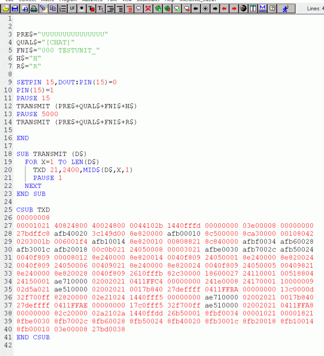

Posts: 10008
Posted: 08:41am 26 Jul 2021
It is now working.
Putting a pause between bytes using the hardware UART did not work, as the output buffer just joined them all together again - as you would expect for a hardware UART buffer when you think about it.
Borrowing from Justplayin's suggestion, I used the bit-banged serial Cfunction, and output the bytes one at a time.  I don't even need a delay in that situation, as the natural FOR/NEXT interpreter delay introduces just enough of a pause between bytes, that the PICAXE decodes the message perfectly.
My new testing code that is working:

The same would have worked on the HW UART. Do not feed it a string, but a character at a time, and add delays in between. Or you just may be saved by adding 2 stop bits and parity(you throw away, but it is another bit delay)
Posts: 10008
Posted: 11:02pm 26 Jul 2021
I did try that(FOR/NEXT to the H/W UART), but it did NOT work, and the logic analyzer showed that the actual output from the UART buffer had ignored the delay I tried to introduce that way, and essentially stapled all the bytes together again into one continuous stream, totally ignoring any introduced delays between the bytes.
I can understand that, when you think about how a data buffer works.
By its very nature, the buffer - is a buffer, and is designed to collect the data together before sending it out the UART, so that method did not work.
But I did try it.
Posts: 3364
Posted: 02:11am 27 Jul 2021
The firmware will pass the character to the UART (and the UART will immediately start transmitting it) the moment the program sends it to the COM port.   The firmware will only buffer the character if the UART is already busy transmitting a previous character.
Perhaps you did not have a big enough delay.  At 2400 baud it will take 4.2ms for the byte to be clocked out by the UART so, if your delay was less than that, the firmware will be forced to buffer any subsequent characters.  You need a pause greater than 4.2ms.  For example, if your pause was 6ms, that would cause a delay of 1.8ms after the last bit left the UART.
Geoff
Posts: 10008
Posted: 03:18am 27 Jul 2021
Oh, OK, looks like I was wrong on that one then - sorry Volhout.
I will try going back to the h/w UART and adding a bit more delay and then seeing what that does.  I was only using 1ms, thinking that would put a 1ms delay between the bytes.  You learn something new everyday.
