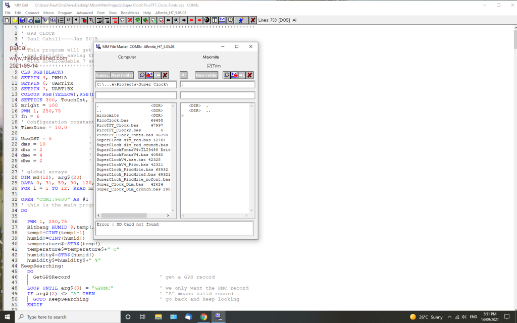

I am having all sorts of problems connecting the PICOMITE to MMEdit. On my desktop it won't connect at all, on my laptop it works to download files to The Pico but I can't upload from the Pico to the PC.
It's probably something simple, it did work on the desktop box then stopped so I downloaded the latest version but still no go. It connects as far as the serial connection is concerned but I cant use File Master to transfer files.

Downloaded and installed the file but no change. I am obviously doing something wrong. In the file transfer pop up on the right hand side at first it says "working" and then "dir." and "dir.." how can I select the file?

I saw this if SD Card is not in when you open the FileManager browse window.  Press the A: button to make it try and read again. You do have the Error: SDCard not found, which it gives if SDCard is not in. Can the PicoMite use the SDCard OK ie.

If I type "Files" I get "error SD Card not found" as expected. I have never needed an sd card with the MM is this different. Do I have to save to an SD card first.
Edit...The SD card on the display is wired and Option is set but I had no luck with it, I just get SD card not found. It's a bit hard working with the PicoMite at this stage ( for a mug like me anyway ) with no manual etc. maybe I should wait a while until all is final.

I have the sytem pins set and also the SDcard CS pin. As I said I tried it in the display card slot but not recognised.
Edit......Well no wonder it won't work, I have the SDcard pins from the display mirror reversed on my backpack board. This is going to be a messy fix.

Well not as painful as I thought Files command lists BUT save "file" gives an error.
A hard error occurred in the low level disk I/O layer
> Warning: SDcard Removed.

I've had that error when trying to save too. In my case I was trying to use an old low capacity SD card because it's what I had. Changing it for a newer card fixed it. The recommended capacity range is 8GB to 128GB. Avoid the tiny stuff.
