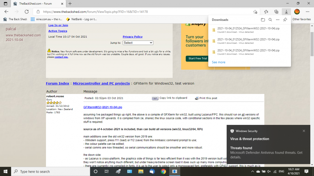

I downloaded on my laptop, no problems but on the box in my workshop running maybe a later version of Win10, it won't download because it has a virus.

That might be a false positive caused by a short piece of the code being wrongly recognised. If the two machines are using different virus checkers then that would explain it.
Posts: 2542
Posted: 09:43pm 03 Oct 2021
a false positive i'm afraid. the .exe file is compressed with UPX, which anti-virus software absolutely hates. i vaguely remember there was a workaround, but can't remember the details. can anyone else comment on the solution?

I came back to the laptop to transfer the file to a USB stick and then to my workshop box, but it has now been removed fom the laptop
Virus. Win32/Sabsik.TE.A!ml
Tried downloading with WIN7, same result.
Is anyone else having problems
Edited 2021-10-04 08:51 by palcal

palcal
Joined: 12/10/2011
Posts: 2043
Posted: 11:31pm 03 Oct 2021
I don't have any antivirus just windows defender, I could turn off "Virus and threat protection' if there is obviously no virus.
Funny that 3 different machines with only Defender all say there is a virus.
I have also deleted the download and re downloaded twice to no avail.

palcal
Joined: 12/10/2011
Posts: 2043
Posted: 11:54pm 03 Oct 2021
Using Chrome, I ran Windows Update and updated not that that should make a difference but I downloaded again and whilst I did get a warning I clicked 'Run Anyway' and all is OK. I will now try on the laptop.

Posts: 2542
Posted: 01:17am 04 Oct 2021
oops, my bad - i accidentally left in the (linux) code that checks for the linux symlink. it just happens (by chance) that this doesn't trip up for low numbered windows comm ports.
the below is also not compressed with UPX, hence .exe size is approx 2.7mb. hopefully this may keep the AV software out there happy.
GFXtermW32 (2021-10-04 A).zip
