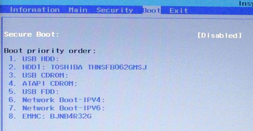

Hi all.
Trying to upgrade another older laptop from Windoze Ten to Linux Mint.
Latest Mint version, 20.2 Cinnamon x64.
I can boot the Mint USB drive fine, Mint can see the internal SSD fine, and also the on-board EMMC that originally had Windoze 10 on it when purchased - which was then moved to a 120GB full-size SSD.
I have removed the 120GB SSD, and plopped an older 64GB one in there just to play about with.  I can perform the full install the the SSD fine, no complaints or problem messages from the installer.
When prompted to reboot, I do so, and machine insists there is no bootable device.
I have tried two separate SSD's and also the internal EMMC drive now, but NONE of them will boot Mint. They WILL boot Windows, if I install Windoze onto them for the purposes of testing.  It's almost like the machine is LOCKED to ONLY let you install Windoze or something.  Anyone heard of any nasty tricks like that?  I figured that if I could boot the live-USB Mint and install from that, then......
Boot order is correct in the BIOS.
Any ideas why Mint won't boot?
Is there a way to FORCE the install of a boot-loader like GRUB to the SSD in the hope that it might be able to find and boot Mint?  I would have expected the Mint installer to plop GRUB or equivalent on the SSD if it detected that it needed to though....

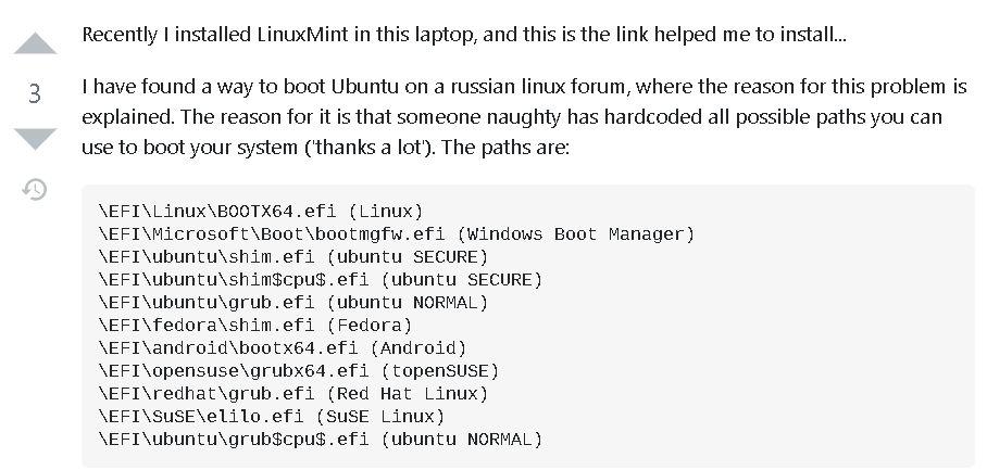

I have found some interesting information on the net.
MANY people have this issue with this series of Acer notebooks, and it would seem to be that these Acer's expect ONLY a select number of predetermined paths to any bootloader in the EFI partition.  Don't use one of the supported paths, and the machine won't boot.
Nice one, Acer....
LINK to above thread quote...
Basically, it would appear that I need to install Mint, then I need to reboot from the live-USB again, and then make a new folder in the EFI partition such as \EFI\ubuntu\ - which is one of the supported paths, and copy all the EFI files from the Linux install EFI folder, to the 'Ubuntu' one before this machine will acknowledge anything and boot.
What cretin would hard-code the install paths in a modern UEFI system?! (rhetorical)
One of the ideas of UEFI, is that you can specify the path to the f-ing bootloader.
Hard-coding only a select number of paths, and then not really telling anyone about that, is like......damn!
So, I will do that change now, and see if the bastard boots Mint then.

Mint actually creates the \EFI\Ubuntu folder and copies several files to it, one of which is "grubX64.efi", so I first tried just renaming that to "grub.efi", which then should match the \EFI\Ubuntu\grub.efi path, but still "No bootable device."
Don't think I'll ever buy another Acer if this kind of hassle is the norm with their machines if you DON'T want to run Windoze....
I will try moving the files to \EFI\Linux and renaming grubX64.efi to BOOTX64.EFI and see if that makes any difference.
Wow, Acer - what a pack of pricks you are with respect to this model anyway.

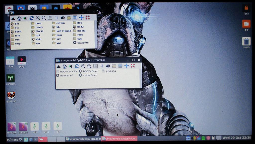

Posts: 10008
Posted: 07:42am 19 Oct 2021
OK, this laptop now boots Linux Mint on the internal EMMC drive.
I used my old faithful Puppy USB to mount the hidden partitions, and created a new folder: EFI\Linux
Copied all the files from "ubuntu" to the Linux folder.
Renamed the GRUBX64.EFI file to BOOTX64.EFI
Rebooted the machine, and away Mint goes.
In the BIOS, the boot-order now shows "Linux" as #1.
I have changed that so the machine still tries to boot the USB first, then "Linux" second.
Quite the saga, but a solution has been found, but I pity anyone else who does not really know that much about Linux - perhaps trying out a Linux Mint install - and gets THIS run-around.  They would be blaming Linux Mint when it failed to boot.....
