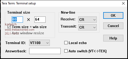

Command stacking
I like this feature a lot, but there seems to be some problem when the cursor is moved and the command is edited. If one goes back with the cursor and deletes/inserts characters, they appear at the wrong position and what one sees in the line is not what is given to the interpreter when pressing Enter. Looks like a simple indexing offset.
Posts: 11742
Posted: 08:16am 31 Oct 2021
  Quote   like this feature a lot, but there seems to be some problem when the cursor is moved and the command is edited. If one goes back with the cursor and deletes/inserts characters, they appear at the wrong position and what one sees in the line is not what is given to the interpreter when pressing Enter. Looks like a simple indexing offset.
This happens if the window of the terminal emulator is less than 80 characters wide. Please ensure this is the case and try again
karlelch
Joined: 30/10/2014
Posts: 341
Posted: 10:36am 31 Oct 2021
Hmm not sure. I use TeraTerm, it is set to 64 lines w/ 80 characters.
In MMBasic, I used `option display 64, 80`.
Here is an example of what mean:
> print 1,2,3
1       2       3
Now I retrieve the previous line with the up key and press backspace; this is how it looks then:
>print 1,2, 3
1       2
Next, I again get the previous line back and type 444, and here is the result:
> print 1,2444
1       2       444
Still, it is possible then I have some TeraTerm setting wrong.
Posts: 11742
Posted: 10:49am 31 Oct 2021
I can't replicate so I can only suspect something else in the teraterm setup.
You could try the attached to see if it makes any difference
PicoMite.zip
karlelch
Joined: 30/10/2014
Posts: 341
Posted: 11:02am 31 Oct 2021
Yes, now it works as expected! Thanks.
Previously, I had tried the latest release and the latest beta from  Geoff's website.
Ohhh! Wondered about it myself. Checked and my Term was 80x40. Did not work. Now using 81x40 and it works :)
