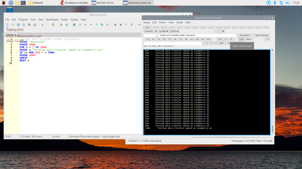

MMEdit V5 is getting close.
This is the Raspberry Pi version. Almost working.
There is a lot to do around serial port names etc.
I will have a 64 bit Linux (Ubuntu) version and Windows 32 and 64 bit.
It is still in beta but you can have a play.
https://www.c-com.com.au/stuff/MMedit5_portable.zip
Windows 64 bit only for now.
I have divided the program into 2 parts.
The editor should be familiar.
The "Maximite Control Centre" does all the connecting to serial and TCPIP

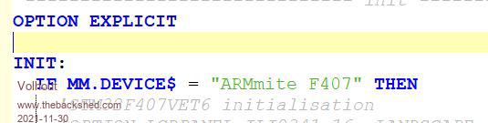

I checked the WIN64 version on my work laptop (W10). There where some security messages (needed to give permission to open some files) which was not needed on earlier (portable) versions. But our work machines are heavily protected....
Looked at the editor only first instance (don't have any mites at my work).
1/ The editor adds 3 lines at top of the file:
'MMEDIT!!! Basic Version = Micromite_5.05.01
'MMEDIT!!! Port = COM13:38400:10,300
'MMEDIT!!! Device = Micromite_5.05.01
Do these lines get copied over to the picomite ? The flash system in the picomite shows the top line of the basic program in each slot in flash with "FLASH LIST". Then all programs are called 'MMEDIT!!! Basic Version = Micromite_5.05.01.
2/ A labels called "INIT:" is seen as a token (command/function) where this function correctly in the MMBasic on the MMites involved.
3/ Nice to have: it would be nice if functions/subs names could also get a color. But that would mean you have to scan the file (and includes) and create a list of named subs/functions.

Thanks for the report.
The lines you are seeing at the start of the program are left over from the earlier version of MMEdit where the com port etc were saved with the code.
You can ignore them or delete once you have changed over to V5
There are some places where they get removed but not always.
I will remove INIT from the keyword list.
Keeping track of user subs would be nice but I will wait and see if the speed sacrifice is worth it.

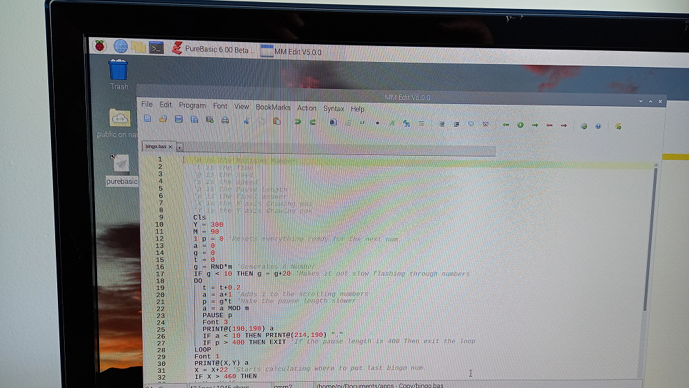

Posts: 6638
Posted: 06:56am 08 Dec 2021
MMEdit working on my RPi.
Still a lot of work to do but I am pleased to have got this far
The ZIP contains a .gz file with the required files.
Extract it to any convenient location and play.
It works on the latest Raspberry OS. Not sure if you will need any dependencies or if it works on older versions of the OS.
RPI.zip
(I had to ZIP it to upload here)
The first line of the BAS file is
'target port\ttyACM0:115200 s\picomite
Load a file,
put an appropriate 'target line in and
click on the lightning bolt icon (far right of toolbar)
It should open the MMCC and connect and load the BAS file.
An alternative method is to open MMCC and configure a port.
Connect to the 'mite,
in MMEdit or any other editor,
'select all' and drag it onto the terminal window of MMCC.
The Ubuntu version will be a day or two...
Along with some operating instructions.
