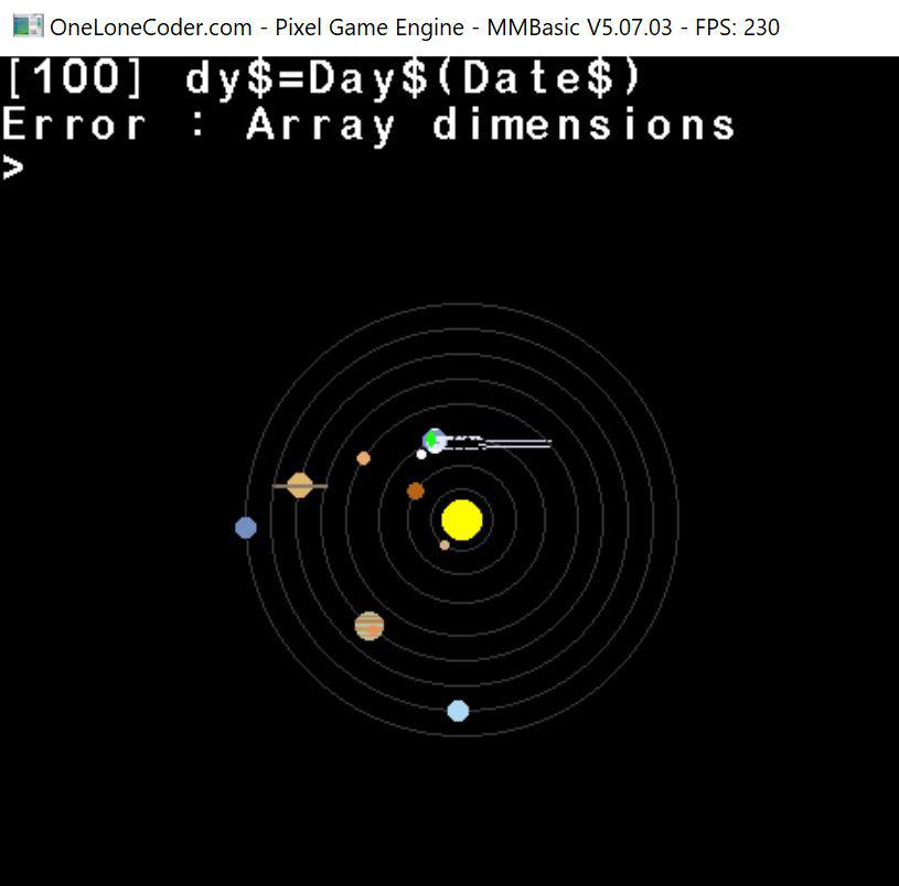

I did try the solarsys.bas file but it;s written for a display so all I could do was list it to prove load, list and run works
Edit: after modifing the program I managed to get it as far as here
I'm sure people with real knowledge of MMBASIC can get it running perfectly

  Quote  I'm sure people with real knowledge of MMBASIC can get it running perfectly
day$() and date$ not implemented yet so not your fault

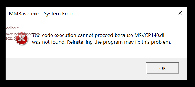

Hi Peter,
Not being a windows guy, I will see if I can solve it.
EDIT: from a Youtube video, I installed C++ 2015 and that solved it.

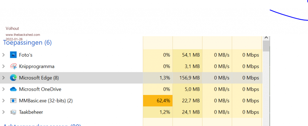

MMBasic is quite power hungry. Just am empty screen, not even in edit mode.

  Quote  Not being a windows guy, I will see if I can solve it.
Would normally be there if anything C++ has ever been used. Install from link should fix it
https://www.microsoft.com/en-us/download/details.aspx?id=53840

Is there any way to bring back the CPU load ? My laptop fan is screaming, and the CPU is 60%....90% busy while MMBasic is idle (edit screen, doing nothing) (4 core i5).
Edited 2022-01-26 05:27 by Volhout
Posts: 11816
Posted: 07:28pm 25 Jan 2022
  Quote  Is there any way to bring back the CPU load ?
Yes but that's for a later day - it's a pre-salpha. At the moment three threads are running each in a tight loop + a 4th thread executing every millisecond
