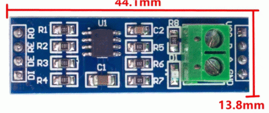

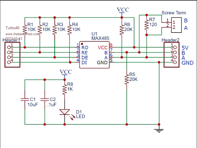

I have a Renogy Rover Elite solar charge controller which has an RJ45 jack labelled RS485. I've found a github site where someone has accessed the device with python: https://github.com/CyberRad/CoopSolar. That site also has a pdf for the device: https://github.com/CyberRad/CoopSolar/blob/master/ROVER_MODBUS.pdf. Good info.

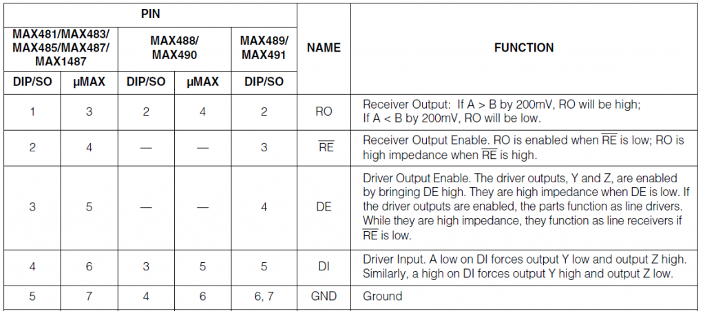

I have an RS485 module from aliexpress, https://www.aliexpress.com/item/1005003204223371.html, but I don't understand how it is supposed to be connected. The screw terminals are connected to A and B, but at the other end of the device, what are DI, DE, RE, and RO?
I was looking for an RS485 to serial module, but perhaps this isn't one.

The MAX485 data sheet gives you a clue.

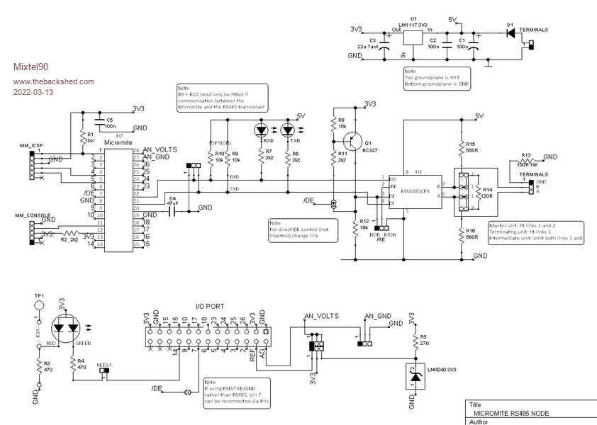

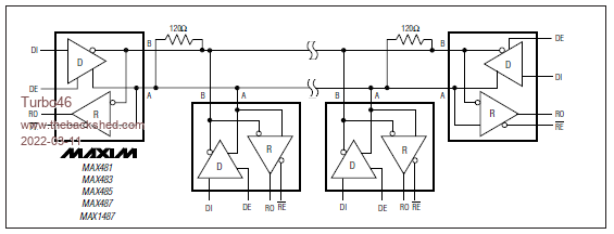

Yes. You have the right module see Mick's circuit .
Note that DE and RE are normally connected together. Also that the DE provided by the Micromite (170) are inverted if you are using that but it's easy enough to roll your own DE signal. You will find MODBUS CRC routines on Fruit of the Shed.
This circuit from the Maxim datasheet shows how to interconnect them. Note that the resistors from Mick's circuit are already fitted to your module.

Bill--I already have RS485 coming out of the Renorgy device, so I don't need two modules which talk to each other. But thanks for explaining how the signals go.

Just be careful with those modules, lizby. I see that they don't include a ground connection between the RS485 devices. They'll usually work with a 2-wire connection, but not reliably over any distance. You may have to add a ground connection somehow.

Thanks for that, Mick. I wondered if the third large pad on the end might be ground--I'll check it. Distance will be very short--inches.

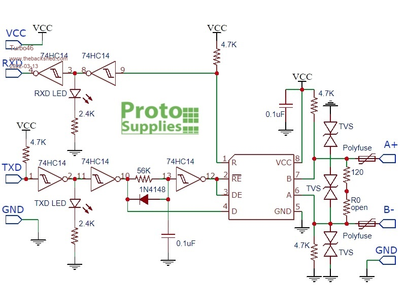

For what it's worth, I believe this is the circuit diagram of that RS485 module. The four pins on the outside of the A and B screw terminals are the 5v, B, A and GND pins.
I have used the MAX485 at 3.3v so that should be OK for short distances at least.

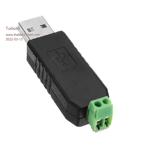

You may find one of these USB to RS485 converters useful if you are doing any development on a PC.
Automatic flow control, no ground connection but works well with an un-grounded device. Available at various places, there are other types with GND connection and more too.

@ Jim - the module you linked to with the automatic handshaking, do you know what the third connection is on the 485 side?  We have A+ and B-, and a third terminal with Chinese symbols. Is that ground perhaps?  Just curious.
I will get a few of these to play with, as they are so cheap.  Also, that listing says up to 128 devices on the one bus, but the RS485 standard says the maximum is "At least 32 unit loads", which is kinda vague...  For what I am planning, I would need MORE then 30 nodes if possible.  Around 50-ish would be perfect.  Each node would be about 5-10 meters apart, but all daisy-chained back to the master controller.
Is a module like that one full-duplex, or half-duplex?
The fact it has TXD and RXD lines and LED's, kinda suggests that you can both transmit from the controller to the nodes, and the nodes can transmit back to the controller on the same two-wire bus.  Do I have that correct or totally wrong?  Perhaps I need four-wires and two modules - one is a transmit bus, the other is a receive bus?

Strictly half duplex Master and Slave communicate over the one pair of wires. The slave does not initiate communication - only the master the slave only answers when spoken to (like a good child - yeah right).
The auto direction control in those devices is normally controlled by an RC network on the Tx line switching a Schmitt trigger. There is some delay in switching the direction at the start of the signal (message) and even more delay switching it off. So it is not really suitable for high speed communications and rapid responses.
I have not done the maths but I would expect that 30 devices on one line would be a few too many. You could use several of the modules in parallel and split your slaves into several separate groups though.
I can't find the circuit right now but if you want it I'll try later. I have a feeling that Mick (Mixtel90) may have had the circuit incorporated on one of his early boards.
Bill
Edit: Here 'tis

Posts: 9108
Posted: 08:54am 13 Mar 2022
This is what I came up with eventually:
It looks intimidating, but I included inverted and non-inverting options for /EN and most possibilities of termination. :)
