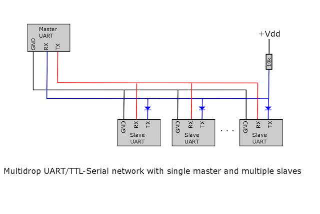

The RS485 thread just reminded to ask if anyone has tried this (short-range) method:
Craig
Posts: 9029
Posted: 11:03am 12 Mar 2022
Hmmm... I2C with more complication.  ;)
No, not tried it. It's something I've considered many times in the past though. I seem to remember someone trying something like this many moons ago, using Nascom computers at the user group, but whether they got it to work I don't know. Can't see any obvious reason why it shouldn't.

CaptainBoing
Joined: 07/09/2016
Posts: 2171
Posted: 11:27am 12 Mar 2022
electrically it looks good to me, if it wasn't so cold, I'd nip out to the shed and set up a few MM170s to play.
Depending on the expected baudrate, the pull up might need to be something more aggressive like 4K7 or even 3K0 to get reasonable rise times from the slaves.

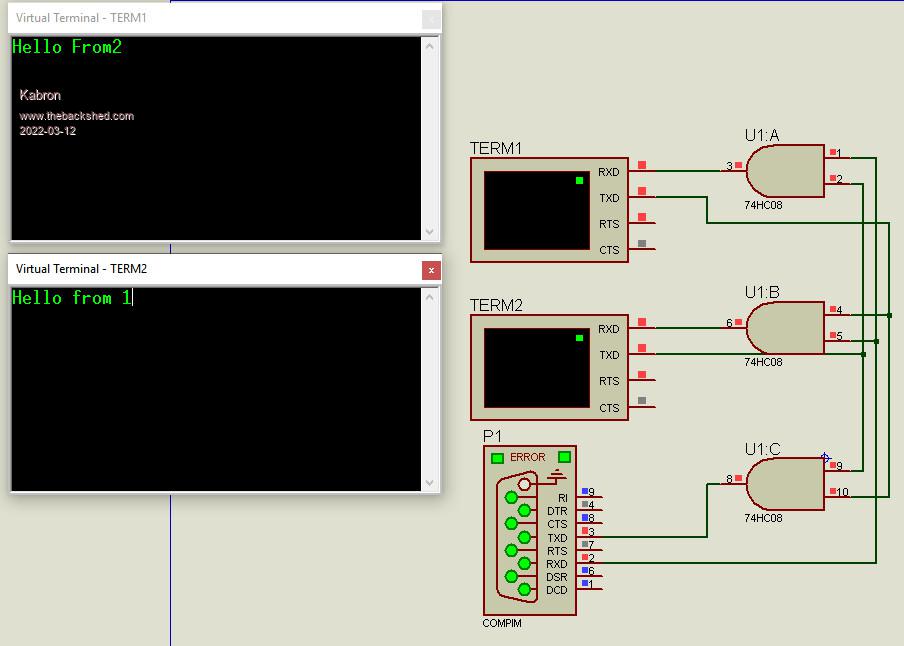

For high speed communications it also could be done with AND-gates.

@Mixtel90
I confess to not having studied the I2C approach. Is it possible to broadcast to multiple slaves or do they need to be individually addressed?

Kabron
Joined: 30/11/2017
Posts: 65
Posted: 01:56pm 12 Mar 2022
  Tinine said
  Kabron said  For high speed communications it also could be done with AND-gates.
What would be considered high speed?
How would the AND gate solution be configured?
@Mixtel90
Craig
1. Does not matter from logic, depends only from transmitter-receiver capabilities.
2. See attach.

CaptainBoing
Joined: 07/09/2016
Posts: 2171
Posted: 02:18pm 12 Mar 2022
The design above for AND gating; I have taken to using this range of chips recently, single gate SOT devices. would be perfcet for each module and not wasteful of gates.

Posts: 9029
Posted: 03:09pm 12 Mar 2022
@Tinine
I'm afraid I don't know much about I2c (yet). :) I know you can have multiple devices on individual addresses. I suppose you could have multiple devices *listening* on the same address, but not transmitting on it as that can mean taking bus control.
If you want distance, though, RS485/RS422 is definitely the way to go. If you want local (i.e. on a single pcb) comms at high speed then serial SPI is probably the best.
That AND gate approach would soon run into trouble with 20 devices. U1C would need 20 inputs. That's a horrendous amount of gating. :)  In theory the wired OR gate that Tinine posted originally can have any number of devices. It might be better to use an active current source instead of a pull-up resistor though.

@Mixtel90
Yeah I actually run a 4-wire, full duplex (485/422) network for my distributed stuff but what I am looking at right now is 4-Picos as smart I/O expanders but these slaves will be in very close proximity to the master. Seems a bit ridiculous to use differential transceivers. I already have the protocol developed so no need to futz with I2C.
Although my protocol is strictly command response, I like the full duplex approach because the master always has control of the TX and the RX is a shared response line. Should a slave get its knickers in a twist, the master is still able to talk to the other slaves, maybe to shut them down in an orderly fashion or whatever.
Turbo46
Joined: 24/12/2017
Posts: 1694
Posted: 07:17pm 12 Mar 2022
It would be nice if the Tx pin could be set to OC and the Rx pins set to Pullup. The scheme would then work without any additional components. The manual doesn't mention those options for serial communications though.

Posts: 9029
Posted: 08:26pm 12 Mar 2022
... and you'd be back to wired OR. :)
I can't understand why the AND gates would be considered better than the wired OR system. That only needs a single resistor (although I'd prefer a CC source) for the network and a diode per node. It's cheaper and simpler than any AND gate you can get. Cable capacitance is non-existent on short runs so the OR system won't be that slow. All the AND gates are doing is interlocking the TX/RX (unsuccessfully because it's on a bit by bit basis, not byte by byte) - and that's better done in software, controlled by the master.
For a network of n nodes every AND gate needs n inputs. It very quickly gets out of hand. Fine for just a couple of nodes, but the wiring alone (a bus of n+1 wires) makes it unsuitable for any distance.

Turbo46
Joined: 24/12/2017
Posts: 1694
Posted: 09:29pm 12 Mar 2022
  Quote  I got the impression from an earlier comment that a diode might limit the bandwidth. Dunno.
The diode/resistor is not an active pullup so rise time may be longer. That's why CaptainBoing suggested maybe using a lower value pullup resistor I believe.
Mick's constant current source would sort of be an active pullup.
