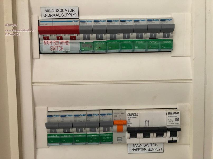

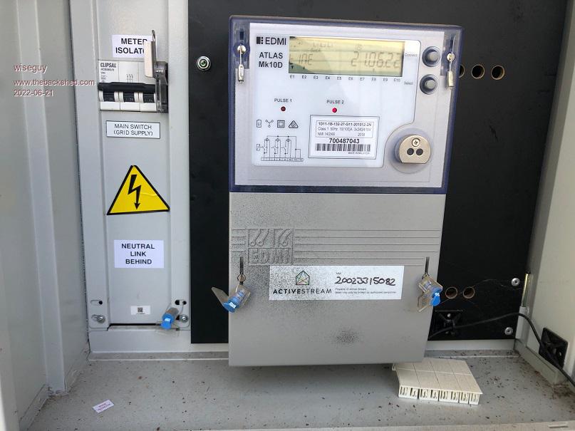

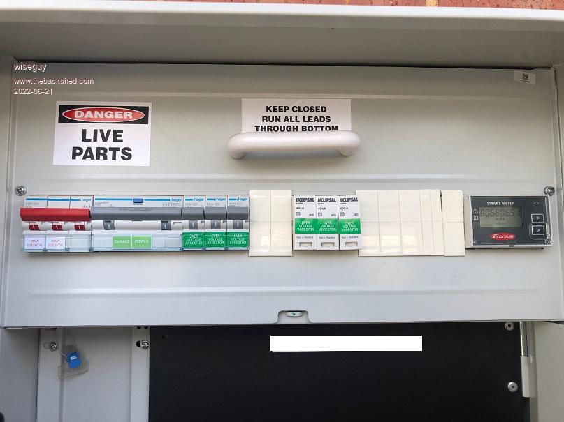

Posted: 09:00am 21 Jun 2022
Thanks for the description of your setup Peter. I guess it shows that there are many different and sometimes conflicting requirements, to try to get a one size suits all answer is a big ask.
I went and had a look at the switchboards in my house to see where I might locate a contactor to at least isolate me from the mains if I give a whoa camel command. This of course also assumes that I have settled on what approach I take for my given situation - which I haven't yet.
I feel depressed each time I look at them and realise I have a lot of work in fron to of me trying to trace each circuit and what exactly they are all hooked up to.
Some pictures of my dilemma
I think the only place for the contactor is the middle picture the top one is a nightmare of wiring behind the front panel no room for anything else.
Cheers Mike
