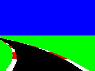

PicoMiteVGA MMBasic Version 5.07.05RC6
CPUSPEED 378000
Proof of concept..
parts of the concept are inspired by olc https://youtu.be/KkMZI5Jbf18
Dim Col%(15),Xofs%(160)
Restore colors:For f%=1 To 15:Read Col%(f%):Next f%
SH%=240:SW%=320
dist%=0:Speed%=15
Option Break 4: On Key 3, on_break
MODE 2
FRAMEBUFFER create
FRAMEBUFFER WRITE F
For f%=0 To 159:Xofs%(f%)=((160*Exp(f%/50))/20)-8:Next
CLS COL%(1)

 For n%=1 To 1000 Step Speed%
   Box 0,hh%,SW%,hh%,,COL%(2),COL%(2)
   For F%=0 To HH%
     bc%=get_BorderCol%()
     ofs%=xofs%(hh%-f%)*n%/400
     BB%=Int(f%/5)
     Box HW%-F%-bb%+ofs%,HH%+F%,bb%+bb%+f%+f%,1,,bc%,bc%
     Box HW%-F%+ofs%,HH%+F%,f%+f%,1,,0,0
   Next
   FRAMEBUFFER COPY F,N,b
   Inc dist%
 Next

feel free to use and improve it,
if someone likes to write a Racing game for the Pico

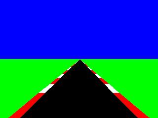

if you want to drive straight ahead just do a loop with ofs%=0
Mart!n

As this is just a proof of concept, I tested if it could be done that way.
In the next Step i try to optimise the code and add a track and a Car

Every single Frame is completly redrawn.
With the use of the Framebuffer I can redraws the screen hidden and make it Vissible when it is ready. This makes the screen animation flicker-free.
Here I paint the Lower half of the screen, green, then I draw Line by Line, the Border and the Street.
by giving up the get_BorderCol% Function call and replacing with
bc%=col%(7-3*((Sin((((150-f%)/40)^3)+dist%))>0))
this little demo gets up to 30 fps

The Spaces of the upper strips at the Border is less than the Lower ones,
for this:
Sin((((120-f%)/40)^3)+dist%)
f% is the y position of the Line and Dist% is just a Framecounter to simulate driving.
calculates a point in a Sinewave at which frequency increases starting with the Phase dist%
I use this to deside to use Color 7 (White) or Color 4 (Red) for the Border
bc%=col%(7-3*((Sin((((120-f%)/40)^3)+dist%))>0))
the color value is 7 but subtracts 3 if the Result of the Sine-Function is Positiv.
Look at the Listing in the first Post.
It is the Function get_BorderCol%() from the Listing above in a conpressed form.
Cause every function call takes some time and it is called 120 times per Frame, so I put it in one basic Line.
The Idea for this method is from javidx9 (one Lone Coder) who used the same calculation in his video.
Data RGB(BLUE),RGB(GREEN),RGB(CYAN),RGB(RED),RGB(MAGENTA),RGB(YELLOW),RGB(WHITE)
Data RGB(MYRTLE),RGB(COBALT),RGB(MIDGREEN),RGB(CERULEAN),RGB(RUST),RGB(FUCHSIA)
Data RGB(BROWN),RGB(LILAC)
Did not work, code ran-no display.

Martin H.
Joined: 04/06/2022
Posts: 1485
Posted: 07:28pm 12 Oct 2022
ähhhm .. no
we both use the RGB() function in both examples
using an Array or reading data are also no specific functions in the VGA Version of MM Basic/ Picomite..
but let it test ...
Here from my standard PicoMite (NonVGA)
using TeraTerm and serial connection
PicoMite MMBasic Version 5.07.03
Saved 212 bytes
> run
> for f%=0 to 15:print col%(f%);",";: next
0, 255, 65280, 65535, 16711680, 16711935, 16776960, 16777215, 16384, 16639, 32768, 33023, 16728064, 16728319, 16744448, 16744703,
> list
Dim Col%(15)
colors:
> option list
OPTION COLOURCODE ON
OPTION KEYBOARD GR
OPTION CPUSPEED (KHz) 252000
OPTION DISPLAY 40, 120
OPTION SDCARD GP22
so, I dont know what goes wrong on your system

Posts: 6546
Posted: 09:06pm 12 Oct 2022
Your version without framebuffer runs well on a LCD (ILI9341) at a framerate of 10.526
Looks smooth.
Because the LCD version doesn't use MODE, you just have to rem out the MODE 2 and MODE 1 lines. Because of that, you don't need the on_break sub
NO other changes needed.
For those who refuse to use the console/terminal change the PRINT (~ line 86) to
text 1,1, str$(1000/t%,3,3)
Edited 2022-10-13 07:22 by TassyJim
