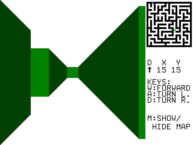

Really impressive! Tested this a few minutes ago. Every time inspiring what can be done with BASIC on the pico! :)

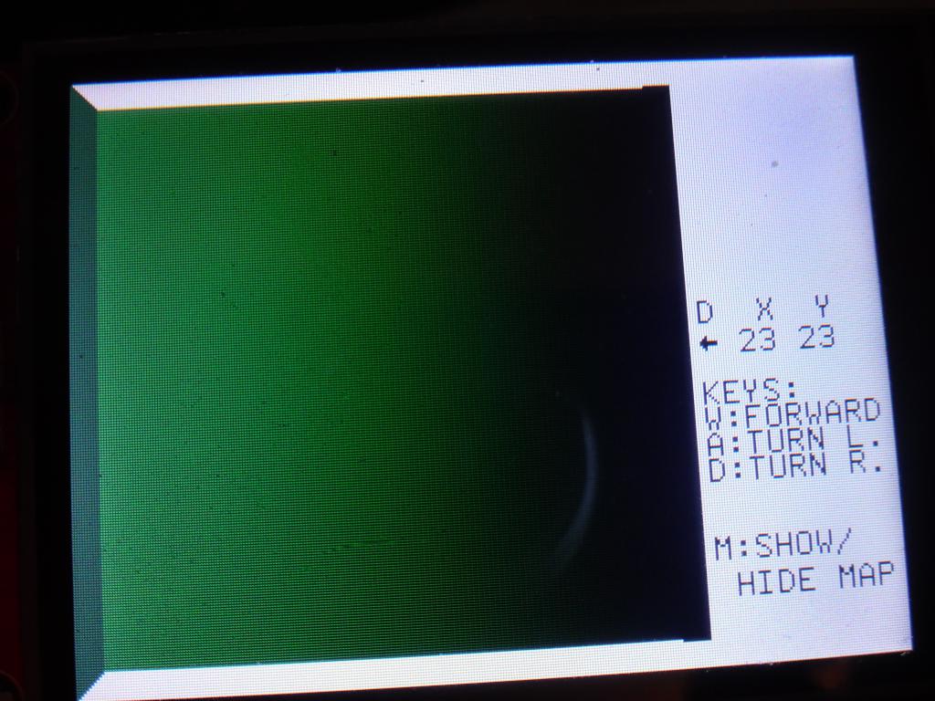

I tested it also on an ILI9341 LCD.
The only drawback is that the image of the labyrinth is a little to  small for my old eyes on the 2.8 inch display
this makes it hard to see the little green dot.
Since the walls on the sides are trapezoidal,
I can't use the box function
(x1,Y1) ......
       |          ....(X3,Y3)
       |          ....(X4,Y4)
(X2,Y2) ......
I draw one triagngle connecting the Corners 1->3->4->1
                   and the second triangle 1->2->4->1
As
I used the same for the Gaps and the Wall in Front
because the parameters of the BOX command are different (X,Y,W,H).
I didn't feel like converting the coordinates again  and the
triagngle command is fast enough.

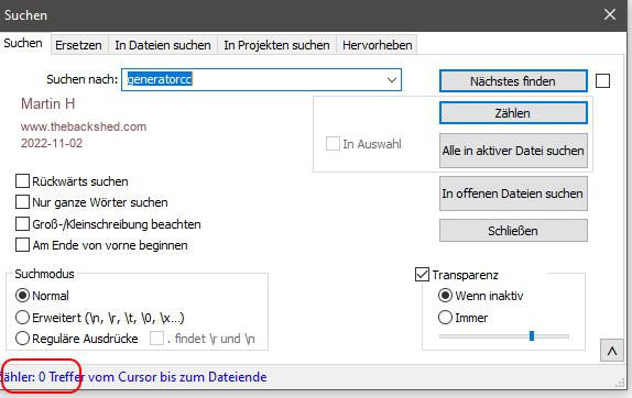

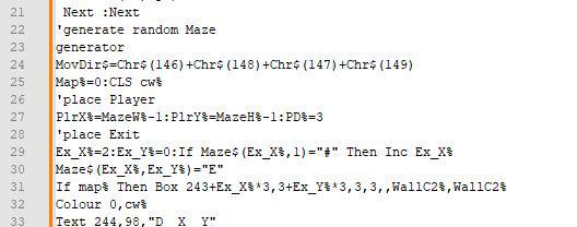

  stanleyella said  I get
RUN
[26] generatorcc
Error : Unknown command
there is no generatorcc in the Code abov.
Maybee you had some errors while Copy&Paste it or something you 've changed?
Line 23 (Not 26) calls the Sub, named generator
but no"cc" in there..
so, I have no idea what went wrong
Edited 2022-11-02 04:47 by Martin H.

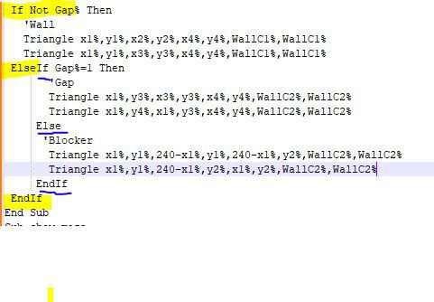

I did find an extra Endif in the Draw_Element sub. Not causing a problem because it is at the end of the sub.

  TassyJim said  For the little LCD, I find that "pink" is a better colour for the position marker. Still not easy to see.
I also added the direction arrows to the movement keys. It's more what I am used to.
Case "A",chr$(130)
 Inc PD%,-1:Inc PD%,4*(PD%=-1)
Case "D",chr$(131)
 Inc PD%:PD%=PD% And 3
Case "W",chr$(128)
Hi Jim,
Good extension to add the Cursor Keys, I will add that
the first Endif  belongs to the Else if statement,
The second belongs to the enclosing IF query
but there is no particular reason why I solved it that way.
You can also solve it with individual IF querys or use Select case.
Mart!n
Edited 2022-11-02 15:46 by Martin H.
'no comment
Posts: 4396
Posted: 07:43am 02 Nov 2022
  Martin H. said  the first Endif  belongs to the Else if statement,
It looks like the code has
ElseIf
where it should be
Else If
Or, drop an EndIf
Martin H.
Joined: 04/06/2022
Posts: 1579
Posted: 07:54am 02 Nov 2022
  Mixtel90 said  Sheesh - I've just thrown out my copy of GFA BASIC for the ST. I had to get rid of a load of stuff quickly so there's a load of ST software (and some ball-type mice) at the bottom of a skip.
When I moved from ST to PC, my Wife and I had most of the Programs and Files still just for ST,but the space on the desk was too small for 2 computers.
So I had to copy the Atari ST HardDisk to the PC and used an Emulator to be able to continue use the programs. And when I built a new PC, the personal files were always copied to the new PC. It is thanks to this fortunate circumstance that I still have access to my old files.
Edited 2022-11-02 17:58 by Martin H.
'no comment
Posts: 9329
Posted: 08:11am 02 Nov 2022
I no longer had my STFM and STe - they were lost due to smoke damage in a fire some years ago (they never came back from the cleaning company, along with quite a bit of other stuff). Consequently I couldn't use the software - I was just hanging onto it. I considered putting what was saleable on ebay but probably wouldn't have got much for it so not worth the hassle. I still have a couple of external floppy drives as I thought the cases might come in useful.
Posts: 6638
Posted: 08:50am 02 Nov 2022
ElseIf
where it should be
Else If
ELSE IF and ELSEIF are interchangeable in MMBasic
you would need separate lines:
ELSE
IF
for Martins extra ENDIF to be functional.
