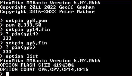

Posts: 3455
Posted: 07:19am 22 Dec 2022
If FIN is working I must be doing something wrong.
Measured 333 Hz on gp14 and gp6.
> option list
PicoMiteVGA MMBasic Version 5.07.06b6
OPTION SYSTEM I2C GP4,GP5
OPTION COLOURCODE ON
OPTION KEYBOARD US
OPTION SDCARD GP13, GP10, GP11, GP12
OPTION RTC AUTO ENABLE
OPTION COUNT GP6,GP7,GP14,GP15
>setpin gp0, pwm
> setpin gp14,fin
> pwm 0,333,50
> do :pause 1000 :? pin(gp14):loop
0
0
0
0
0
0
0
0
> setpin gp6,fin
> do :pause 1000 :? pin(gp6):loop
0
0
0
0
0
0
Posts: 12257
Posted: 07:54am 22 Dec 2022
Are you connecting the correct pins?
Edited 2022-12-22 17:59 by matherp
Posts: 6278
Posted: 09:11am 22 Dec 2022
@Peter,
On the standard picomite it works. I can cionfirm.
Phil is running the VGA version, not using the default configuration
Default: gp6,gp7=audio, gp14,gp15=I2C
Phils board: gp6,gp7,gp14,gp15 = COUNT
Maybe there is something not going well becuase this different pin assignment.
I have used Phils OPTION LIST (no RTC AUTO, since I have no RTC) on a bare picomite prograqmmed with the VGA firmware, and see the same.
Edited 2022-12-22 19:13 by Volhout
Posts: 12257
Posted: 10:12am 22 Dec 2022
OK found the cause. It happened between 5.07.05RC6 and RC7 and is to do with a change I made to the keyboard handling. The problem only arises when OPTION KEYBOARD is set (default on the VGA version) hence seeing it on the VGA version. Can replicate on the ordinary version by setting OPTION KEYBOARD UK
Now just need to fix
UPDATE: I've replaced the firmware in the latest download, please re-download and test
Edited 2022-12-22 20:45 by matherp
Posts: 3455
Posted: 11:04am 22 Dec 2022
Thank you for the updated version. Perfect.
